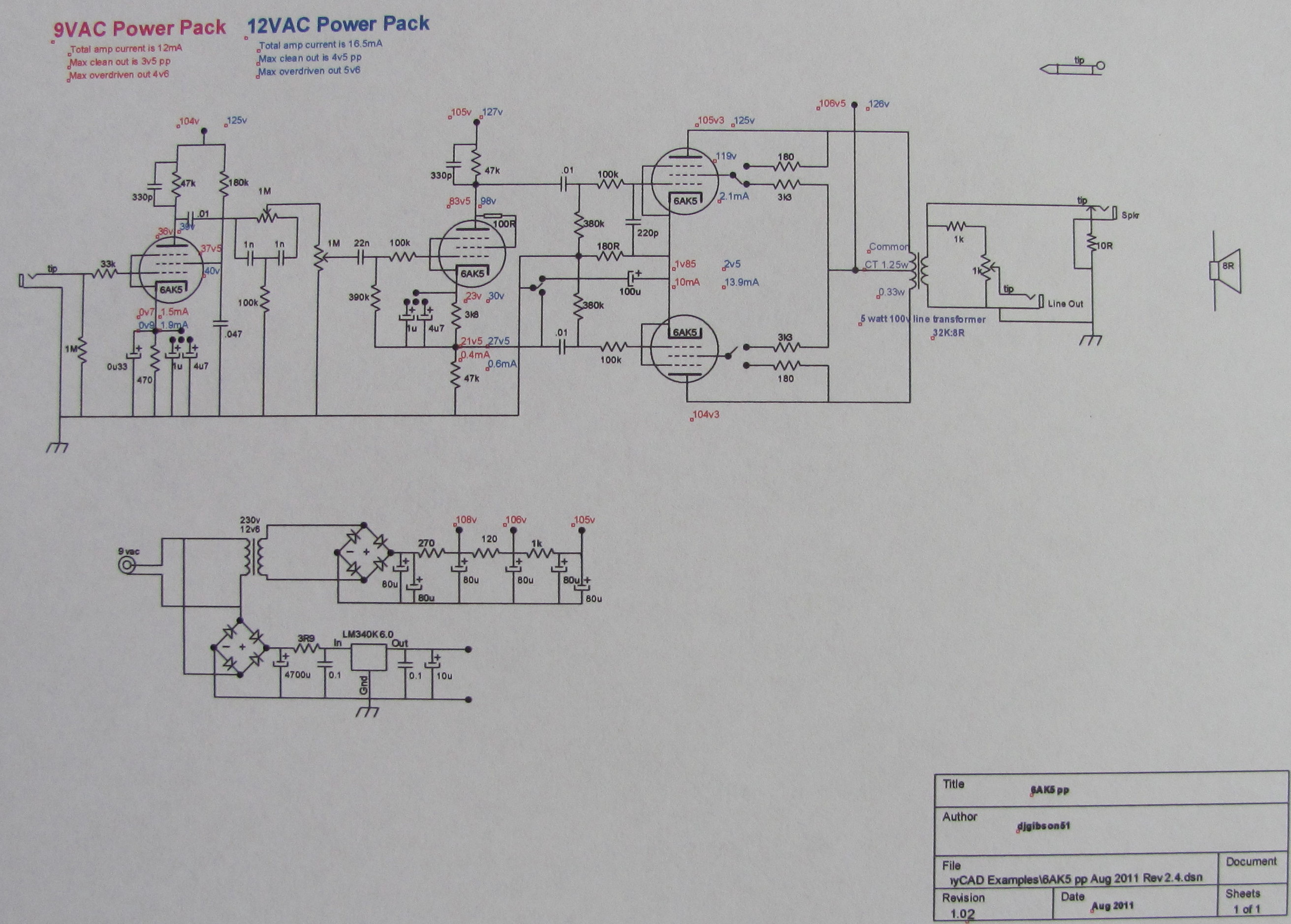

6AK5 push pull triode pentode cathodyne self split
Schematic attached
Self split mode is the lead sound I've been looking for.
Triode mode gives apartment level volume (97dB 12" driver).
.33u cathode bypass on 1st stage give chime to clean rhythm.
I want one.
Ps. Not happy with mid scoop after 1st stage. Needs tweaking.😕

djgibson51 -- sorry; I didn't mean to disrupt your train of posts. I was composing and just hit 'enter', instead of looking where my post would land.
Very nice amplifier! I wish I was in the final tweaking stage instead of still in the head-scratching stage.

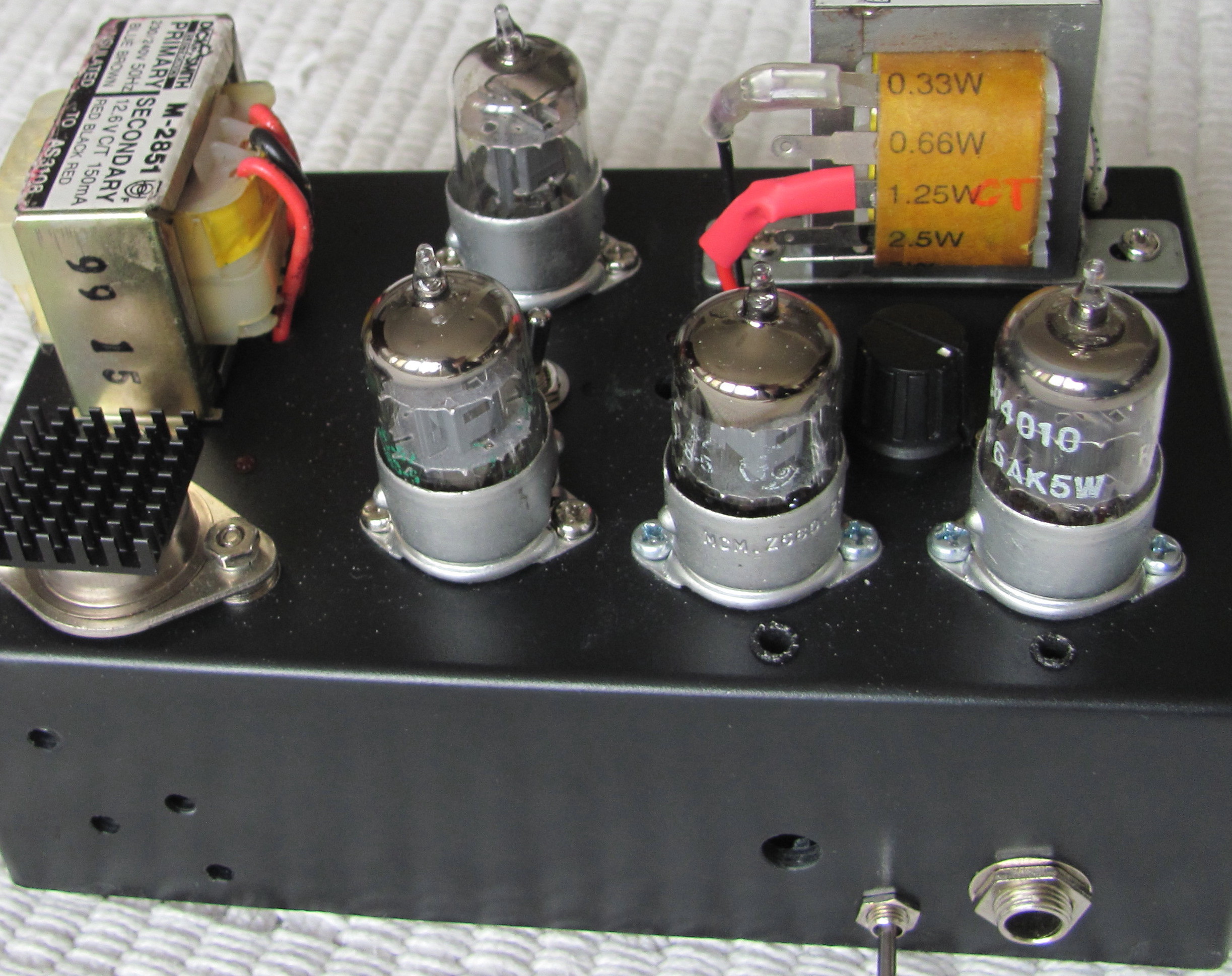

Damn. Nice weekend to work on an amp and I end up getting run off the road by a car (me on my bike) and a good care of road rash.
Amp design is evolving. It was to be a simple self-split P-P amp. Then I saw some possibilities and figured out with a simple switch I could convert it into a self-split or a cathodyne PI. Another switch to go from Fender cleans to Marshall like crunch (well that is the theory). Might take things over the $100 but not much. Start building a temporary chassis, realize it is not going to be so temporary, decide that since I am going to keep it around maybe add another feature.
See more possibilities that have been mentioned in theory, work out my own arrangement, throw in a few more parts (and bucks), It is ending up not looking like the original idea but interesting enough just to do it to try it. Wish I had time to do both but that will not happen.
On the plus side, the box guitar sounds great, had about half a dozen players try it at work and heard what it can do. Still needs a couple more hours to finish it but close enough to get back to the amp.

Prototype
I hope those exposed primary taps on the output transformer are going to be shrouded.

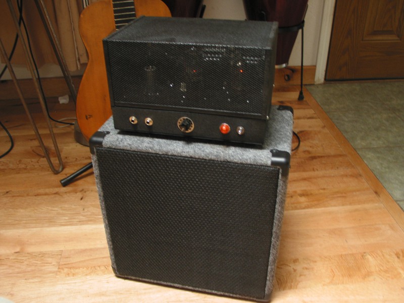

Well not sure if this will be the final product, been through so many revisions already. Don't know if it would be a first time builder's amp but other than a few more parts from the amp I was planing on a couple of days ago,( ffive resistors, two switches, one MOSFET, and one capacitor).
Added a switch and resistors to reduce the supply voltage to the 12AU6 so it can run clean or dirty, might have it change the cathode resistor also but I'll see if it is necessary. Had the tone stack bypass already to go from Blackface to Tweed type tones, cut a hole out of the chassis to switch the voltage in half rather than using the voltage doubler but I probably would not have bothered with it if I did not have the hole.
Then there is the switch for the negative feedback, cathode bypass cap switch to increase the value for more of a fixed bias feel, but the real unknown is the four pole three position switch. It converts the amp PI from LTP (top and left position) to Cathodyne (center position) to paraphrase. I think I got it right, we'll see if I can get this thing to sing or if it will squeal for me.
