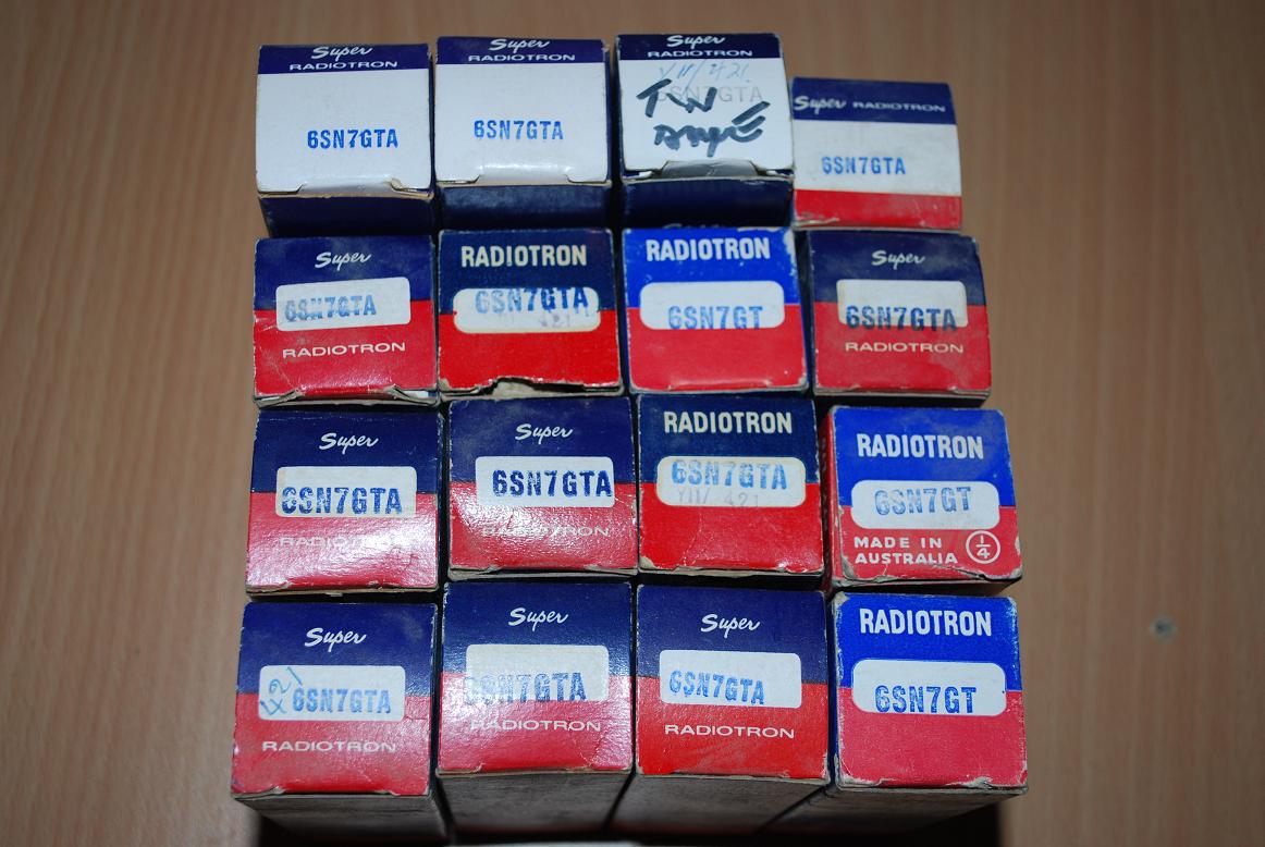

I use a lot of 6SN7GTA's, I was lucky enough to buy 100 of them for $2.00 each a long time ago & am slowly but surely running out of stock, what I have left is pictured below.
I have been playing around with a SE 6SN7GTA for the challenge actually.
I find trying to build a nice very small amp a real challenge when you only have the $100 to spend.
