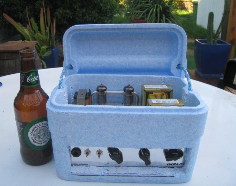

Ice chest speakers?

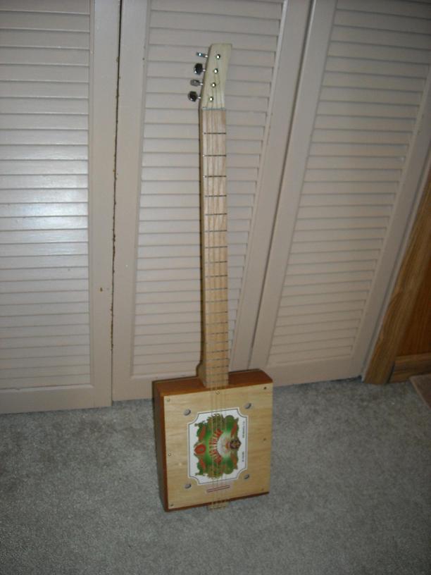

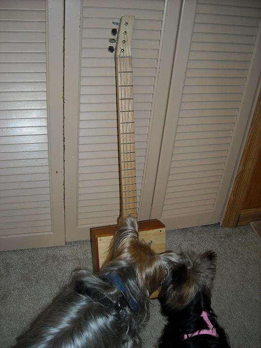

Two years ago I built a 4 string version that I tune Drop-D. (Man, how time flies)
I used a Radio Shack Piezo as a pickup and mounted it with RTV under the bridge on the neck that ran the length of the guitar. I think the transducer was 273-0073.
The dogs like it
But I still can't play it.
The dogs like it

Ice chest speakers?

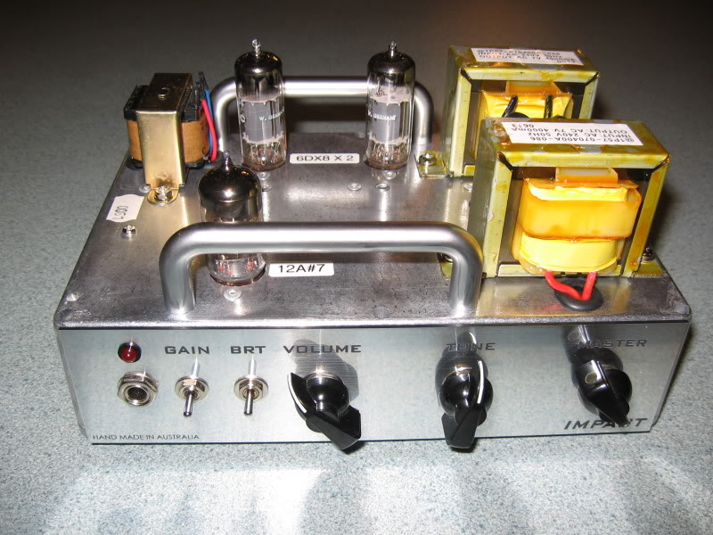

Gday Guy's,
I have been playing around with a second small amp & have uploaded a quick soundclip of it, it's showing some promise at this stage.
This one is just under $100 as well
I found the mic lead I was using to be the trouble I had recording things, cheap Chinese lead, say no more.
Anyway here's the Link to the clip.
Amp2 Test1.wmv - YouTube

I just noticed the smilie faces on the tubes ;}
Sounding nice, although I'm getting almost all the volume in my left headphone, and an annoying thumping/scratching sound in the right headphone that is in sync with the guitar. Might be the cheap sony headphones here at work.
