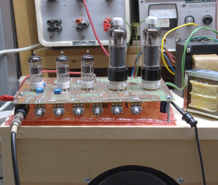

Here's my contribution to this effort. I finished wiring last night, hopefully I can get to a smoke test tonight. My philosophy is much like George's: no highly exotic parts and minimize the number of suppliers (to reduce shipping costs). So far it will end up between $90 and $100.

I have to say that I think your layout is most probably responsible and the cause of your hum issue.
That was pretty much my conclusion, along with the extreme high gain possible with the amp.
Based on the video clip, it would seem that the sections are intermingled rather than are in separate logical sections. You may not have any hum issues at all if you were to separate the sections on your board, like PSU, Power amp, PI, 3rd, 2nd, 1st preamp.
...snip...
I tried to separate them as best I could,and used coax between sections. The breadboard does not lend itself to segmentation unless I rework the Power Supply.
This is the first time I've built this size amp and I'm still learning the nuances of the system.

As far as layout is concerned, there is only one way to learn what works and doesn't, trial and error. If you work on and/or build enough amps, sooner or later you start to have a feel for what works and what gives you nothing but problems. I have seen several amps made by major and I mean very well known and respected companies who built amps with less than satisfactory layouts and sold them for a lot of money to clients. One could argue what is and what is not good layout for an amp, but when there are several ground connections (creating many ground loops) one can no longer say it is a good layout! So, next time you open up the hood of a well known brand amp, just look for the number of areas ground connections are made! In most you will find several! The really good layouts have only ONE ground connection!
As you said, you have not done many amps like this before, it is perfectly normal to have some teasing issues. The main issue is good sound and your amp has good clean sound. It is a good starting point for your new layout as you will end up with less hum and just the crunch sound needs addressing. Keep at it. You are heading in the right direction.

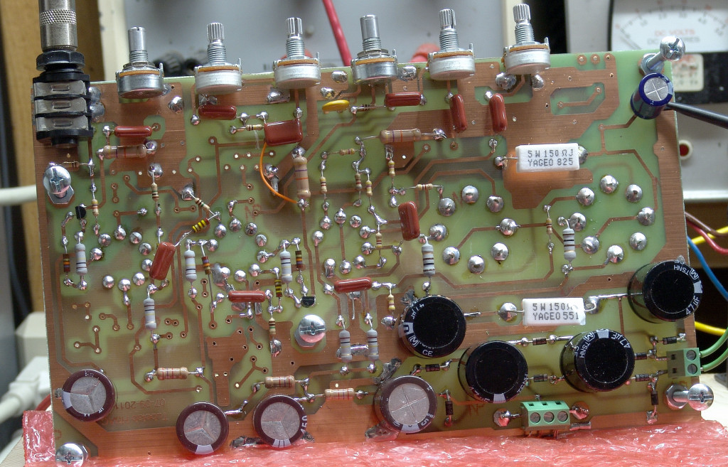

I tried to keep the main filter caps in a group with the coupling resistors with them. Then used their common ground as the common to all sections (pseudo star ground).
I went back last night and changed to twisted pairs wherever I could for power and ground to each section. This cut the noise in half.
If I have no scope probes attached I get 240mVrms noise on the output (Floating without secondary connected to ground) with the gain set to 1000. If I connect the a probe ground to any ground point in the amp, it decreases significantly (to 28mVrms). So I definitely have a ground problem on the bench.Note that a gain of 1000 will only require 4mVrms in to bring the output to the verge of clipping in a clean setting, so this is excessive gain and I can't see any reason to operated with this much gain.

Last night I did my best Muntz impersonation and I ripped out about 15 parts. I also rewired the amp to move the tone stack to be connected to the master volume pot between the 4th gain stage and the PI. I also increased the grid stoppers from 4.7K to 240K carbon comps, and the gate stoppers on the 2 remaining mosfets to 27K carbon comp. One of the plate load resistors broke in half as I moved it and it was in the stage that was oscillating so I replaced it.
I flipped the switch this morning and was rewarded with good sounds NO oscillation and minimal hum. Running the volume control to max (between the first and second gain stage) and setting the master at just a crack above off results in a super cranked overdriven sound. Turning the master up to loud allows massive feedback driven infinite sustain controllable by where you are standing relative to the little 8 inch speaker. Running the master up full and setting the volume with the other volume control gives a perfectly clean sound. The regions between the 2 extremes are now usable where it wasn't before.

The bubble wrap between the board and the speaker cabinet seems to cure the rattling death to the input tubes, but these tubes are from a different supplier and a different heater voltage. They were just as bad as the Mullards before I put the bubble wrap in. I can now crank away without feedback through the board or rude sounds from the speaker. The gain is high enough to get infinitely sustained notes with the volume and master on 5 and the guitar in front of the speaker.
Note all the empty holes in the board. Yes the Mad Man left a lot of parts out, and it still works good!
