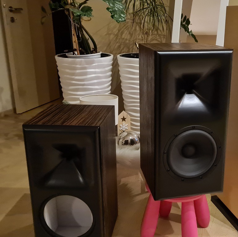

With current 3D printing, it is probably more effective to use honeycomb structure.Hi,
I was reading through the thread and also looked for the original patent to learn more details. I saw that the patent expired "fee-related" in 2018.
I'm not an expert on patents, but it reads to me that the solution is no longer covered by the patent.
US7708112B2 - Waveguide phase plug
- Google Patents
What do you think about it?
Best regards
KH

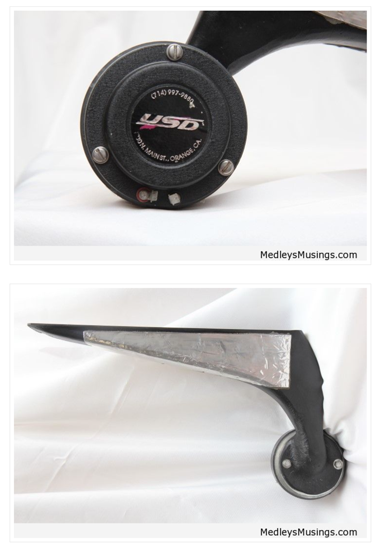

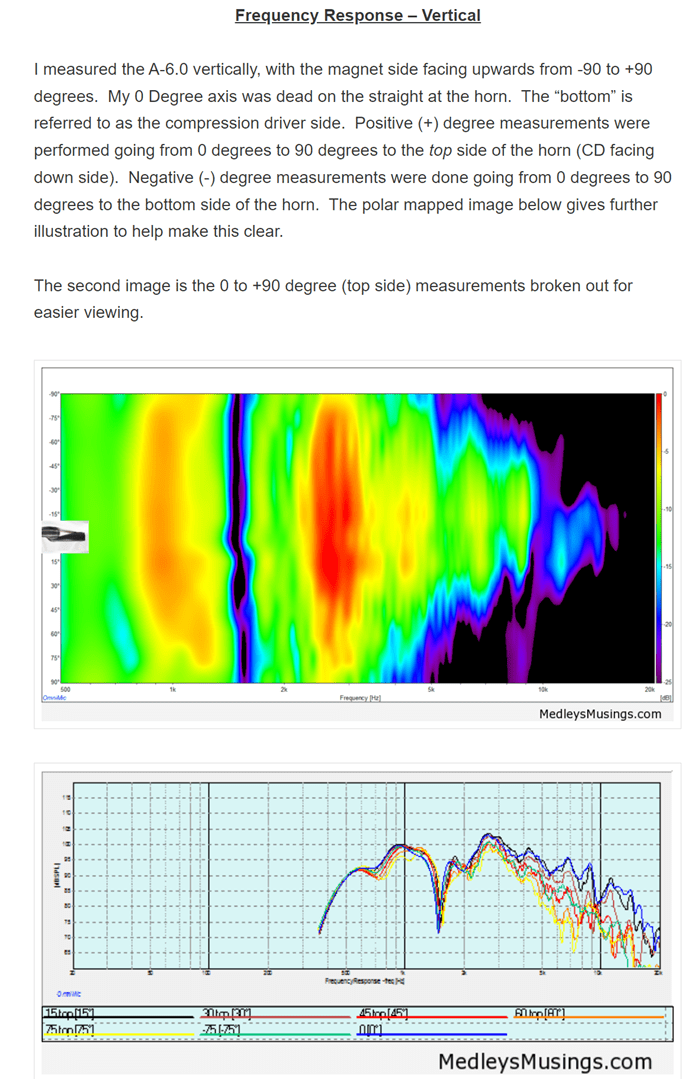

Here's some data to back up my claim:
1) There's some measurements that I personally made of commercially available car audio waveguides. You can see my data, from 2008, here: https://www.diyaudio.com/community/...learned-how-to-fix-a-horn.151376/post-1919727

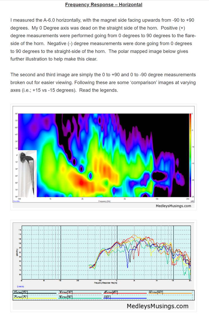

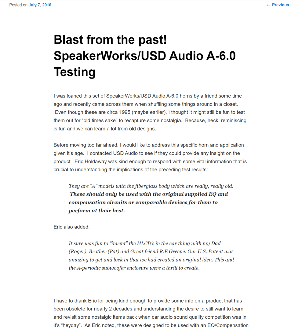

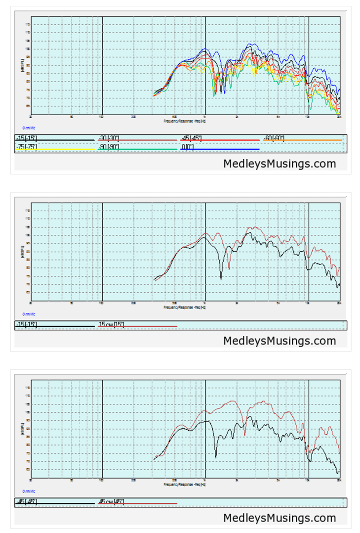

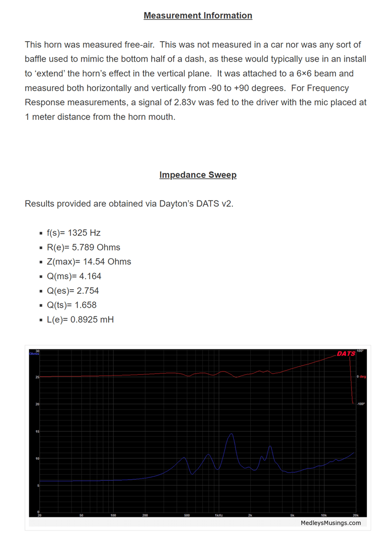

2) Erin from Erin's Audio corner did a much more exhaustive set of measurements. His old website is DOA, but I pulled the data from the wayback machine. I've attached his data.

2022-05-04 13_51_24-Blast from the past! SpeakerWorks_USD Audio A-6.0 Testing _ Medley's Musings.png731 KB · Views: 106
2022-05-04 13_51_49-Blast from the past! SpeakerWorks_USD Audio A-6.0 Testing _ Medley's Musings.png207 KB · Views: 98
2022-05-04 13_52_16-Blast from the past! SpeakerWorks_USD Audio A-6.0 Testing _ Medley's Musings.png59.3 KB · Views: 101
2022-05-04 13_53_32-Blast from the past! SpeakerWorks_USD Audio A-6.0 Testing _ Medley's Musings.png131.8 KB · Views: 461
2022-05-04 13_54_48-Blast from the past! SpeakerWorks_USD Audio A-6.0 Testing _ Medley's Musings.png121.8 KB · Views: 427

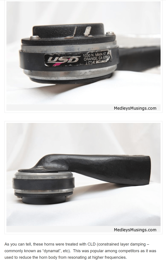

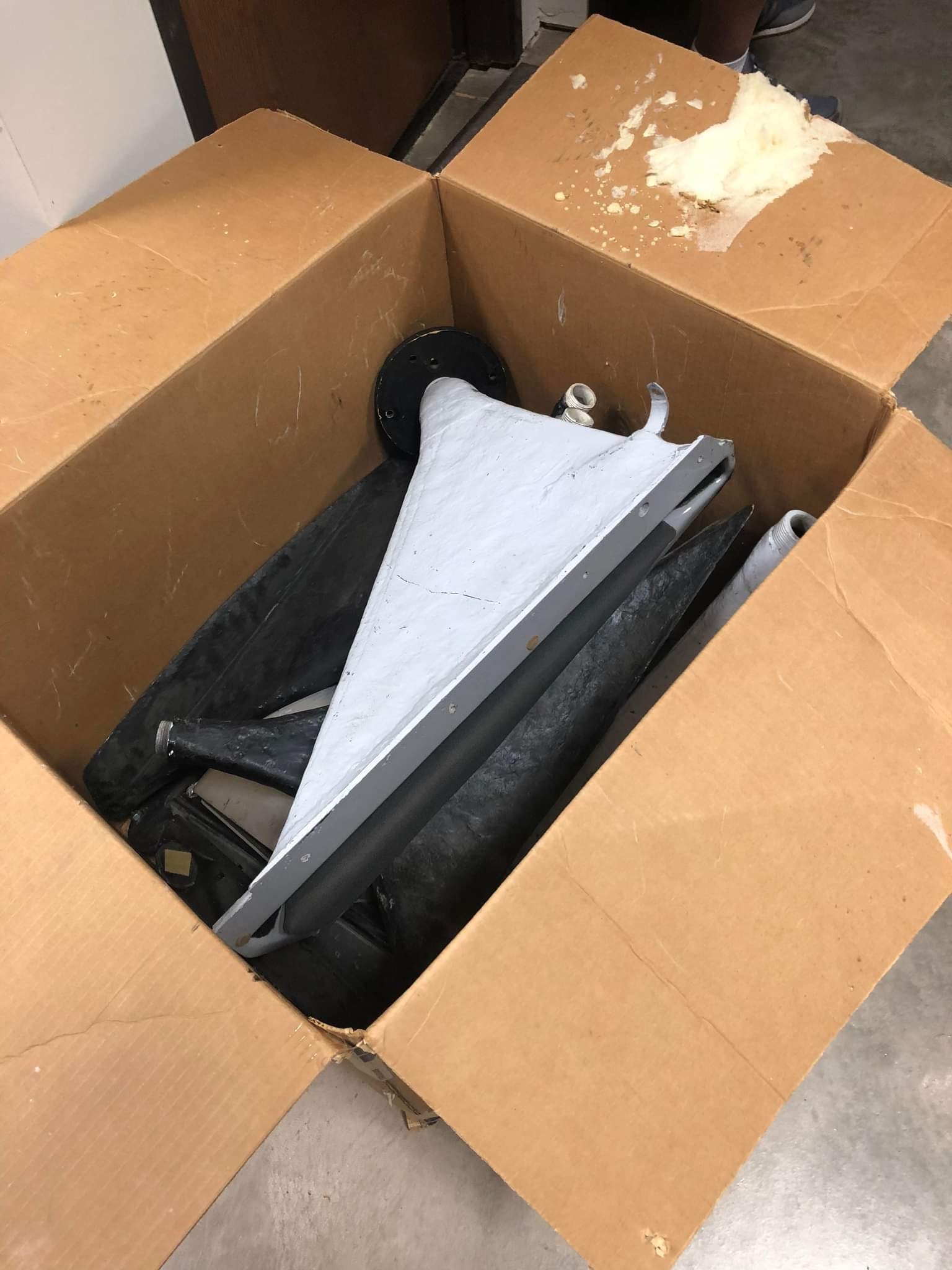

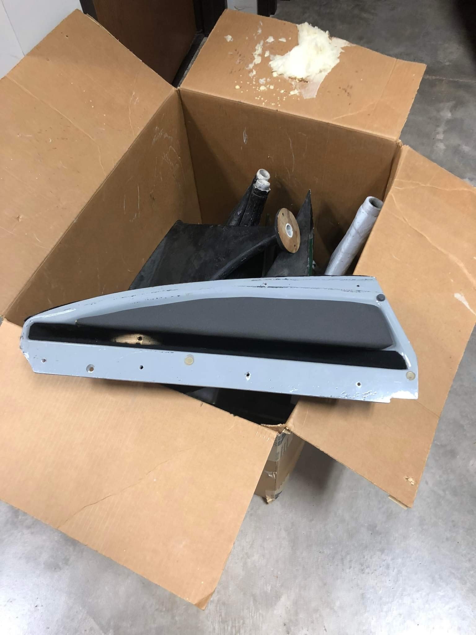

Here's some photos of the waveguides from Mark Eldridge's vehicle. I've never seen these pics before, very cool. I really enjoyed his episode of the podcast.

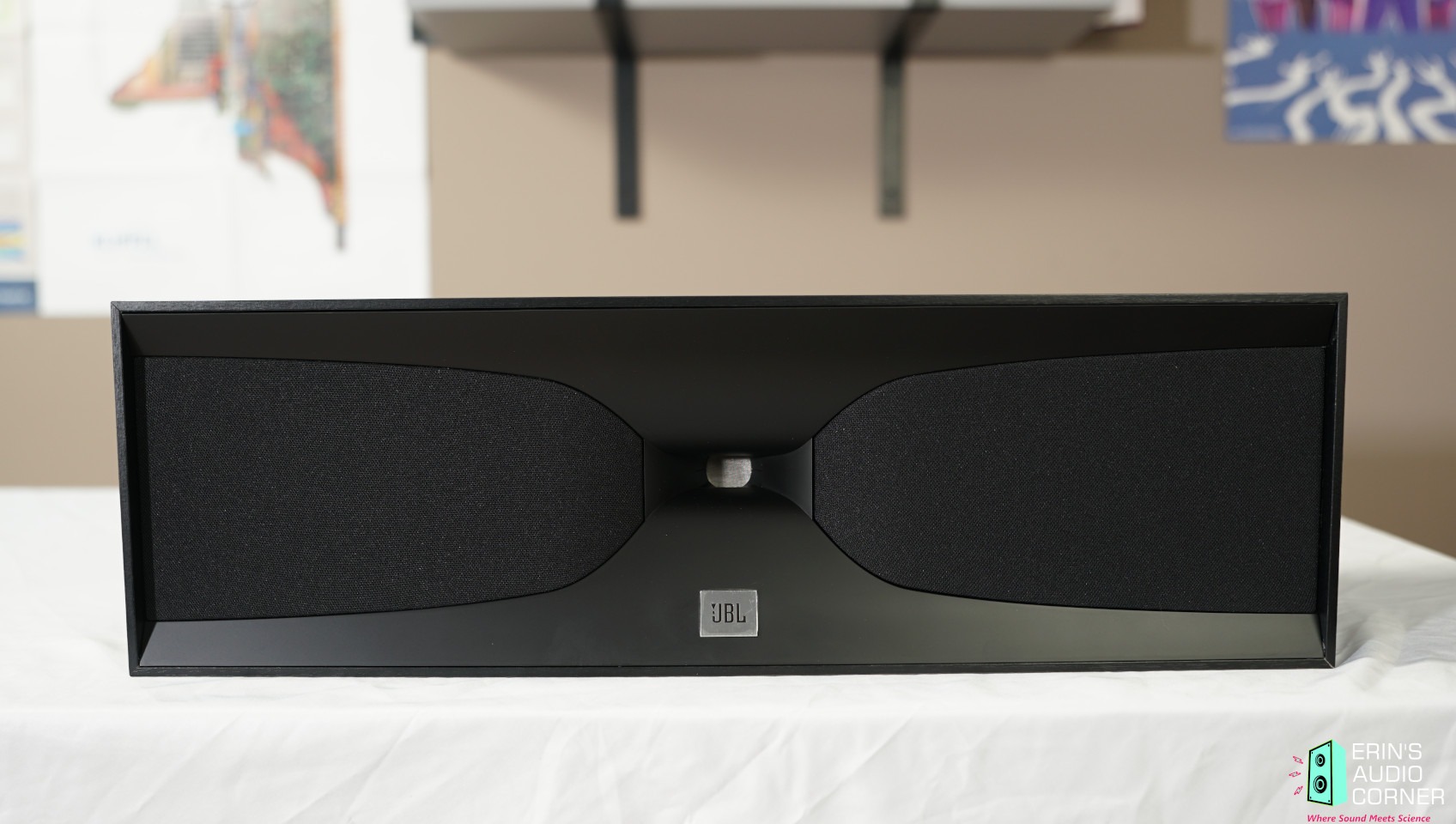

Here's a car audio waveguide, commonly referred to as a "HLCD"

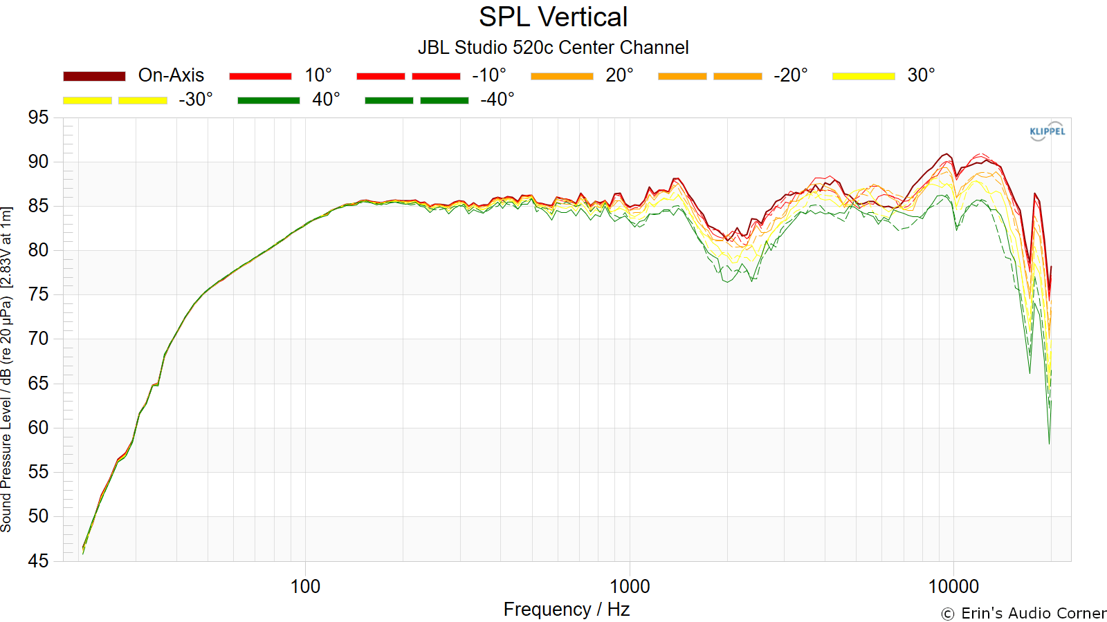

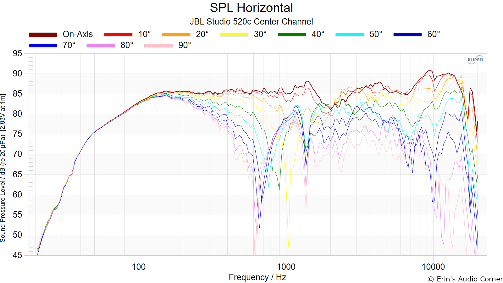

Here's a JBL Studio 520C. Similar width, height is about 2.5x taller. Both speakers use a horn loaded compression driver.
Here's the horizontal polars of the car audio waveguide
Here's the horizontal polars of the JBL Studio 520C
Here's the vertical polars of the car audio waveguide
Here's the vertical polars of the JBL 520C
Some observations:
Due to the fact that both speakers are very asymmetrical, performance isn't as good as you'd see with a symmetrical waveguide. But though the dimensions of the two waveguides is comparable, the JBL is superior in a number of ways:
1) It doesn't have a 15dB dip in the midrange
2) The off-axis response is comparable to the on-axis response
As someone who's designed more waveguides than I can count, I think the car audio waveguide has a midrange dip because of the reflector. Basically it's really challenging to get sound to make a 90 degree bend. Believe me, I've tried:

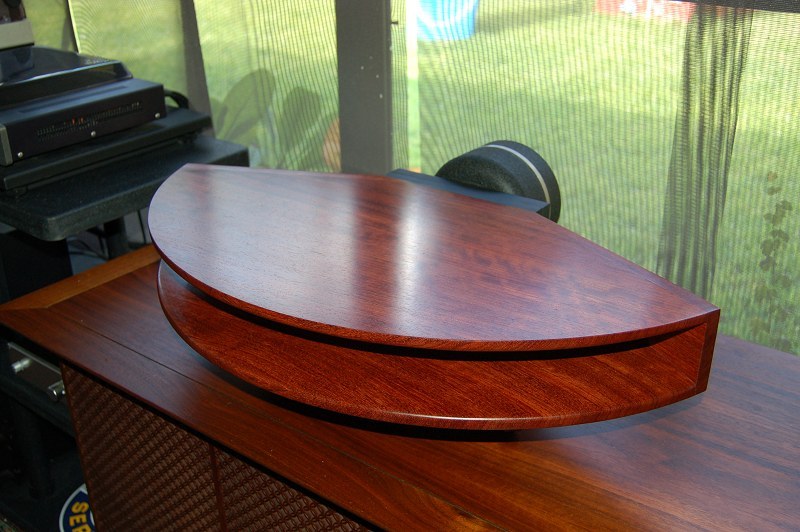

The setup in my office is fairly similar to how I used to set up my cars - I'm using horn loaded speakers in the office. Those JBLs linked in the post above.
In order to achieve a good soundstage I'm doing Ambio, but with a physical barrier instead of electronic processing.
Similar to this, but at my desk:
You have a divider through the middle of your desk? That sounds quite impractical. Lol. Pic or it isn't true.
