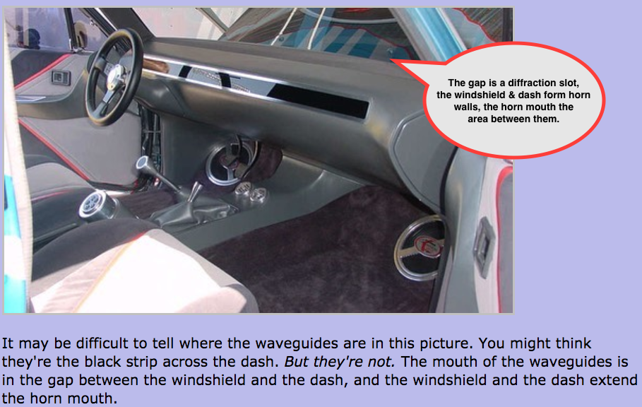

I feel your pain from the ban, but still would like to point out some mistakes, simply to avoid you going through more pain.
1) In post #135, you use a photo of a diffraction horn mounted under a dash. The dash in that case is technically a baffle, not a horn mouth. The horn's basic frequency response would not be materially changed by the baffle.
2)Oh well, sounds harsh.
3) A dashboard may or may not be a fundamental part of a "waveguide".
In the case of the horn depicted in #135, it is not.
In the case of the horns depicted in #140, the dashboard and windshield comprise the horn walls, the mouth of which extends from the bottom of the dash to the top of the window. The gap between the dashboard and windshield is a diffraction slot near the horn throat. You incorrectly called that gap "the mouth of the waveguide".
4)Incorrect use of technical terms will continue regardless of your ban or anyone correcting your mistakes.

It was over a decade ago I first attempted to explain the diffraction horn concept to you in one or more of your DIY threads, more recently the difference between between baffle step response and a "waveguide".
Loudspeaker Enclosures are Waveguides
