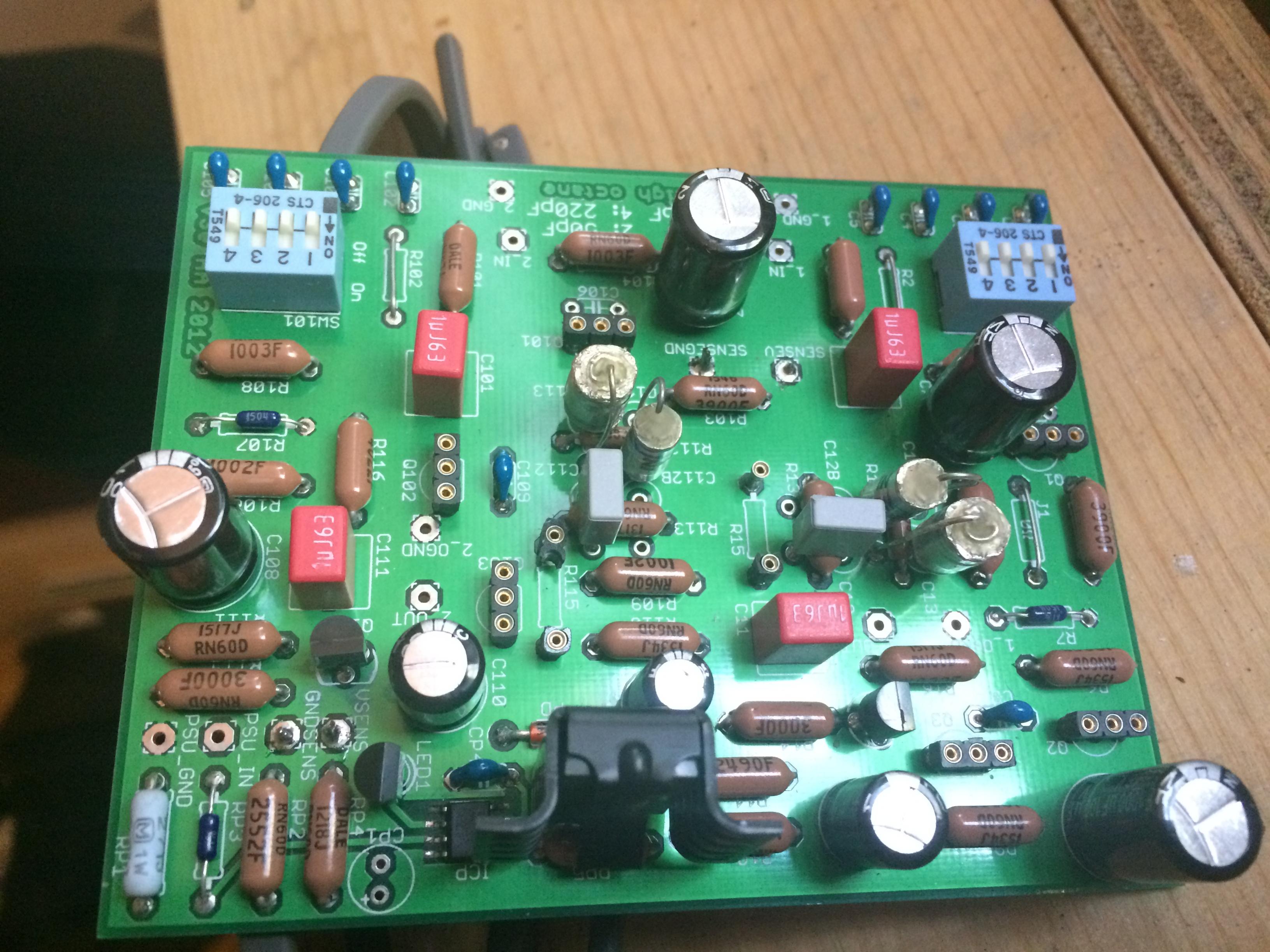

Jan,
Many thanks for sharing.
However looks like some parts are missing (at least to me 🙂) - but noob here, so appreciate the guidance...
The parts list does not mention part numbers like C101, C111 while the board seems to have them - I am attaching a build pic from diyA member msdin (hope that is ok) for your reference:
http://www.diyaudio.com/forums/analogue-source/242387-high-octane-phono-preamp-32.html#post4622575
Same I see for the LCR FSCEX 1% RIAA caps - 3 are listed, but 6 are present on the board.
Other parts like qty for Opamp and FET seem to be listed accurately.
Which part of the bill of materials are to be considered as "parts required for a single channel" and to be multiplied by 2?
Hi everyone,
it's sooo great to see there is still so much interest in my little phono pre! Especially at DIYAudio where so many great phono designs are made available!
There are a few questions about the amp, please give the high octane wiki a chance to help with some questions, you'll find it here
The high octane phono preamp
Regarding CP1, you can simply leave it out if you want to be on the safest side (works in all cases).
If you have one of the green boards (from the 1st run) then you can alternatively rewire one leg of CP1 to make it work, see also the Wiki:
The red boards should have this issue fixed and can use CP1 without modifications if I'm not mistaken....
EDIT: just checked my old posts and yep - for the red boards CP1 can be used as it is shown on the board,
http://www.diyaudio.com/forums/analogue-source/242387-high-octane-phono-preamp-12.html#post4495991

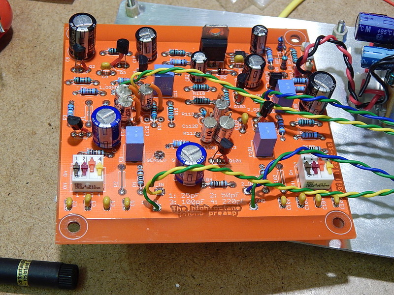

There are a few changes to the previous board, e.g. to make mounting of the board easier (it has now mounting holes) as well as it will fit into a normal Hammond 1455N1601 enclosure.
Then it also corrects a few warts and bugs of the previous version (C6/C106 are gone, CP1 is fixed and goes now to ground).
Oh - and of course the new board is RED
