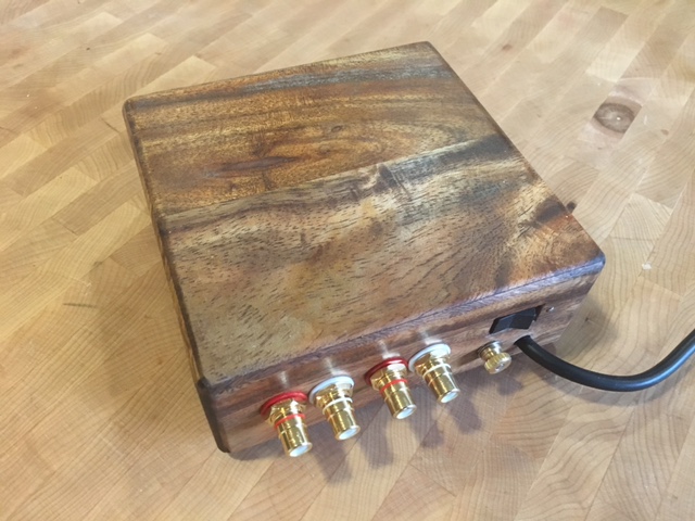

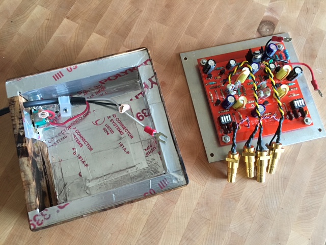

Last Christmas I bought one of the boards for my son, and of course one for myself as well 😎
Finally got around to finishing this build. My son's board is done as well, but I'll let him make his own box.
The board is built pretty much to Hannes's original specs, but using C1845's for Q1-3. Most of the components I sourced from my local surplus shop.

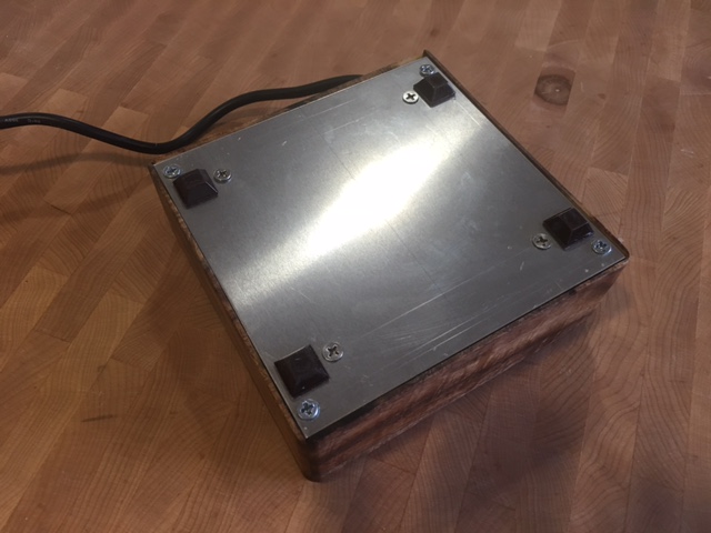

Threw together the chassis from some leftover acacia flooring I had, and a piece of aluminum. Lined the inside of the box with aluminum tape for shielding, and since the wall wart I found ($3 🙂) had a ground terminal, I added a lug for the turntable ground wire.

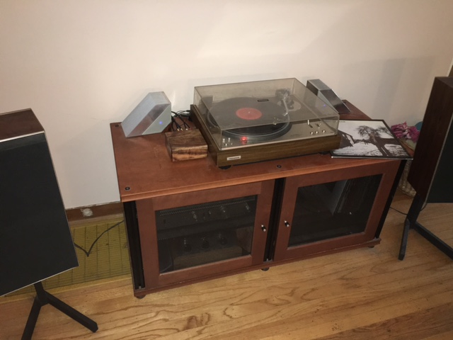

I'm not the most sophisticated of listeners, but I'm very pleased with the sound, even in spite the left channel hum from my turntable (will attempt to fix it the next couple of days). Won't try to get too descriptive, because frankly I lack that vocabulary; let's just say it sounds natural and satisfying...
Turntable is a Pioneer 530 with a Shure M92 cartridge. Preamp is a Bottlehead Smash. Amps are Amp Camp Amp monoblocks. Speakers are vintage BeoVox S42-2s, original except for caps.
Pics below for those interested.
Cheers!
