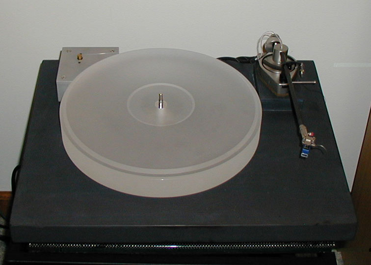

About a decade ago, I put together a turntable using parts from Scheu. They sold me the bearing, a 50mm acrylic platter, and the motor. I built the motor housing and had a slate plinth built out of 3/4" slate which I sandwiched with 3/4" MDF. Slate is commonly used for kitchen counter-tops and a local kitchen contractor was able to build the plinth for me. I used silicone adhesive to hold the slate/mdf together. I also built a plinth out of granite and found that slate was considerably better than granite. The slate was relatively inert even before being bonded to the mdf and the slate/mdf combination is pleasingly damped. Granite, on the other hand, rang like a bell, and even after being bonded to mdf didn't sound as good as the granite. So at least in my experiment, I found slate to be a good option. Rather than spending a lot on very thick slate, I've had good success with slate/wood combinations. The wood is hidden by a 3/4" slate lip around the edge of the plinth.

If it wasn't clear from the rest of the message, this should have said:Granite, on the other hand, rang like a bell, and even after being bonded to mdf didn't sound as good as the granite.
Granite, on the other hand, rang like a bell, and even after being bonded to mdf didn't sound as good as the slate.
---Gary
I can't draw that conclusion from my work since I never tried slate alone. I was worried that 3/4" slate was too thin and I went straight to the slate/mdf composite. I never listened to the 3/4" slate on its own.So we could say that slate alone does not cut the mustard.
I can definitely say that granite alone is a bad idea.
And I've heard thicker slate plinths which I thought sounded good but they were not systems that I knew well, so it's hard to draw any conclusion.
---Gary
