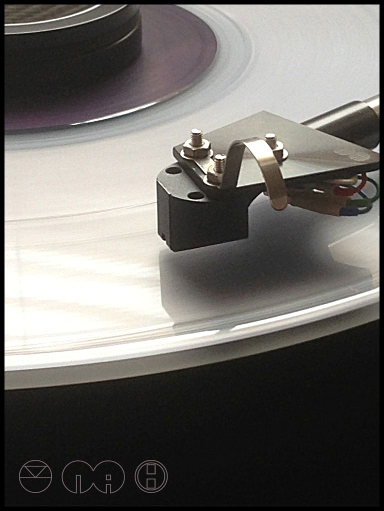

The cartridge is a bit unusual because it is a black Linn Troika (a unique prototype sample - all production cartridges were red) - this has now been rebuilt and includes a ruby cantilever and Fritz-Gyger S stylus.
