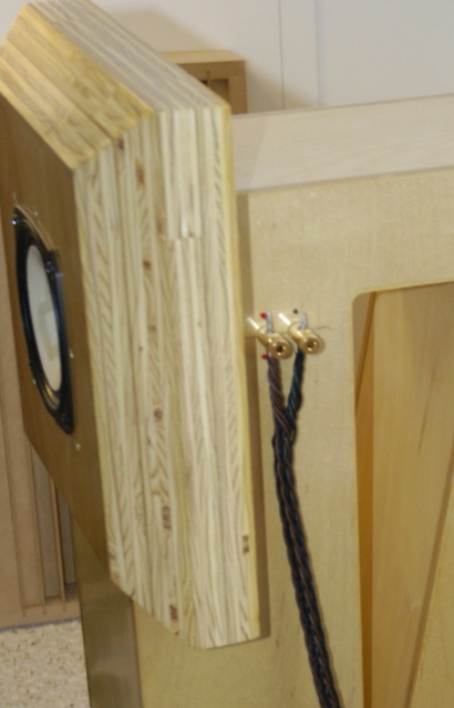

Here's a pair I built for a mate recently ... he's over the moon with them. I thought they were pretty dam good to, he's still to decide how he wants them finished.

I just got done wiring up the first of a pair of frugals. I forgot to do the internal wiring before sealing it up. DON'T MAKE THIS MISTAKE, PEOPLE! What an incredible pain in the ***! At least I learned my lesson and won't make that mistake on the second one.

there are some pretty tight corners to try and "fish" around in the FH
I've made the same mistake on prototypes myself, and now own a nice collection of "bell-runner" drill bits - that and the old hot glue glue gun has saved my bacon more than once.
You got that right. It's going to make it a bit trickier to attach the binding posts too (than if I had attached them when it was open), but I'm probably just going to make a metal plate (like the ones partsexpress sells for ~$10 each) for my fancy new posts.
They are going to look sensational. White wash stain for the "opiated ikea" look.
Of course, I've never forgotten something like that
But if I did, before I started drilling, I would try using rare earth magnets or one of my oversized woofers on the outside of the box and a decent sized nut attached to a fish line feeder cable, weaved through the box via the magnet on the outside, then tied to your cable and drawn through by hand.

Nope, not gonna happen through 3/4 (19mm) ply without some serious magnets. End of experiment for today.
Workable maybe?
Yeah, if I had any brains that would have been a lot easier. I wouldn't even need the magnet, I had tweezers to grab the wire through the small hole I drilled in the back. String and a weight would have been SO much easier.

what you need to do is to start a thread to build a really strong electromagnet, something you can plug into the wall you know a big bad boy coil something a man could be proud of? That kind of thing. I got a stack of cm dia neo magnets 3/4 of an inch thck the trick is to tie the string to one single magnet then the 19 mm mdf is no problem, go fish.

I'm glad you're chining in here. I tried with what I had but to little avail. I could see what might happen with the right gear and yes I tried it with a small magnet on the inside but Cal, he needum bigger magnets.
I realize this is OT but not only does it remind us that we all do a Doh! every once in a while, it brings an old idea into the speaker world. Do you think the "go fish" magnets would turn a corner ok? Is it so strong that it would just flop around following the "mother ship" as it plotted along the outside?

So a big nut on a piece of fish line, picking up the cabinet and shaking it through the folds has our vote then? Ok, back to the store I go, I have some magnets to return. 😉

Understood, but I've 'fished' through all manner of things including a multiple 'S' bend vent, so just looking at the F-horn drawing it should be relatively easy with a small gauge electrician's tape and maybe a lubricant.
