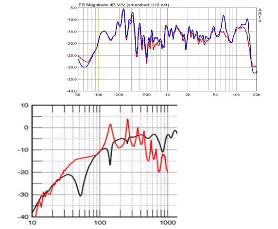

Scott, I realize those were not frugal horn measurements, but IIRC Dave said the level 0 frugal horn was mostly consistant with the horn shop expansion. The FH is of course a bit wider, but other than that, how different are they? Do you have a FR graph for the level 0?
And I need to move the horns into a different room. No problem.
The problem is that there is no chance my sister is going to tune these "in room" so I have to do the best I can to provide a generic tuning that hopefully will work in a variety of situations.
Scottmoose said:You mean these? That's not the Frugel-horn. . . .
But maybe not so different.
The FH is supposed to be quite equvalent to its "cousin" measured by Stereophile.
Attached is one of my measurements together with that of Stereophoile for the HSH. There are some distinct similarities.
The problems of the peaks in the 200-300Hz area producing the boxy/hollow sound of voices has also been discussed in other threads such as this one: New Frugel Horns: Tuning Problems. I still do not know if anybody have been able to cure it, other than by a lucky matching to the room.
SveinB
Thanks for the graph and the link. I'll look into it.
