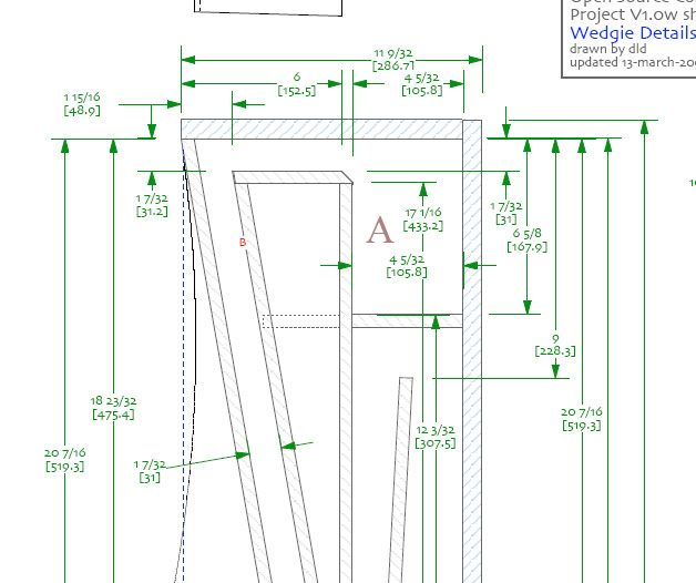

Re: Re: which speaker?
will try Pioneer, should I enlarge the air cavity? how much?
you mean the space A in the figure?
gychang

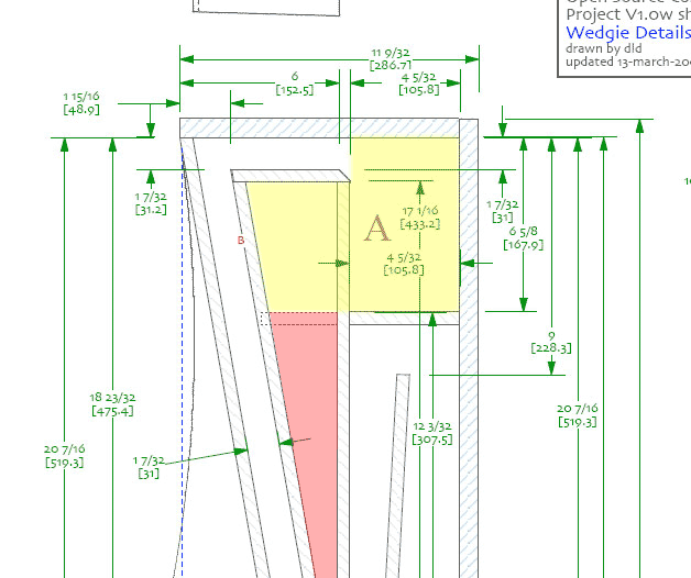

planet10 said:
It is worth trying them but do give yourself at least the medium size air cavity to give an opportunity to play with its volume.
dave
gychang
I'd suggest the yellow area, add the red if you wsnt max versatility. The idea is to make it to big and then fill it in bit-by-bit (wooden blocks, marbles, cans of salmon, whatever...) until you have the right balance coming out from the front vrs the horn.

planet10 said:I'd suggest the yellow area, add the red if you wsnt max versatility. The idea is to make it to big and then fill it in bit-by-bit (wooden blocks, marbles, cans of salmon, whatever...) until you have the right balance coming out from the front vrs the horn.
dave
Dave, very clear thanks,
gychang
which schematic ?
I am preparing to try the project with Pioneer A11 speaker. I am unclear whether I should follow the dimensions of 3/13/07 of "wedgie details" or 2/2/07 of Panel Placement details.
Their sizes are clearly different, I plan to try Level 1 build.
gychang

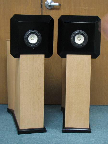

Finally got to hear a pair of these Frugel-Horns at the Puget Sound speaker contest.
I was impressed. =)
Very open, very smooth, nice tonal balance and good bass. Very easy to listen to in all respects. A true pleasure.

Those are a particularly pretty construction of the Frugels; Terry who was the builder and what electronics would have been used?

chrisb said:Those are a particularly pretty construction of the Frugels;

The execution of those Frugels is very nice, the incorporated baffle and the one-piece plinth look great. (I didn't use the "uber-baffles" on mine - didn't care for the look ,but those I could live with.)
As per Chris's question, what was powering those 108EZ's?

chrisb said:who was the builder and what electronics would have been used?
Terry-O could tell you who the builder was - I don't remember his name. But they were very nicley done. And heavy! Used cat litter for balast. 😀
Source was a Logitech/Squeezbox Duet thru a Conrad Johnson preamp to Terry's Gainclone style chip amp. Worked great.

I just now saw this. The 108 Sigma/Frugalhorn builder was Doug Nash, who does really beautiful woodwork on his cabinets.
Mr. Maniac is correct, although that was the later set-up. The original Genesis I-60 tube amp and the Sony 777 cd player perished during play and couldn't be revived. Just awhile later, we thought the 2nd Genesis amp, in the Judge's Room, was also getting ready for the Last Rites, by emitting strange sounds from one channel. But it turned out that some Idiot had knocked the phase plug on his "Black Box" speaker off center and it was rubbing. Appearently, Mr. Klutzo must have realized what had happened as he fixed the "amp" by re-centering the phase plug immediately, to the relief of all present.
