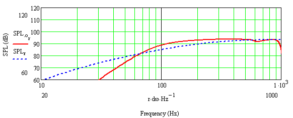

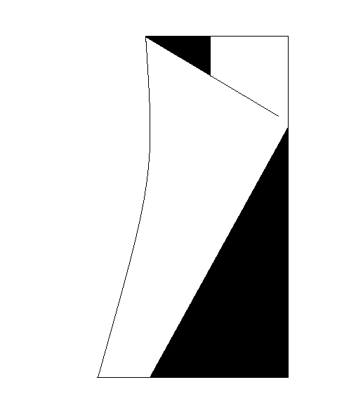

New Frugal idea for the FE126E in (very) early development. This is not a MK2 version of the F-horn, but something a bit different. Initial math & modelling is done, and concept appears to work pretty well. I thought it best to mention / introduce it here, as externally, it's identical to the Frugel-Horn Build Level 1 upwards. Internals are completely different though, and very simple. If the idea is approved, then a couple of reworked versions for the FE108ESigma and FE127E might emerge.
A teaser in advance: if Fonkens did corner horns, this might be what they'd look like.
Basic idea of new box as I described to Dave last night.
Take a Level 1 build Frugel-Horn, and remove all internals. There is a triangular chamber, of adjustable volume, to accept different units, at the top (surprise!), with a small, slot vent at the bottom of this chamber, below the driver. Under this is a long strike-plate leading to the rear of the cabinet base. And, er, that's it.
Basically, this is a micro-Fonken cabinet, coupled into a massive flared vent for a target F3 of 99Hz, giving another 20Hz of extension and a much slower roll-off as compared to the chamber itself with a simple small resistive vent. Pushing it into corners and / or adding deflectors should boost the LF a bit too. Driver control is very good, as you'd expect from a Fonken, response nice & smooth. The 127, with almost double the excursion of the 126, can have a larger chamber and be tuned lower. Rough layout is attached. I'm trying to tweak the dimensions a bit to reduce the ripple at ~650Hz.
BVR-space... I like. 🙂
I'd been wondering about a final home for my 126s for a while. I wanted something as minimal as I could, as my current mission in (audio) life is to try & extract the highest possible performance from the simplest enclosure I can come up with. So I thought we could combine the sleek aesthetics of the Frugel-Horn with this sort of hybrid fonken BVR corner-firing alignment for a stealthy sort of box that's just a bit different.
Good idea about the bracing Dave. I only put it there really to show a blanking plate to allow the chamber volume to be adjustable, but some bracing certainly wouldn't go amiss.
