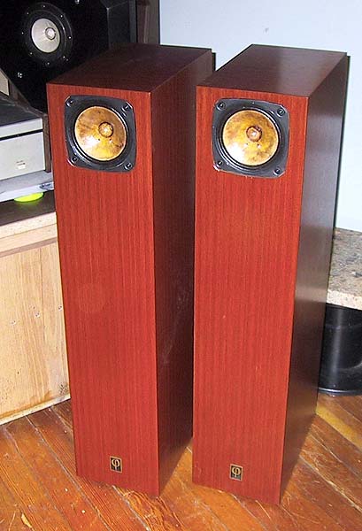

planet10 said:
No... those are now finished and for sale -- i'll take some pictures. They are quite pretty.
These are having the FF125 installed so that we can optimize for it and evaluate it.
dave
I really liked them the way they were when i had them. What is the price ? I was definaly considering a set when i borrowed them. Just needs a Ribbon on top ( my opinion )
Picture,
The flash doesn't really capture the colours... i'll try to get some better pics tomorrow. The "copper" coloured drivers (they don't look copper in the picture) are intended for our full-build frugel-horns.
dave
