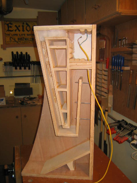

Shot of the internals. I built these speakers with scraps of plywood I had lying around. My next build will be 100 percent BB or Apple ply (even better!). Notice all the bracing. The screws holding part F were put in because I felt it would resonate without them. All voids are filled with cat litter. For the CC I decided to use half rounds of dowel. This solved the problem of parallel surfaces. In the end, I still had to add a block of wood 1.25 x 1.25 x 5 inches and two blocks 1.25 x 1.25 x 1 to the CC to get the volume down to where I liked the sound. Notice the small amount of stuffing. That's the only place it really sounded good to me.
When finally finished, the cabinets are completely dead except around the bottom mouth, where they ring slightly when knocked on.

Thanks. I've learned over the years that when building something I allocate 50 percent to the actual bulding and 50 percent to finishing. It always seems to work out that way.
The binding posts are the five-ways from Parts Express, $5-6 or so. They are not really recessed, per se. They have the knob part you attach the leads to and then a threaded post through the wood with a nut and plate for the internal wire on the backside. I think it's a 3/16 hole which is all that is needed for mounting them. On the shot of the notch filter, you can see the two ends at the top of the recess in the base.
Doug
One thing I forgot to mention. I have not weighed them yet, but I recently picked up some 60-pound bags of sand, and these weight almost as much. They are not easy to move.

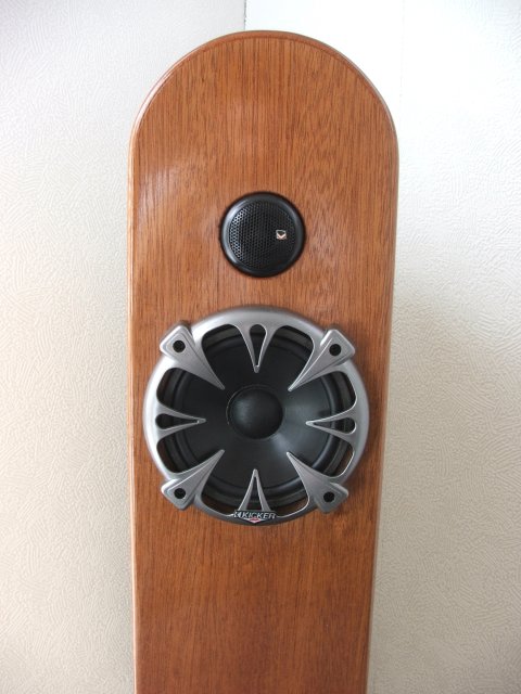

I will try to get as much information on them as I can, but I have moved a cople of times since I got them, and the original box went ages ago, however, the basics are
* Manufacturer: Kicker
* Woofer (in., cm): 5, 12
* Tweeter (in., mm): 1/2, 13
* Crossover (Hz): 6k
* Impedance (Ohms): 4
* Frequency Response (Hz): 38-20k
* Power (Watts): 45
These were the basic details I wrote down about them at the time.

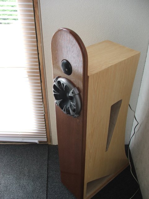

So now I've spent 24 hours listening to them, I'm still very happy with the sound. I ran through a few frequency range tests last night using a Reference disk supplied by Nakamichi. There are a few obvious peaks around 180Hz, but I think this might be down to compression chamber tuning issues, however, this asside, the spimd was clean and fairly consistent to my ears from 80Hz ish, below that, there was a nice gentle rolloff.
I'm sure they will not be to everyones taste, for some, the thought of using car speakers in this situation is just plain wrong. And if I'm honest, had anybody suggested it to me before I tried it, I would have said it was wrong too.
Over the next few days, I will make adjustments to the compression chamber size and see what effect this has.
I've attached a photo to show how they look.

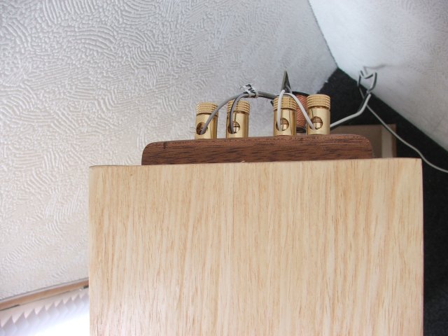

Another pic, showing the placement of the banana sockets which are mounted on a pice of mahogony so as not to intrude into the horn passage.
You can also see the original crossovers hanging down below the sockets during testing. These crossovers are really bad, muddy the sound up a lot. The soundstage opened up by miles when I removed them.

CossieGlyn said:I'm don't like the mounting rings they come with, but haven't had time to make some yet.
Thanx for the pics. The mounting ring gives them a "gothic" kind of character, but they are a bit over the top.
What comprised the XO? You will need at least a blocking cap on the tweeter.
Nothing wrong with some car speakers. Like any others you just need to pick thru them to find the jewels.
