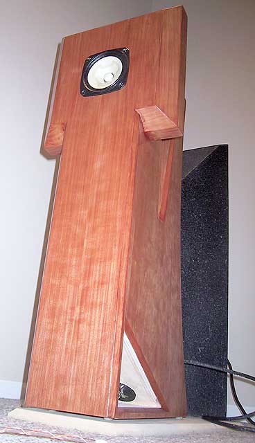

this is my unfinished version of 1.4 minus the wedge and the curved back.
the front,top and bottom is also altered so its one piece with no Baltic birch ply showing. the back will have trim also to hide the ply.
the front and top are a unique pick of plain maple that has a nice ripple in it.
It should come out in the stain. there is no baffle because it was not in the WAF. However before it gets finished I may add some maple wings if I can get away with it after it gets some break in time.
P.S. Dave your plans could not be any better. they were as perfect as you could get and zero guessing.
Your modded drivers look awsome in them, so good in fact I may not stain at all.
Thanks for everything
