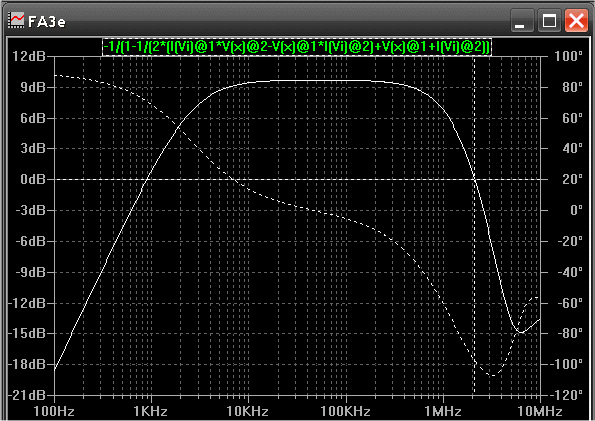

AndrewT said:Andy,
if the gain of these amps we're analysing were all +20dB (10times) then the GBW product would be in the range 8MHz to 12MHz. Is that correct?
Yes, that's exactly right. Looks like OS's latest creation has a gain of 28, so that gives it about a 28 MHz GBW product.
Now that I am there, what do I do with the unity loop gain graph to check stability?
Do I find where Gain intersects with Plot and read off frequency and at that frequency read off the phase to be subtracted from 180degrees?
Or should I be using the GBW product graph to extract the phase margin?
The easiest way to determine stability is to find the phase margin from the loop gain plots. To do this, find the unity loop gain frequency (where the magnitude of the loop gain is 1x, or 0 dB). Find the phase shift phi at that frequency. Take that number and subtract negative 180 degrees from it. OS and others have been targeting phi = -100 deg at the ULG freq. So the phase margin PM in this case is:
PM = phi - (-180) = -100 - (-180) = 80 degrees
IOW, the phase margin is how far the phase shift of the loop gain at the ULG freq is from -180 deg.
Assuming the input LPF is disabled and there is no lead compensation cap in the feedback loop, a PM of 90 degrees will give a small-signal step response that looks just like a first-order LPF. A PM of 78 degrees for a second-order system gives a critically-damped step response. A phase margin less than 78 degrees in a second-order system gives overshoot and/or ringing in the small-signal step response. An oscillator is designed to have a phase margin of exactly zero degrees.

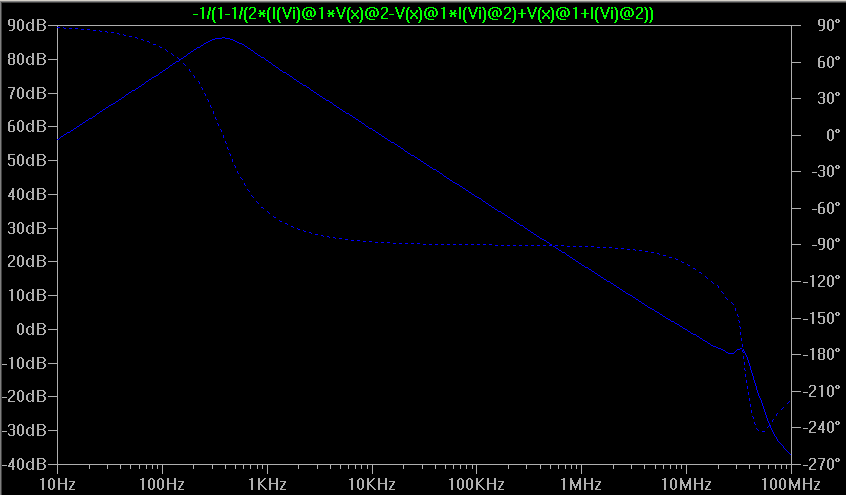

I did this on my fa3 with LG2's probes between Cdom(S) and-1/(1-1/(2*(I(Vi)@1*V(x)@2-V(x)@1*I(Vi)@2)+V(x)@1+I(Vi)@2))
VAS out as was shown . the resulting plot was reversed (inverted)
I then changed where "X" was placed and plotted the
typical "skislope" plot starting at 90db and decaying with
freq.

For global loop gain, I use the simplified way myself, just because it's easier. But there's many things that can trip up this technique. As long as you're aware of these, it's fine. For example, connecting a lead compensation cap from VAS output back to the inverting input of the amp creates another feedback loop. To see the loop gain of that inner loop, one must move the probe element(s) inside the inner loop. But if you try this with the simplified method of just a voltage source, you'll violate the assumption under which its approximation is accurate - namely that one side of the voltage source looks like zero impedance to ground (e.g. the amp output).
So as long as you're aware of the limitations, it's fine.
I did this on my fa3 with LG2's probes between Cdom(S) and VAS out as was shown . the resulting plot was reversed (inverted) I then changed where "X" was placed and plotted the typical "skislope" plot starting at 90db and decaying with freq.
It's hard for me to visualize what you did. The "X" node should be at the junction of Vi and Ii, rather than on the other side of Vi. I usually just open up the loopgain2.asc, use F6 to copy the probe elements, then Ctrl-V to paste into my schematic. This renames the probe elements to "Vi1" and "Ii1", so I have to rename them back to "Vi" and "Ii" by right-clicking on the text. That way I don't mix the orientation up or have to retype the expressions u(prb) and so on. The way the complex formula works out, you can flip the whole probe around either way with Ctrl-E and it works exactly the same in either direction.
For the VAS loop gain, you can spot errors by observing that, if correct, it looks like a bandpass filter, and that its phase is approximately constant at -90 deg after it starts rolling off at high frequencies. It's just like the global loop gain in that respect. Here's an example VAS loop gain plot.

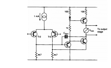

(symasym - 2n5401 most others - mpsa92/42 or mje350/340)
Jaycee's VAS is a Lender design (with the diode) and should
be compensated like in the attached diagram.
OS
is the second stage PNP really that, or is it an NPN?ostripper said:Jaycee's VAS is a Lender design (with the diode) and should
It's not the same. The VAS is identical to the symasym style one, the differences are the current mirror and one side's load. The diode simply provides the same sort of voltage drop as a diode-connected transistor. The differences are mostly to do with thermal balance.
The instability isn't in the VAS anyway, it's in the input stage.
Really, what I need to do is build it, but without a 'scope i'd be guessing. I'm annoyed that I missed out on getting a Telequipment DM64 'scope from freecycle last week!
I just used the D.self drawing for an example. To clarify this as I have modded mine both ways, In the symasym.. (FA2..what I have now)2 capacitors in the VAS cause instability (oscillations) . I have
found in both versions only one cap (cdom),with the diode or
CM version, offers more stability (I have
scoped it and felt warm zobel's with 2 Cdoms)
the VAS behaves much differently between the diode and true
CM versions in regard to compensation and gain.Make a board
with extra pads or veroboard it to "play".
The CFP on my new one (FA3) is really good and does not have
the excessive gain as does the cyrus one..good luck.
OS

Oh.. some boring VAS "fullup" loopgain plots will follow..
Plot below shows the predicted bandpass plot, but even
on a simple blameless I could not emulate Andy C's VAS
😕 OS
