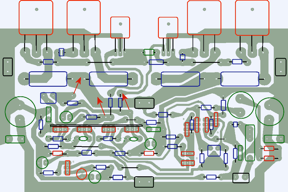

ostripper said:Yes , in simulation on LT , microcap , NI 10 ,and with the onset
of clipping. (trying to put a little more H3 into the picture).
They can't all be wrong..
OS

By homemodder - wonder why the 5th is not coming down too,
the plot I did not show, the one with the darlington.., had
5 DB less H5 ,so that is why I will order 4 Ksa700/800's
from mouser (why not) . board will take all the mods discussed here , , and still look good.OS

I just ran your .ASC file with my models (ksa992/1845 -I've now uploaded the LTSpice files, and a 10KHz full power FFT image.
njw0281/0302) fast amp.. very good..

I ran it normal no hangups.. but when I clipped it😀 😀
it broke out in oscillation when VAS saturated.
I added degen at CFP (22r) and it behaved unconditionally.
Also 10pf lead comp. at vas made for "whacked" LG plot.
I use LT4,by the way...
OS
I use LT4 too, but models from a japanese factory, slightly better with jaycee s models, this is nuts, I must try that degen. Whats happening here??
what does this mean?10pf lead comp. at VAS made for "whacked" LG plot.
Is it good or bad?
Not enough phase margin at HF..
