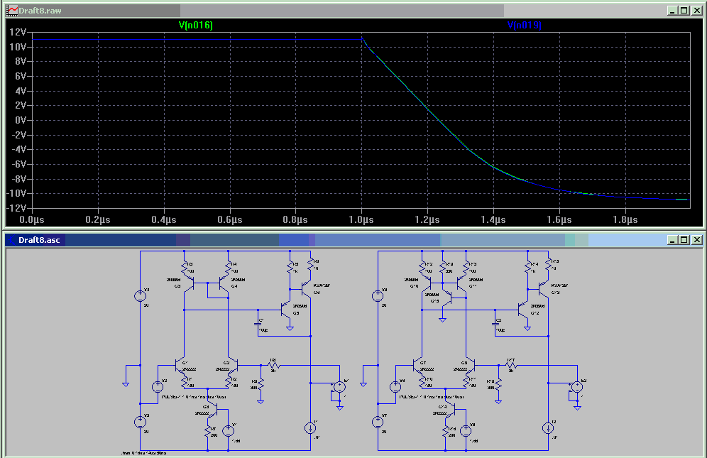

Well that is a pseudo technical explanation that may appeal to those who don’t know any better. Is your amp continuously slew rate limiting during use? :spin:
I guess I have nothing better to do, so attached below is a 100kHz squarewave simulation of two opamps, identical besides the LTP current mirror (stock Vs 3-T). The output waveforms are superimposed (green, blue traces). Please point out the “superior decay at HF”.

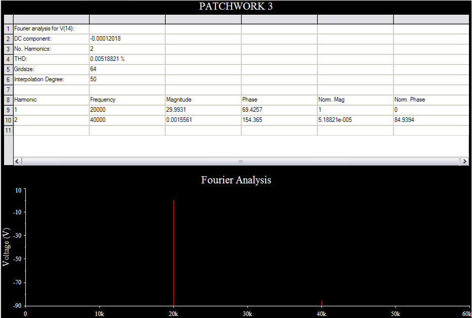

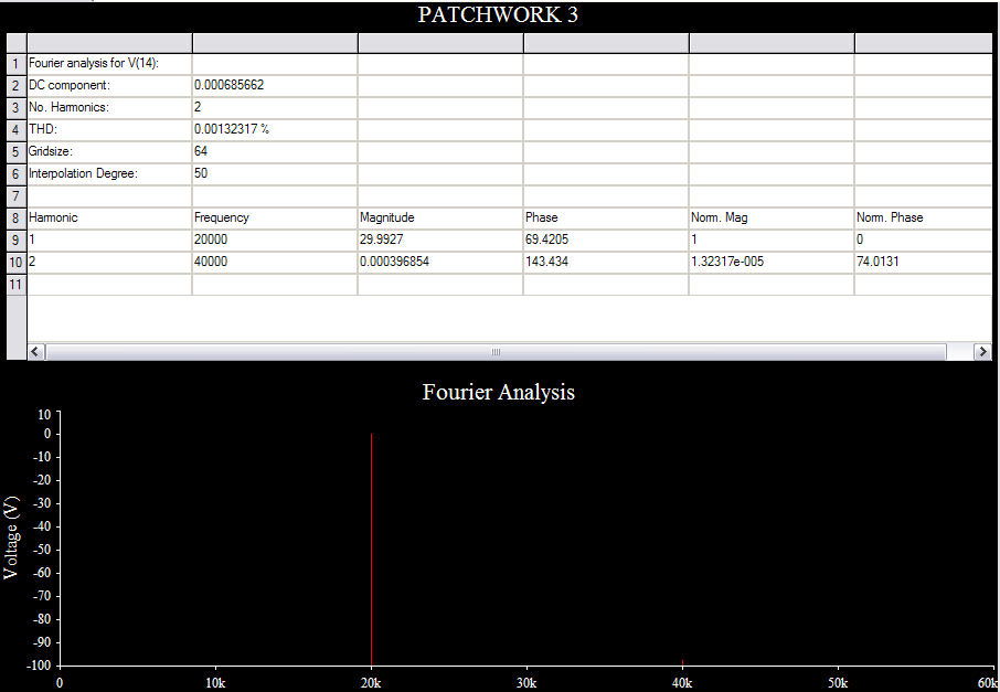

Disabled Account
Joined 2007
Re: Re: I guess I have comments...
Really, the resolution is way too low to see the difference.
:rolleyes:
Here's another exercise while you don't have much to do: show the remarkable difference between these two in THD and current sharing that my low rez sim didn't illuminate.
Go on, I dare you.
:devilr:
My sim, using that exact same configuration in OS's amp gave the higher THD and didn't make any difference whatsoever in the balancing of voltage and current through legs of the LTP.

Disabled Account
Joined 2007
Re: Re: Re: Re: I guess I have comments...
You really don't get it, huh?
differences in simulation with a THD resolution of 0.001%
:rolleyes:
I did get it. That was the point i was making - that there isn't a significant difference. Go back and read my post.
Is this is the low resolution you are referring to?

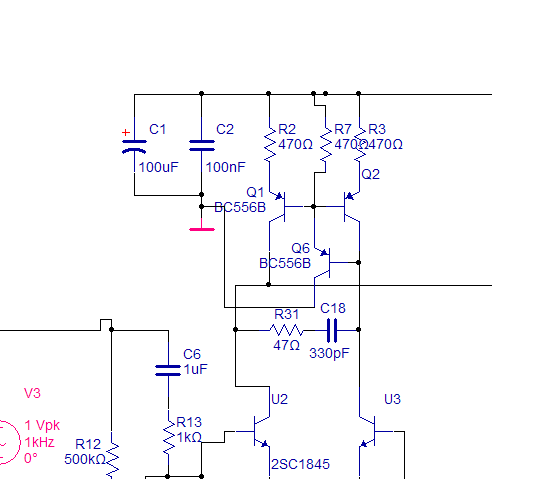

By sandy K - Please give the guy a break, he is only learning what you both take for granted. How about some constructive suggestions to OS, instead of just posting criticism based on simulator results ?
Quite to the contrary ,I welcome constructive criticism as it just
leads me to more knowledge. I rebuilt/cased my amp today
changed the CM 470R's to 220R's and various other changes.
Thanks to lineup, I been playing around with "real' tranny models
in my ltspice , still a novice but since I repair PC's my software
"learning curve' is days not months.
One cool thing I learned w/spice is the reason for R9-C3 at
the CM collectors, It rolls off OLG > 50k ...perhaps this is why
this self amp doesn't like to be an oscillator. :hot: :hot:
Also seen is the effect of the 220R emitter resistor change.
Supposing that the circuit is already working and designed properly with a stock current mirror, the the base diode fudge or the third base current "helper" transistor can be added with no further modification
Here, just to see whether the effect was either "psycho":crazy:
or as AKSA said "psychoacoustical" I put a switch at BE of the 3rd
tranny. First I tried this w/headphones w/resistor(scary)no
thump! then I tried speakers, first w/ac-dc, then turned volume down, threw switch, viola!
With rock little difference is heard, but with vivaldi or such its
like a "stereo wide" effect. Strange to me too, for my LTspice showed
very little difference sim wise. A mystery.
Here is the updated schema of changes..
P.S. Q-X = mmbt6520 (350v hfe 200)
Just to clear the air, my design goals are , under 20US$ per amp,
flexible mounting options(L-bracket, direct 90,or flat), non-
catastrophic failure (no burnt boards),and no freakin' oscillators.:D
:hypno1::hypno1: :hypno1: :hypno1: :hypno1: :hypno1: :hypno1: :hypno1: :hypno1: :hypno1: :hypno1: :hypno1: :hypno1: :hypno1: :hypno1: :hypno1:
Sorry, invalid testing method.
Get somebody else to flick the switch or not on the flip of a coin out of sight, but not when you are listening; preferably between stopping at the end and replaying the same track (with the phones unplugged in each case).
Listen to the same track 10 times in a row, note down each time which position you think the switch is in. When finished compare notes with the switch flipper.
Glen
