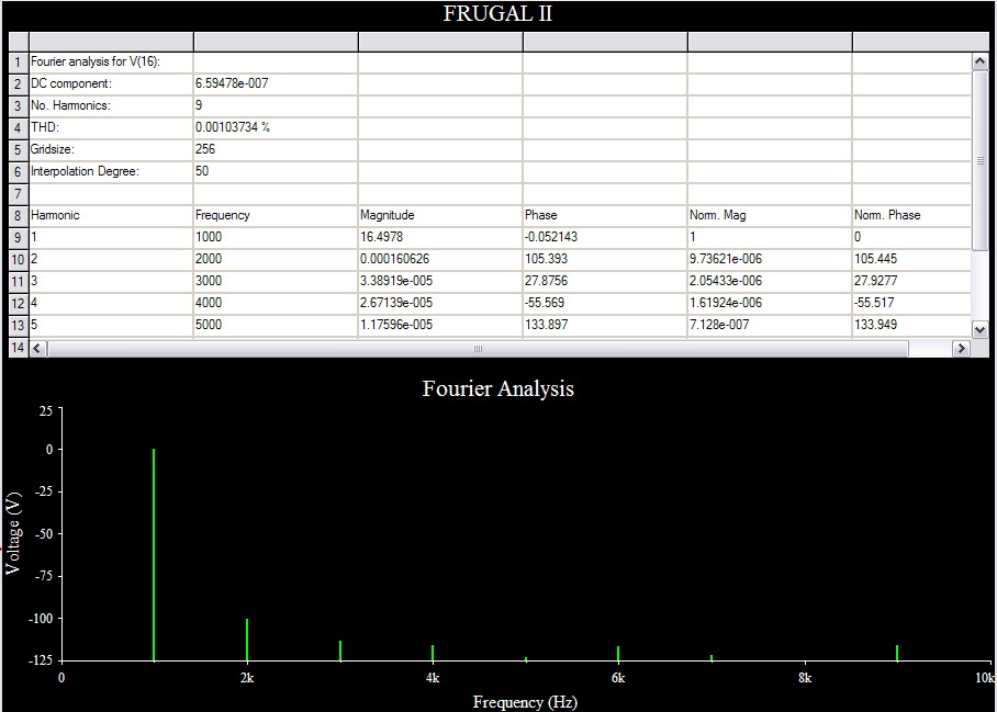

The way I have used to test THD before is to write a .tran statement with a short period (10m), and a very small timestep (0.001u usually). I then do .four <freq> I(load). I ensure the circuit is set up and biased prior to this.

Now that I learned real good, I will show some FFT's..
(that is 1K/1W- FA2/3 .001% H2 -90db.. H3 .0005% -93db)
and hard clipping..
😎 at 150W
FA2 showed much worse distortion than 3 in this FFT.

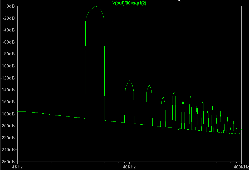

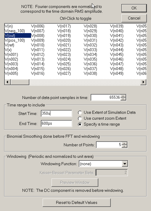

OS, you should be able to get the residual junk of the FFT about 180 dB below the main signal. I'm not sure how you're doing your FFT, but one must not start the FFT at the beginning of a simulation. It's important to let any transients settle out before beginning the FFT. This means taking the FFT over an integer number of cycles starting near the end of the sim and going to the end.

You mean "grab" the last .1m from the plot and .four that??
(how would you do that??) BTW , a cascode topology

BY andy C - you should be able to get the residual junk of the FFT about 180 dB below the main signal
-180 is indeed impressive, I haven't even seen that on
curls thread. how would you do that?? 😀

When I did at simulation of 100ms and sampled the last 10ms
of it, the results were horrible but when doing a fourier of
only 10ms everything was acceptable....strange.

What i've been doing is doing a very detailed .tran, 10ms with 0.01u step time, operating point resolved first. What i've also tried is doing 12ms and starting capture at 2ms, but i still get a poor THD reading and large 2nd and 3rd harmonics.
