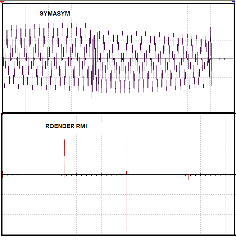

I tried the second Miller cap (100pF) on my sim, but it didn't completely stabilize it.
Does LT have a real time o-scope? If so, probe the output from the LTP into the VAS. Here's what I see for the stock Symasym (on top) and the most well behaved amp that I have modeled so far - the RMI by roender. This is with both amps handling a 1k squarewave.

AKSA said:
I have watched with astonishment how quickly Pete has picked this stuff up through his simulations, far outstripping me..... and I have corresponded with Mihai and know his mathematical insights to be profound and accurate.
OS came in here with some knowledge, for sure, but he's moving by leaps and bounds. He's picking this stuff up fast. :up:

By MJL - I tried the second Miller cap (100pF) on my sim, but it didn't completely stabilize it
Interesting, as I never gave the original symasym a dirty
sqaurewave before moving on to mine ..just an idea
to improve upon.
Here is that LTP to VAS pulse from FA2, looks like roenders..
