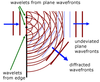

Attached is one of the better diagrams I've found illustrating diffraction at the edge of an obstacle. The new wave fronts on the far side of the obstacle are simply the envelopes of the wavelets, and are constructed by drawing a line which is tangent to the leading edges of the wavelets.
These tangential lines are shown in blue in the diagram and show how both the undeviated plane wavefronts and the diffracted wavefronts develop on the far side of the obstacle.

@Galu: It says it right on the picture "wavelets from plane wavefronts/edge". Look this is much like how I invoked the name "phantom source" in my own posts. There is no actual "source" at the edge where diffraction occurs, just as there are no real world "wavelets". These are just made up constructs to better explain/model the physics of diffraction, etc. This is, of course, very useful to explain/predict but I would not read into it more than that.
