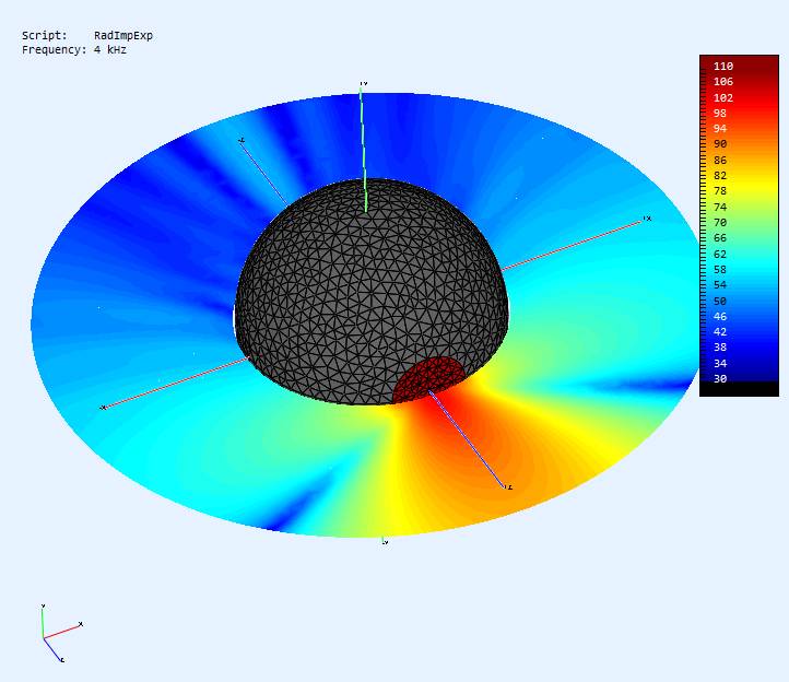

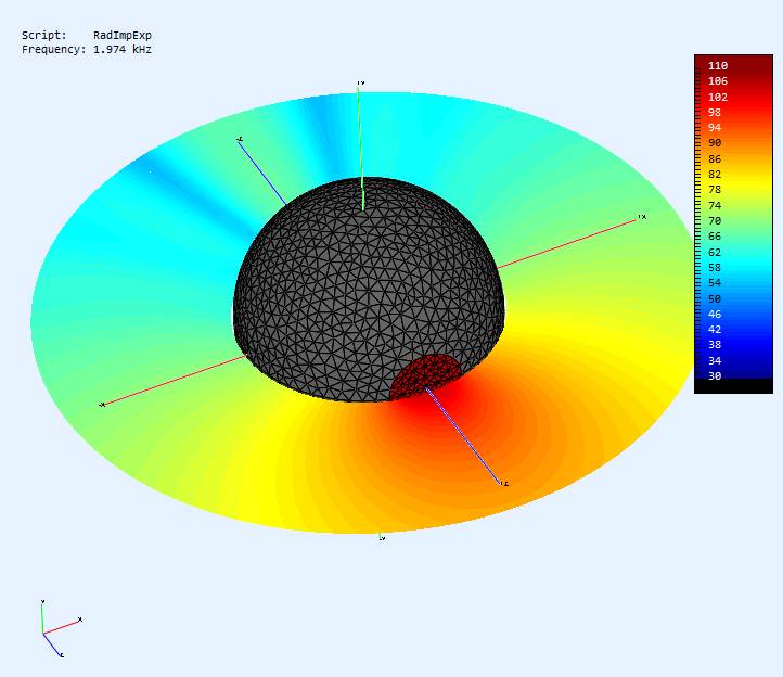

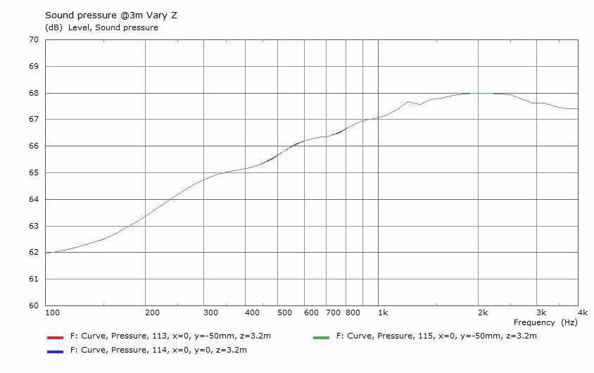

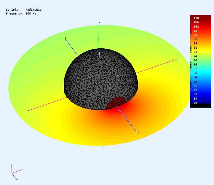

This is how I think about 4pi vs 2pi (baffle step)
When wavefront reaches the edge of baffle, it starts to bend over and spread wider around in space (remember this is 3-dimensional), then same energy (spl, amplitude) gets spread into larger space and pressure diminishes.
Diffractions secondary wavefront(s) make minor disturbances locally, ie. variations in pressure with different summation at various deviation angles.

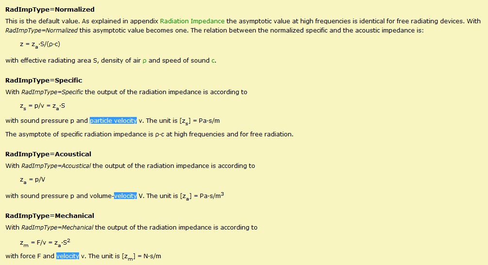

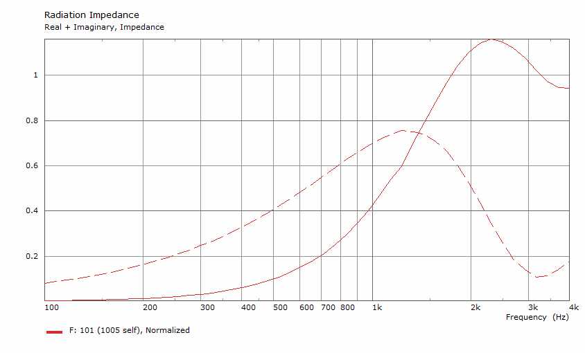

Some food for the thought experiment. Acoustic radiation impedance.
The sphere is R200mm, driver is R30mm, and is an ideal membrane under constant force (acceleration).
Up next, a map of radiation impedance from the driver around the sphere. Might take a day.
