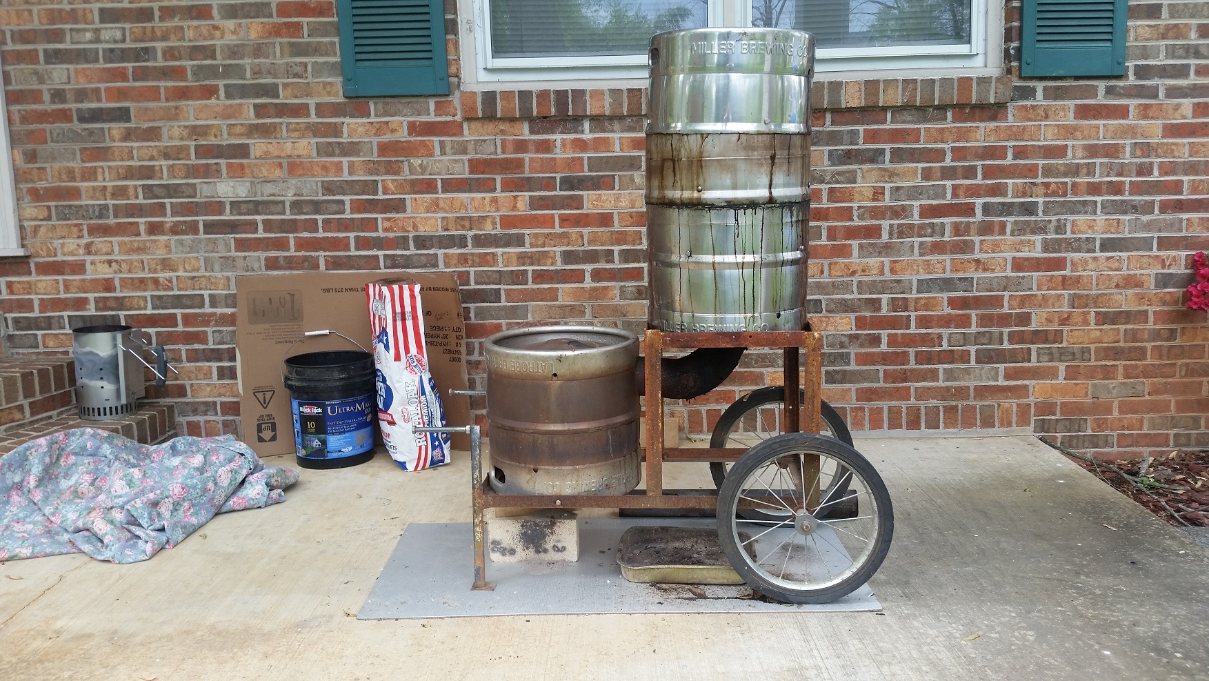

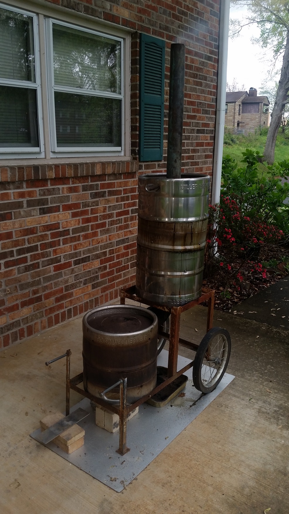

I took two beer kegs.Nice rig, I don't think I've ever seen a setup like that before.
For the firebox, I cut the center section out of one and turned it upside down so the spigot opening is the air intake. I cut a 4" diameter hole in one side of the bottom (now top) section for the chimney to the smoking chamber.
The second keg I cut below the top chine with the spigot up.
I drilled four holes in the bottom section at the chine and put four 1/4-20 bolts through the holes to make supports. I used mild steel expanded grate and cut it in circular sections to set on the bolts.
The middle section from the first keg got the same four bolt treatment, and it's section of expanded grate.
The bottom firebox has a top that lifts off to fill with charcoal and fruit wood for smoking.
There is a 4" diameter 90 degree elbow that leads from the firebox into the bottom of the smoke chamber. It is a section exhaust pipe for a big rig.

Yes, quite the rig. Good job.
