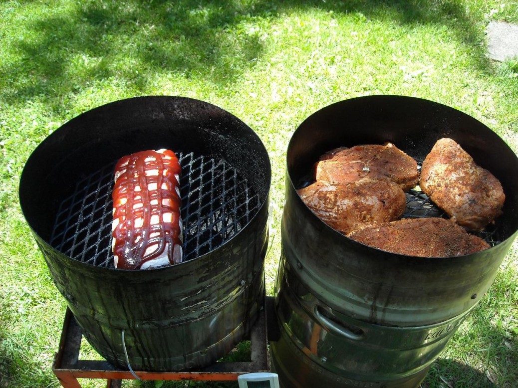

I prefer an offset smoker where the charcoal and smoke wood is in a chamber with a flue to the main smoke chamber. This is probably mostly personal preference, and for was driven by the ability to build the smoker out of two empty half barrel kegs with a section of 4" truck exhaust between them.
Hard to see in the picture, but the kegs were cut below the chines, and the chines flared to allow a slip fit. The center sections are used to hold racks for food to be smoked. They stack on top of each other and the end (not shown) slips on top.
A less expensive alternative is a vertical smoke box with the fire in the bottom and racks for meat above it.
