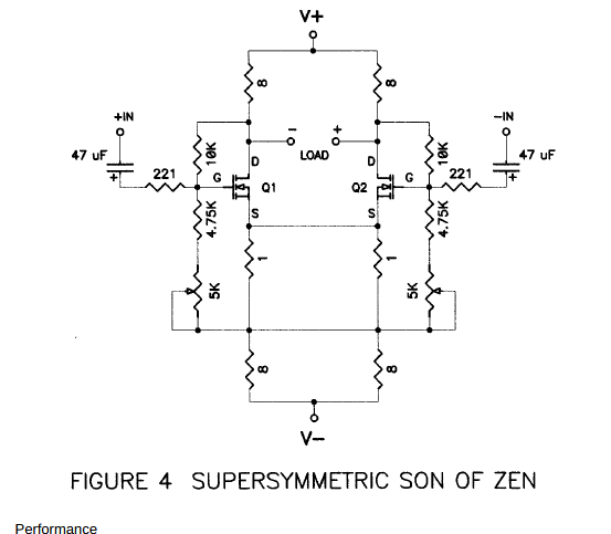

First Watt my way.
Actually puts out 2 Watt with acceptable distortion.
But not much more. Depends on the supply voltage which is 20 Volt single end.

The way to improve that scheme is to increase drive to the output transistors. Make the bootstrap a pair of 82 ohm resistors and U2 one of those old D40K type darlingtons.
EF2 has a larger crossover region, period. Unless first stage of it stays in class A. Also robs 2 Vbe. When those two vbe are a significant fraction of the supply voltage, you may not want to part with them. Running off 6-12 volts, EF1 is the way to go unless you are trying to drive 2 ohms or something. Unless you can find a nice pair of Ge’s and can make or find a totem pole driver transformer. I had a number of old car radios that did that - and they played cleaner than any modern (non-high-power) ones using those stupid chiplifiers. I mentioned I found a way to make those sound good, but damn it generates heat.
