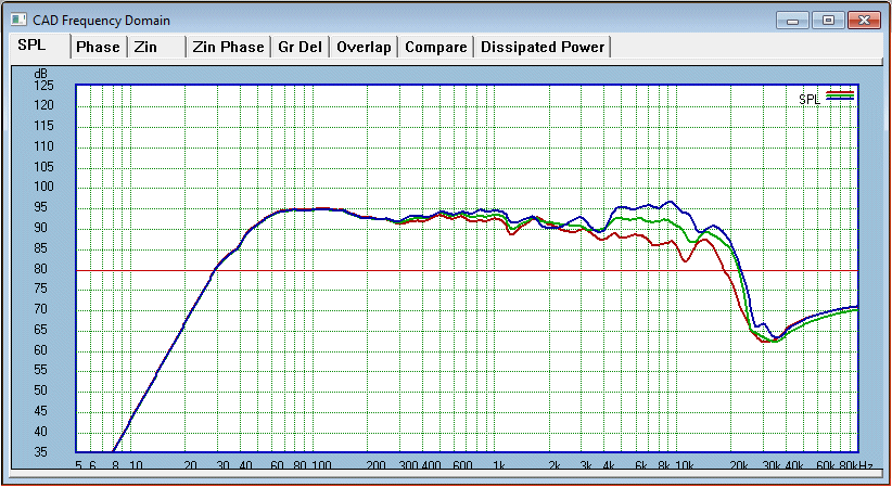

Here is a family of modeled responses, see below.
All at 2 Metres and Blue "O" on axis, Green "15" off axis and Red "30" of axis.
It suggest that toe in can be quite critical and around 20 degrees may be the smoothest.
Please ignore plotting above 30 KHz.
Cheers, Joe

Joe, have you attenuated the breakup node? That 4-10khz response rise lines up with the breakup node on the sb drivers
It's not exactly what it looks like.
They are accentuated by the fact that this driver has very low inductance and hence looks to be at disadvantaged compared to most others drivers but a few. It looks worse than it is. The CSD plots don't show up any significant modes where the straight FR response would seem to indicate.
Just please trust me on this for now, the gremlins you may imagine and the gremlins I want to avoid, seem to be different.

BTW, and this was true with Mark 5 and even more so with Mark 6, that the toe-in is far more critical than more conventional designs. I recommend listening 15-20 degrees off axis. If the room is on the dead side, then toe more in towards the listener and vice versa.
I now realise I should have emphasized this much more when Mark 5 came out and I will now be more emphatic about it with Mark 6.

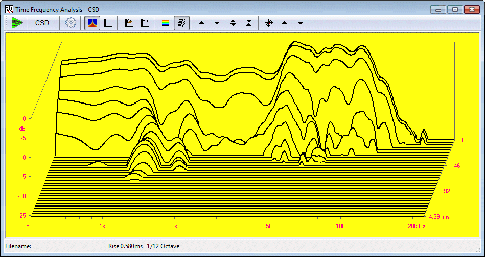

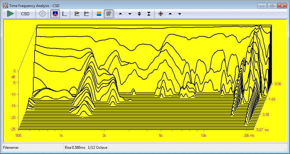

PS: Please see CSD plot below - very rigid fibre cones and aberrant modes at 14.3KHz and 19KHz - high enough not to be a worry - I believe that CSD plot goes some way to explain what I am hearing. Very stiff and clean cone that pushes modes up and gets emphasised at a higher frequency. It seems to get the right result where it is needed.
Please also note that the non-Referenced CSD plot is clean.

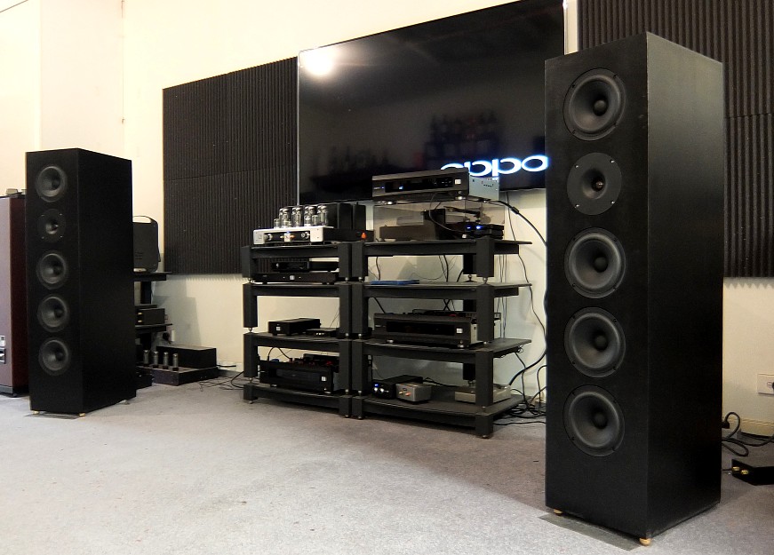

Please see the picture below - these will belong to Paris as soon as a second pair is done, he will be picking them on. I need then to have mine working as guests coming need to see and hear a working pair. Mine are a older pair upgraded to Mk6 - they are a pair with the older square Waveguides.
Once that is done, then the first thing posted will be the new Crossover. We are now talking days.
Anyone in the vicinity are welcome to come around for a listen. Those who have so far have been mighty impressed - that is all I want to say for now as far as sound quality - the ones that build the Mk6 from scratch and those that upgrade the older Mk5, let them have a say from a fresh viewpoint without too much telegraphing from me.

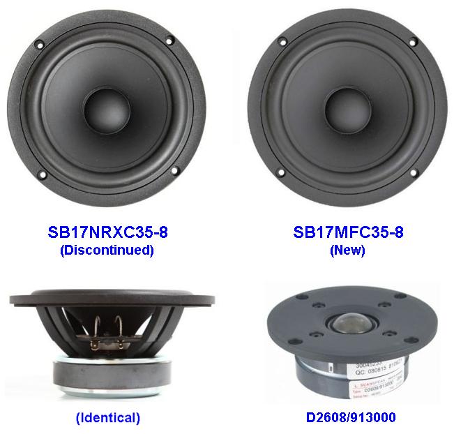

ANNOUNCING ELSINORE MARK 6 DETAILS:
We start with the Heart of the Elsinore Speaker:
As can be seen, the old Mark 5 Crossover can be changed- please look at the 'asterisks' where the values have differed. Note that while 20mH is specified, if you have 18mh then keep them, but do not go above or below those two values.
The of big difference and maybe the most problematic for upgrading old Mark 5 to Mark 6 - the new SB Acoustics Mid/Bass drivers needs to be recessed - the recess required is 7mm and out diameter 174mm - the same actual cut-out of 146mm is the same as before:

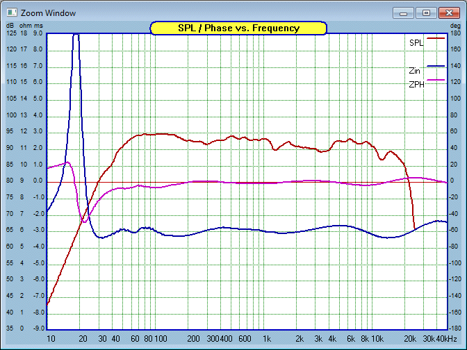

Note these are modeled results, now for the actual measurements:
I do not believe any commercial speakers measure like that when it comes to system impedance and electrical current phase angle.

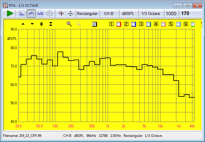

Now an in-room response using Pink Noise and 1/3rd Octave RTA - please not this includes the room in the response and at the listening position:
Below 1KHz, the peaks and troughs, which are also related to room modes, to nicely even out - and note the bass response is flat down to at least 30 Hertz.

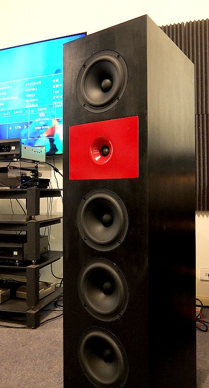

Now of course the obligatory picture of the drivers:
Finally:
Finally:

I can assure you that you will see commercial speakers with such flat impedance and phase. It is my beleif that is the way it should be.

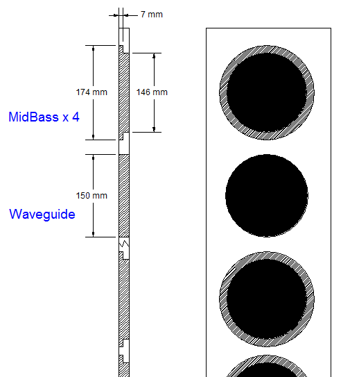

Elsinore Mark 6 Addendum:

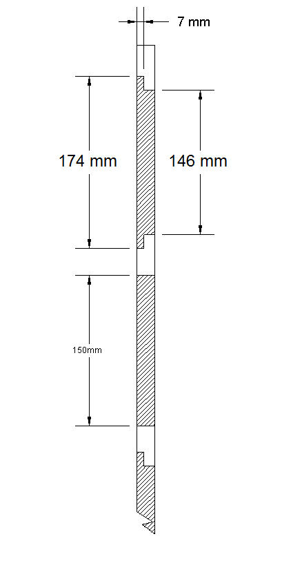

Many will have the same problem that I had, Mark 5 or earlier box and to bring them up-to-date.
With the HDS 6.5" drivers, if they were not recessed into the box, if the hole of 146mm were just cut and then the basket/flange of the drivers covering up the edges, then this solution I used is for you to consider.
If you recessed them, them you would need a filler - I would use a type used for cars - in different countries they have different names for them, like some call it bog filler. It is essentially a filler that you add a small amount of hardener to - and you only have a few minutes to apply.

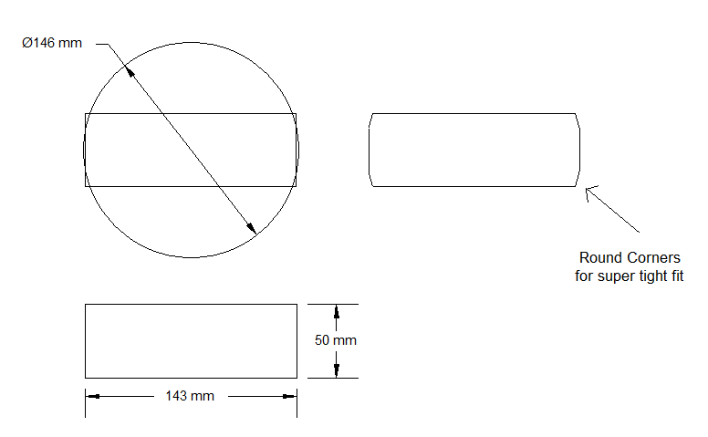

The solution is to make a "bridge" that can sit across the hole - it needs to be very tight, and use a bit of wood glue to set it in well. Then we need to find the middle of the hole and mark it on the "bridge" - and this will be what the centre of the route jig will use for a diameter off 174mm and 7mm deep, see diagrams below.
These are the recess dimensions:

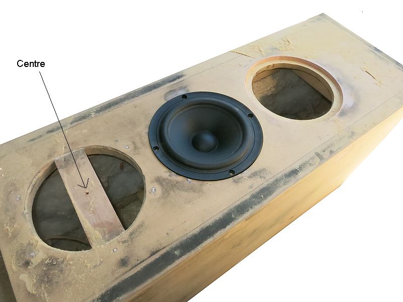

The work in progress:
Here two have already been done and the third is ready for the router.
Here are the dimensions of the "bridge" I used:
I only shave just enough of the corners with a rasp, to make it a super tight fit and literally used a hammer to make it fit.
The bridge should be just flush and if anything slightly lower and it must not protrude beyond the front panel.
I used a Jasper jig. Some are able to k=make their own - it's up to you - but work slowly and carefully and you will get there.
Here is what they finally looked like:

Hi Joe,
Did the new rebate for the speakers remove the old speaker screw holes.
Or do they need to be bogged up before routing.
By calculation its a close call.
Also if 2 x 10mh with rcd of 3.6R was used could the resistor be eliminated.
Cheers
