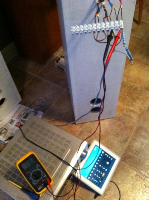

I am cowboy, i finally found my saddles....21 & 69 Hz with the help on a little bit of more load in series with the speaker cable.
But the lowest value seem to be strangely low, 27 Hz.
I use two vents ID70 at this point 160mm length which should be equivalent to one vent 105mm ID90 according to the WinISD0.44Beta I have been using. Calculating backward from PeteFrontiers 105mm ID90 vent and 33Hz the program says a 100 liters box.
Calculating 27Hz, 2 x 160mm ID70 i get a box size of 148 liters. 50% more than it "should be". Reading some posts here i get the feeling that the stuffing of the box does not change the resonance frequency that much but maybe it doe in my case. 25mm of soft glasswool afround the cabinet and most of the part behind the stringer loosely stuffed with lambswool behind a polyester "cloth", the area around the vents unfilled.
Maybe I anyway should start to unfill the box, as i dont want it to be too damped to loose efficiency...
Guidance?

The internal size of the Elsinore box ex speakers etc would be something like 78 liters. Looking at the figures in the thread with port sizes like 90mmID by length 105mm etc calls for a box size of 101 (up to 108 from other figures) liters. The stuffing should not do that much. Explanation anyone, are the figuers on the Peerless elements wrong or what?
The internal size of the Elsinore box ex speakers etc would be something like 78 liters... calls for a box size of 101 (up to 108 from other figures) liters. The stuffing should not do that much. Explanation anyone, are the figures on the Peerless elements wrong or what?
No, this is entirely intended. The Elsinores are not a classically 'lined' enclosure and more resistive as a result - it will slow down the internal velocity and make the enclosure look larger than it really is. Quite a lot larger in fact.
What is not usually understood well, and is a curious fact, that the box tuning of the vented/reflex box is entirely down to the box and is totally independent to the drivers used. So that any driver fitted to that box, the alignment will indeed change but not the box tuning frequency. So if it is 33 Hertz it will always stay 33 hertz, but the response may of course be entirely different. Sealed boxes are different, where the single peak in the box tuning is dependent on both the driver and box volume. But with vented enclosures, the saddle tuning frequency is independent of the drivers. Not the peaks above and below the saddle, they will change with drivers.
So this is a major difference between vented and sealed boxes - and it also explains why vented boxes are more flexible and also explains why it can also go wrong so much more easily. Talk about a double-edged sword.
Cheers, Joe

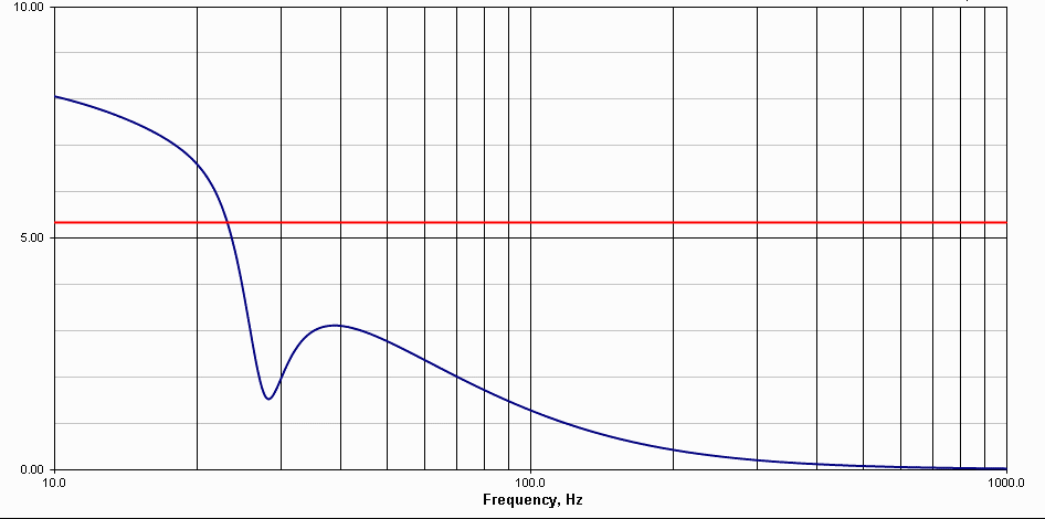

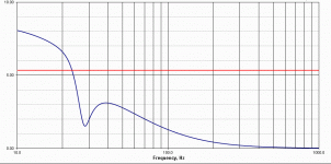

There is one other method you can use to determine your vented enclosure tuning if you don't have a microphone measurement system. It is a visual method in which you look at the motion of the woofer cones as you sweep up and down in frequency in the 20hz - 50Hz range. At the tuning frequency of the enclosure the woofers are loaded by the Helmholtz resonance and there is a dip in the woofer excursion-vs-frequency curve.
Example excursion curve attached below...
To make it easier to observe the cone motion, I usual stick a small piece of white masking tape on the cone or dust cap. Then just turn up the volume on your sine wave sweeps until you can clearly see woofer cone motion above and below the minimum at the enclosure turning frequency.
