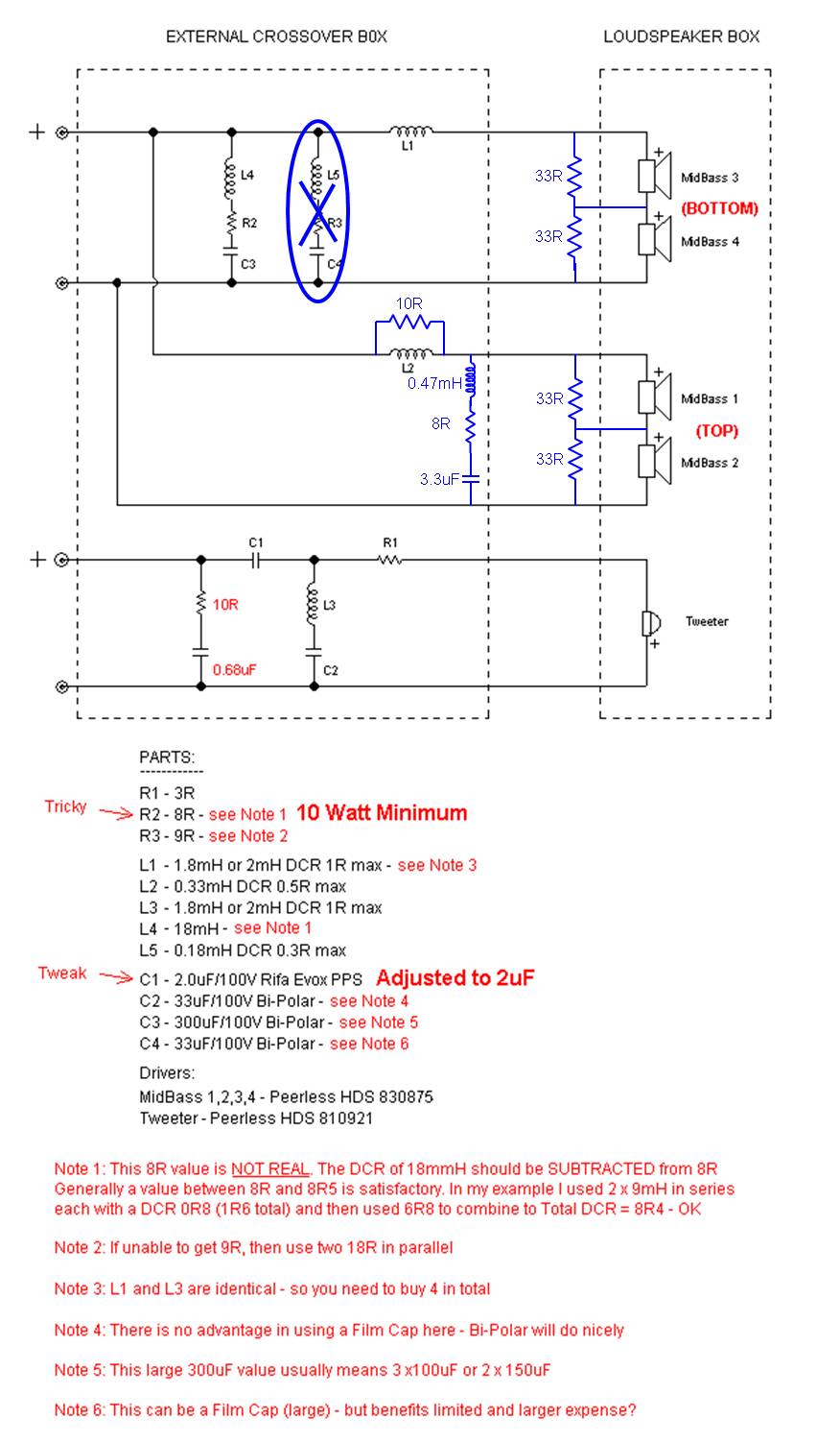

This is the schema of Boelster's mod
L2 in the Crossover will be a much larger value. L1 is likely to be similar. I am hoping C1 will stay the same, and everything else in unknown, but I hope to keep things as close to what we have already and make the changes to Mk5 Crossovers as painless as possible. Also, I am hoping with this new driver there will be no need for those additional components Bolser added to the MidBass.

Project restarted. Measured my Elsinore today with exactly the set up in post 1506. An Ipad w sinus generator connected to a retired home theatre reciever connected to the base/mid elements (2 in serie in parallell to 2 in serie) in series with 10 ohm resistance (3x3,3ohm in series). Easy peasy
BUT NO SADDLE measured on the AC meeter. Maybe maybe there is a top peak at 71 Hz but downwards there are only lower values.
There are also lower sound levels downwards so maybe the set up does not work at all. Error source could be the frequense response both in the Ipad and in the reciever or?
Ok, Funny
There are no "lowest value" between any peaks. Just lower and lower values as the sinus generator is to lower Hz.....
Please trust me on this one - the reason you don't see a conventional saddle is because the system has current equalization - the only way you can find the bottom of that saddle is with a nearfield (microphone) measurement on the port and look for maximum output - that will be the frequency of the box tuning. You won't be able to find it on the electrical side, only on the acoustic side (and yes, nobody else is doing this and hence it looks foreign). There are reasons for this that I can't say too much now except it is done for good reasons. Some time in the future this will be elaborated on as the effect is not just on the speaker box alignment, but also on the crossover.
Cheers, Joe

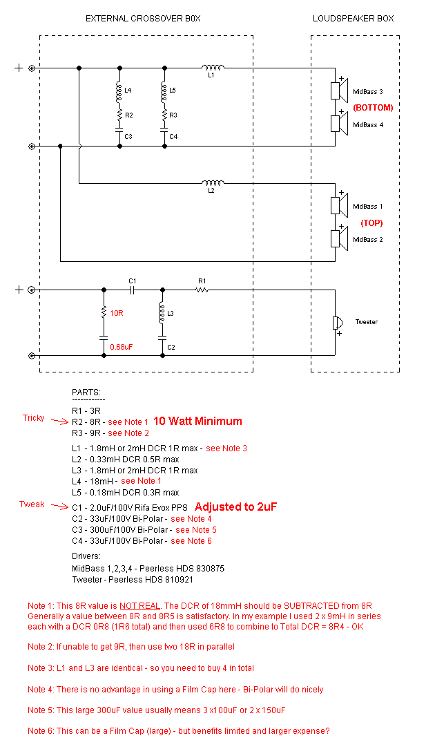

If you already have the crossovers wired up, the easiest thing to do is lift the connection from L2, R4, or C3 to effectively remove the impedance flattening(ie current equalizantion) that Joe engineered into the crossover. You should then find the peak-dip-peak in the impedance curve without difficulty.
See jdkJake results from similar effort in post#1254
http://www.diyaudio.com/forums/multi-way/97043-elsinore-project-thread-126.html#post3132869
Yes, you can do that too. Compare that network with what Dave Wilson does in his "anti-jitter" crossovers where he just puts a shunt resistor across the voice coil to flatten the impedance - rather crude (not him though 🙂) in comparison, but each to his own.
