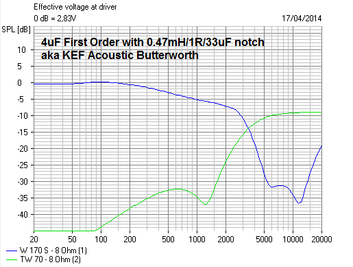

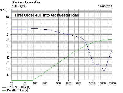

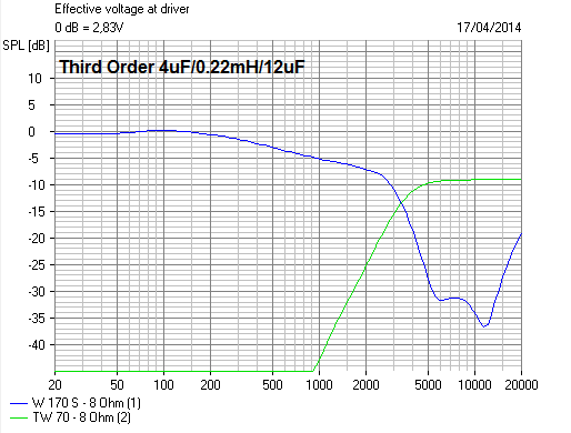

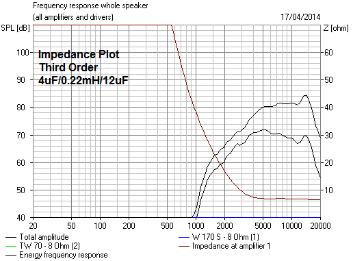

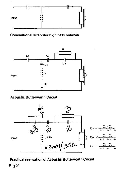

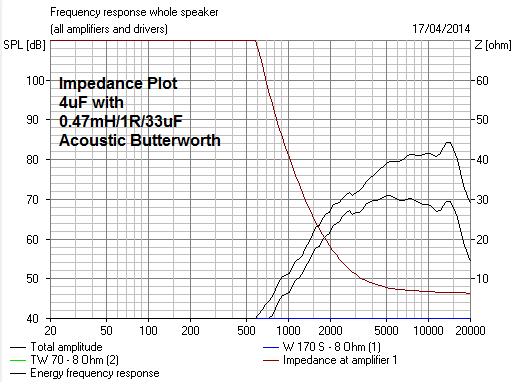

Joe, I am loving this thread of yours, and I think you are onto something with your SB Acoustics low inductance drivers, simple small value filters and a flat impedance. The best threads make you THINK! 😎
But I want to rain on your parade a bit, and maybe help you take something into consideration. I had a good ding dong with MarkK about his First order plus Fs notch tweeter circuit in the ER18DXT. I said he would do much better to use a third order butterworth. I'm going to justify that here.
There's a problem with notches, whether at tweeter Fs or at the top end of woofers' natural 3-6kHz cone resonance. They spoil the natural rolloff even if they improve phase alignment.
Below are some simulations with a tweeter Fs around 1.3kHz. My conclusion is inescapable. Third Order butterworth lets through far less low frequencies than a first order plus Fs notch, which means lower intermodulation distortion. Having built KEF Acoustic Butterworth notch filters, thinking they would be near perfect, I actually found they sounded horrible. What they are really, is "First Order Improved", especially on phase and suppression of the Fs resonance. Improved to the point where you can actually hear how horrible first order filters generally are! 😱
What is interesting is that notches generally aren't needed to align phase when you time align the drivers. Which might be something to consider. 🙂
