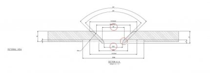

Lost radius on WG
Hi, looking aorund the posts about details for the WG (mostly around #694-718..) I am still having a small trouble. The radius on the outer part of the trumpet is said to be 16mm which looks fine with th measures and lines on the drawing.
The inner curve radius down to the hole does not have a value. The inner diameter is said to be 32mm and there is value 38mm which seem to be the other end (at 45dgr) of the curve. BUT this does not fit. 32 and 38mm will state a radius of 10,24mm which does not fit in the position if the bottom of the hole should be vertical as seen in the picture and match the 45 dgr trumpet.
So either one of those measure are not correct or the inner end of the trumpet is not vertical. Anyone to know from the construction or a real WG? Is this critical.
If we have a vertical end of the trumpet, use a 7,8mm radius on the curve it will fit with a 36,8mm value to the 45dgr part of the trumpet. Would that due?
