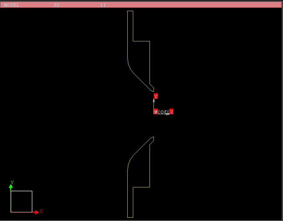

Fitting of Waveguide to Element
Looking at the drawing of the waveguide and reading a vast number of post there seem to be a gap between the inside lower part of the waveguide hole and the element. A gap that partly (or all together in some posts) are filled with gaskets, rubber mass of different kinds.
Now when we are about to produce a mould for at least producing 4for sets of waveguides that are about to be built in Sweden right now, itwould be interesting to hear if there is a slight change that should be done to create "the perfect gap" with the waveguide solid towards the element to create one "solid piece"???
Suggestions anyone? Joel?

The original had a pocket to alow the tweeter to mount to cabinet and waveguide over that.. The gasket thingy was to fill pocket and mount tweeter directly to the waveguide..
As for creating a gap at the vibrating element for a different sonic characteristic it has to be heard to be appreciated and then it becomes personal choice as I thought the gaped sound was very good and not wrong but ended up with no gap.. With no gap there's still a slight gap because of the slope in the tweeter plate face and this gap is filled with putty..
I was thinking about extending the projection and matching the tweeter slope but thought everything has to be perfect otherwise it could end up raised where the two mounting surfaced need to meet.. So putty made more sense if you know what I mean..
The element gaping gives a less rich and detailed controlled treble that has less room effect and gives good off axis listening soundsatge..
No gap is richer with more detail, hence more energy into the room.. Need to set up nearfield position more carefully and trap first reflections.. The farfield is really good when all the energy has distance to propagate..

Would it be possible to descibe in a scetch how the 2-3 different positions of the (non)gap would look like with the current waveguide? As we have located at least one lathe (maybe more) closer than I thought (one of my friends job) that could do the job we might end up with different molds for different sound preferences.... (Off course we are back in the old days - work payment in, not carrots, but Wave guides :) )

I use the free google sketch up sometimes but for me to make a good representation will be hard..
The drawing is my waveguide now and the tweeter mounting plate mounts flush with the back of the waveguide.. The tweeter mounting plate diameter is slightly smaller than the back shelf diameter of the waveguide..
The projection is 0.1mm from touching the slope on the tweeter plate..
To create one's personal GAP up to say 1.5mm use spacers when mounting the tweeter..
BTW: The sound characteristics with a gap is whithout putty so there is an actual space.. Maybe the vibrations at domes large area are being trapped.
Also something to consider is if the woofers are sunk 4mm.. Mine are sunk so gapping 1.5mm puts the tweeter at 15.5mm from woofers.. If woofers are not sunk then gapping 1.5mm puts the tweeter 19.5mm from the woofers..
So I also be wondering if the others that enjoyed the gap have sunk or not sunk woofers.. Just mentioning this because the design alows for sinking the woofers 4mm and only affects Time Alignment inside 1.6m so that puts the tweeter(no gap) at 14mm behind woofers..
Joel

Ok. So there is almost a perfect match. 0,1 mm is not much, just enough for some glue....
BUT, using spacers will create a little pocket between the wg and the tw, just not only a little gap. Making a wg with some other design of the lower inside part closest to the tw just create a small thin gap but no pocket so that will be something else than using spacers - and possibly a different sound. Hmm i guess i have to test when I finally get my pair going. Thanks for the info
