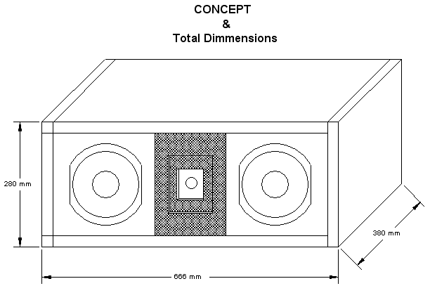

Hi Joe,
After thinking about this, here is a thought.
Please consider designing/modeling it with the "height" of the center channel as small as possible so that it could fit as support/base under the TV. I.e. make the width ( heigth if laid on the side) less than the width of the Elsinores.
Ideally a center channel would serve as base for the panel TV to be supported by, on top of a conventional "media center". So, I think an enclosure for Hamlet would be around 160 mm heigh, 350 mm deep and as wide as nessary.
MHO, what do others think?

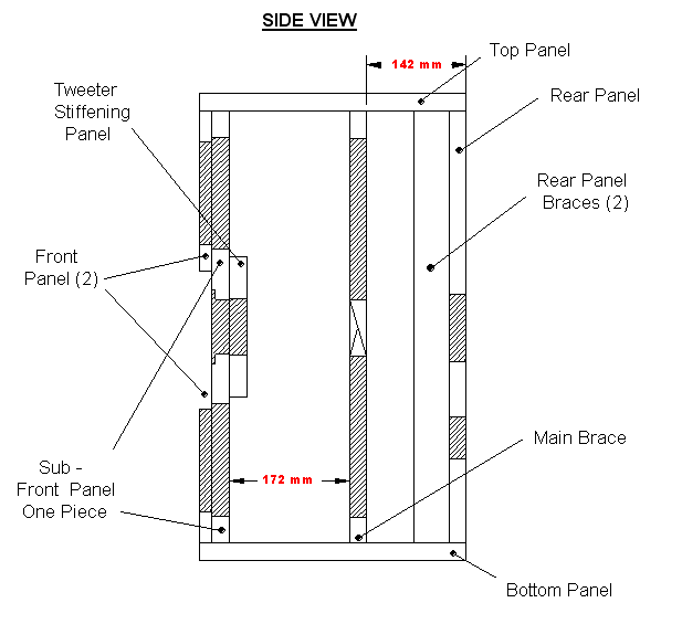

Hi Francois, the boxes have already been made and shown in Post #1402. It's a chunky box because it has the same width (when looked at upright) and depth, only the height is smaller than Elsinores. So it based very much on the Elsinores, even dimension wise.
Just received a delivery, small box. Suspect there are a pair of Tweeters inside.
Cheers, Joe R.
I disagree. A center channel generally needs to be free to be directed optimally at the listening position. This cannot be done when the center channel is used as support/base for a panel TV. Depending upon the distance and height of the center channel with respect to the user, there is considerable possible placement and angle variations that need to be performed to obtain the best performance.
Personally, I would never rest anything on top of any speaker. My flat panel is mounted on a articulating arm attached to the wall and "floats" above my amps/sources. My center channel rests on top of a device called a center channel director that allows the angle of the front bezel to be set appropriately directed to the listening position.
I think the hamlet box design is fine as it is and presents maximum flexibility in terms of use as a stereo pair as well as LCR and rear-channel duties. It does not exist as a purely single purpose design, i.e. a center channel.
Hi Joe, Yes that is the easy way but,
Sorry, I'm asking to do it the right way rather than the easy way.
Perhaps what you consider the right way is limited by your personal perspective and intended use for the design.
I contend your perspective of right does not necessarily reflect my perspective of right. 😉
Nothing says you cannot build the box to address your intended application. As long as the internal dimensions are held constant, I see no reason why it would not perform similarly considering how you plan to use it. The front bezel and side baffle performance will most likely be overwhelmed by reflections coming off the flat piece of glass sitting on top of it. With no way of correcting placement angle and focusing directivity to the listener, performance will always be compromised anyway.
