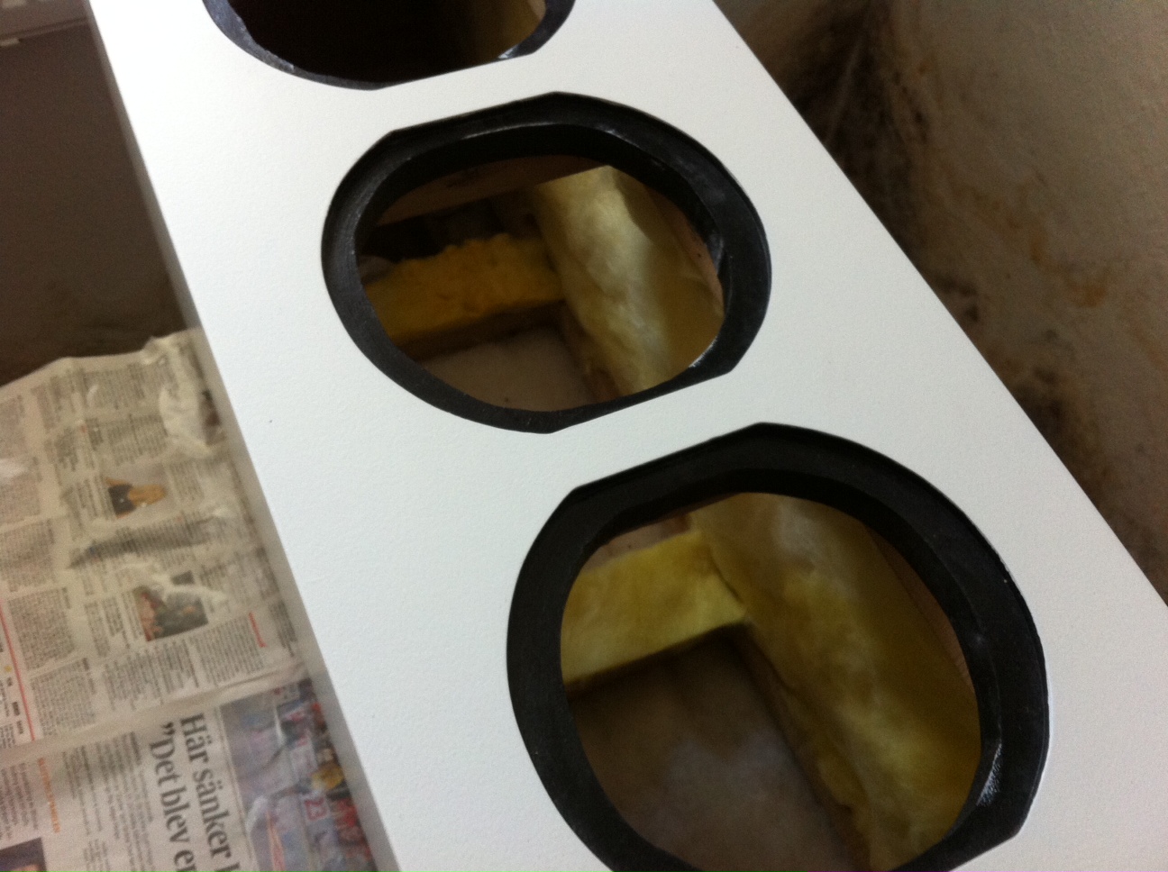

When it comes to damping the investigations with two proffesional speaker producers have ended up in two options. Either just all soft glasfibee house insulation or some lambs wool at the far back of the box, covered with insulation. Polyester have been tested seriously in a big test here in Sweden years ago and not found usable at all (didn't know about it until just recently).
I think that makes it easier for all of us as we haven't found any good stuff yet.

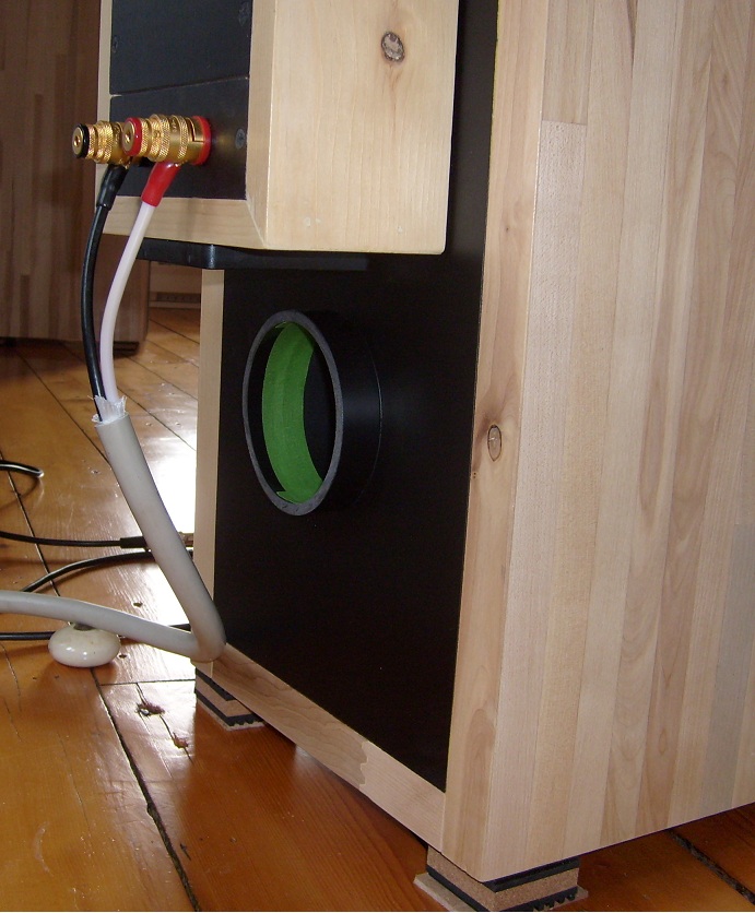

Yes I do. I was sceptical about getting improvement with lowering Fb from 35 to 33Hz, but this definitely worth the effort. There is more impact on base notes and this is the way I like to hear them.
So what is your latest length of the pipe, something like 110mm for the 33Hz?
I agree. I think the 33hz tuning works the best. A least for my space and listening preferences.
I tried everything from 31~32 Hz to 36hz and found the 33hz tuning the most subjectively satisfying. For my particular box construction, which was a few millimeters short in height, I added 15mm. So, I think it is most important to try to either measure your results or listen to the various lengths for a period of time to make a final decision.
The lenght of the pipe is now 105mm, ID is 90mm. The temporary solution is not elegant but was very quick to implement 🙂

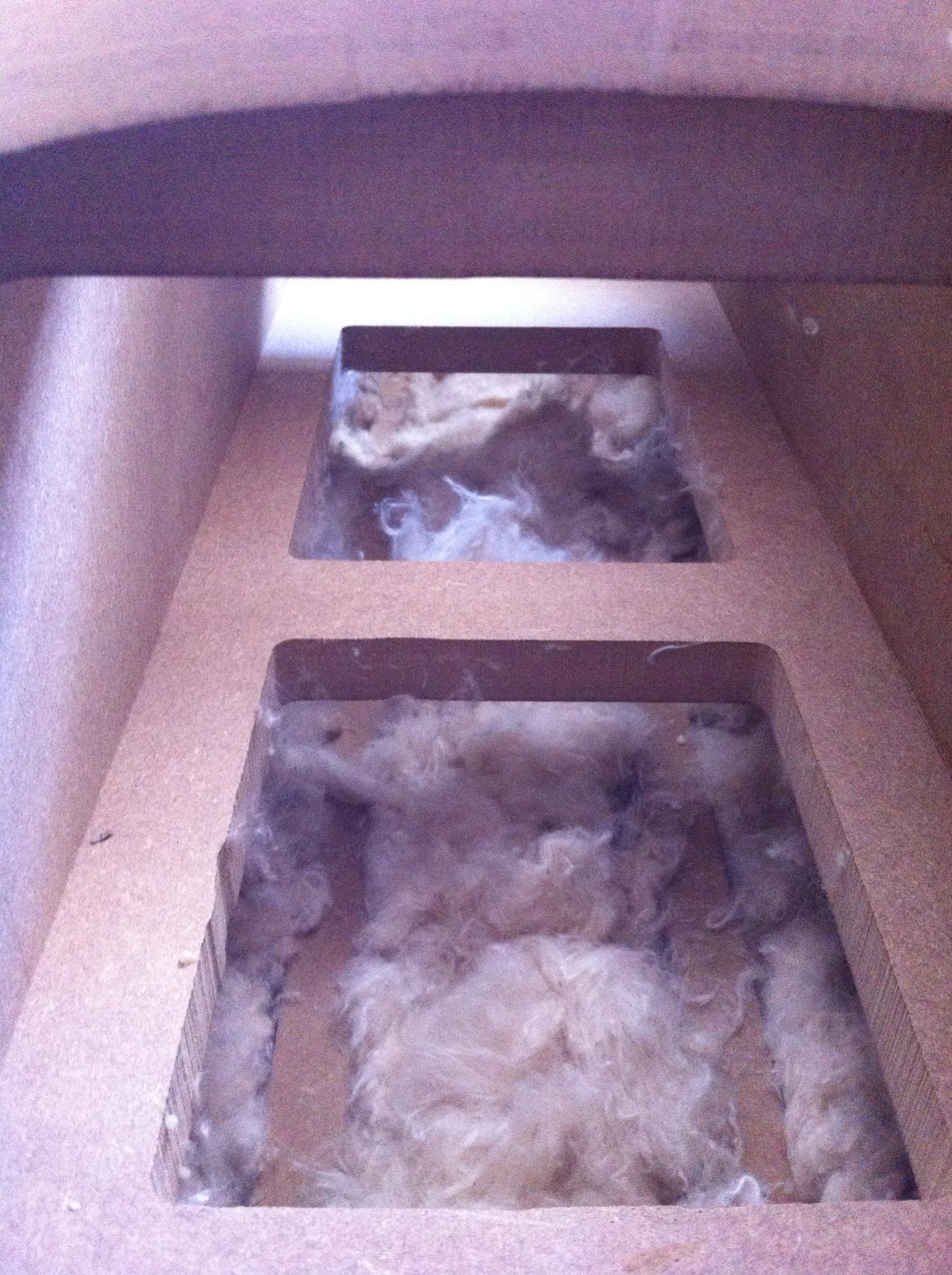

Well aged Audio lambs wool from the late 70s come in handy (and some leftover Aqusto-Q, the hoppest speaker damping material at that time).
Filling the rear part with the wool, very airy/fluffy. I might stuff the "rear compartment" from the top and 75% down with the "fluffy-wool" to start with, for beginning the measuring.
Having fun...

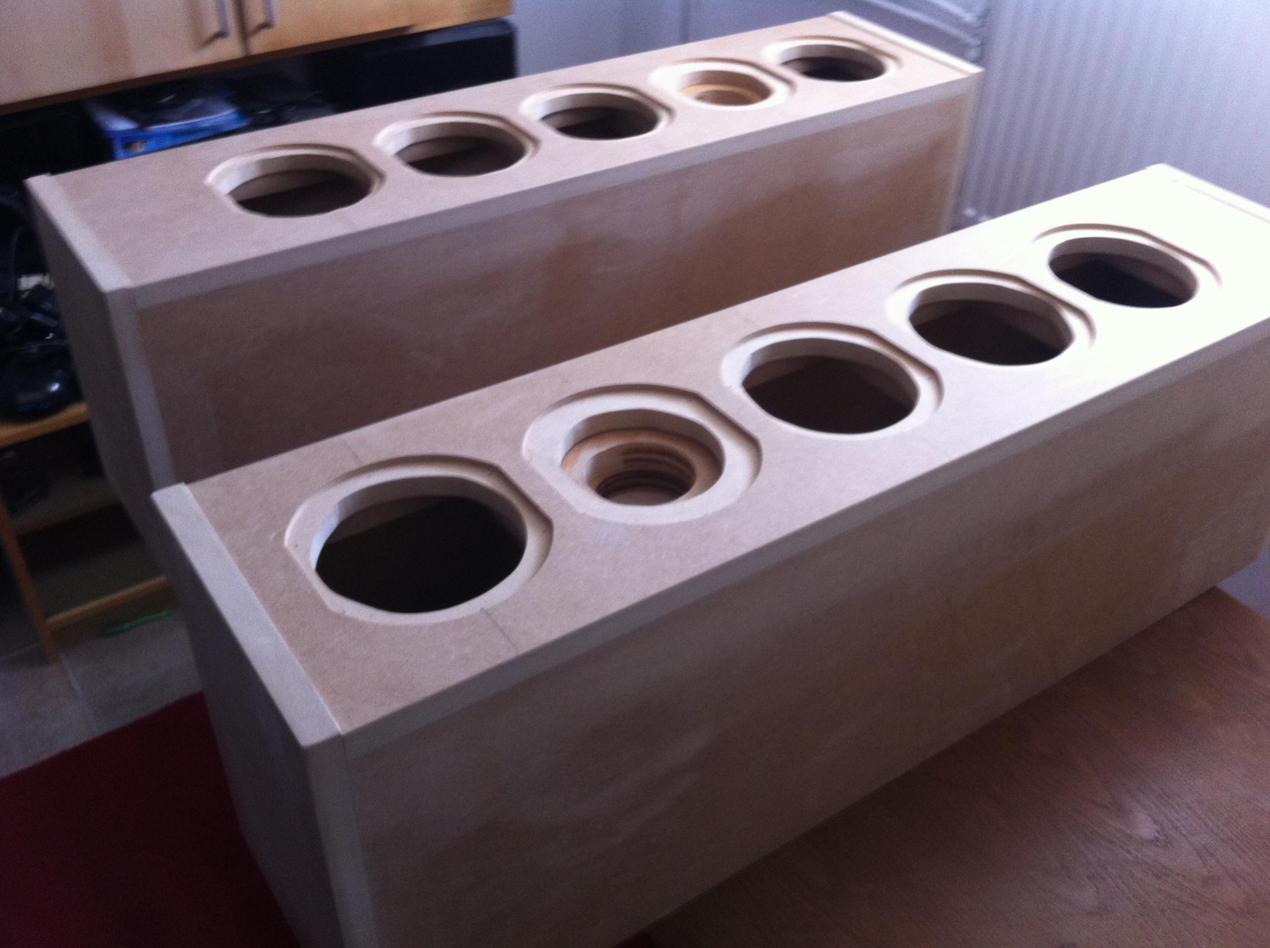

EU-version almost ready to be measured
Almost ready to start measuring the "EU-version" with 2x 75mm (ID68) plumbing pipes. Wool in the back compartment, glass wool on the front compartment walls and on all of the stiffening panel (reflections should not be an issue here). 160mm will be the start, as the pre-calculation said 145mm. The pipe holes was deliberately drilled sliightly to big and adjusted with a few layers of print paper strips around the hole to get it perfectly match, round and smooth. Glued with wallpaper glue. That would make it easier to change and adjust the pipes in and out. Just some small ideas.
