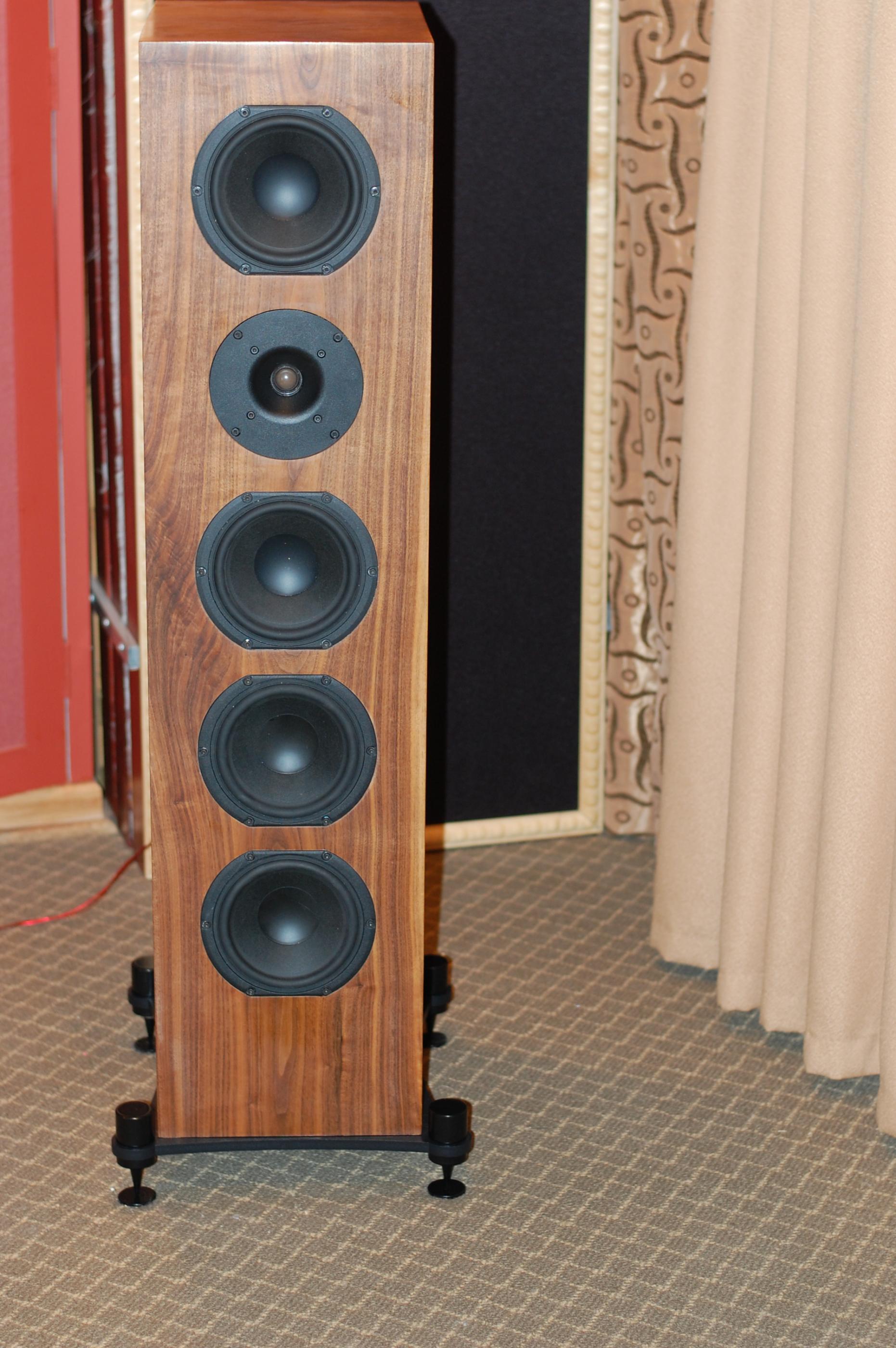

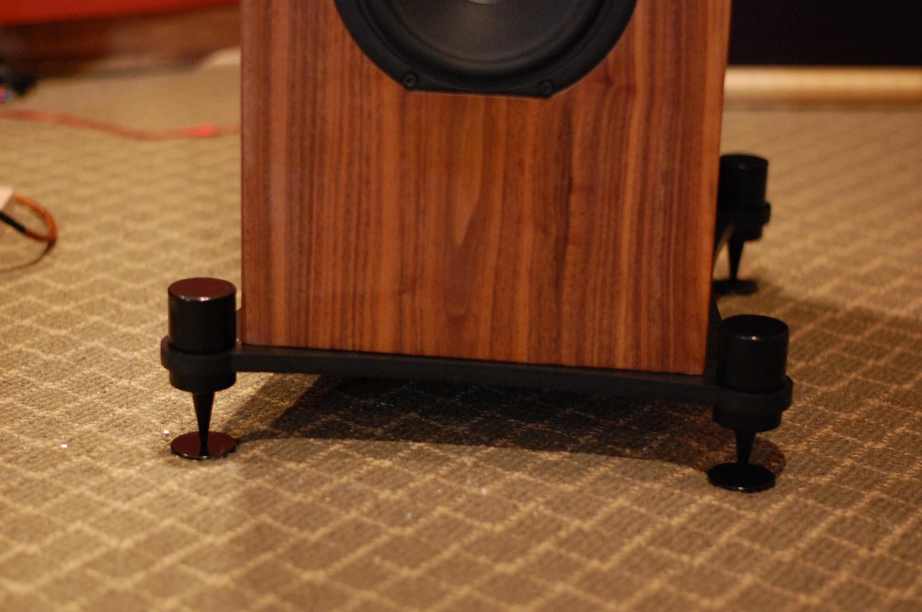

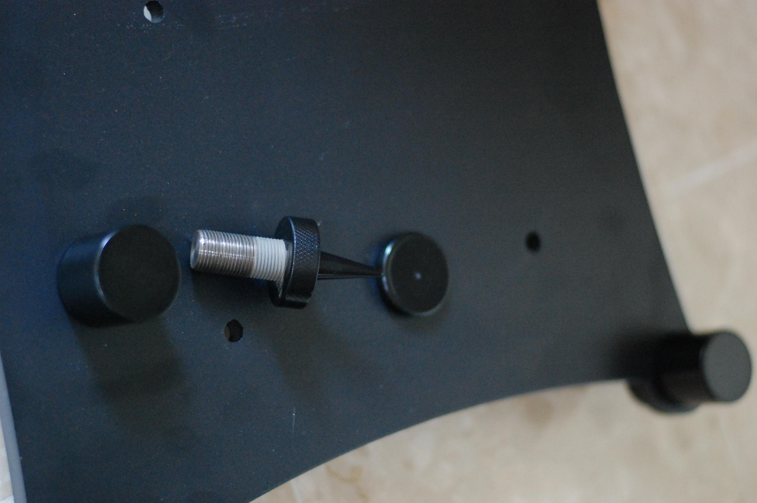

Thought these speakers needed some really good stands so I designed Base and spike system. Base is 1/2" laser cut plate steel. Spike is 3/4" 16 thread with 1/2" adjust.. 34pounds added to each side..
The speaker is much more solidly planted and the entire sound has improved...
If anyone would like these I can do more upon request but rather expensive...

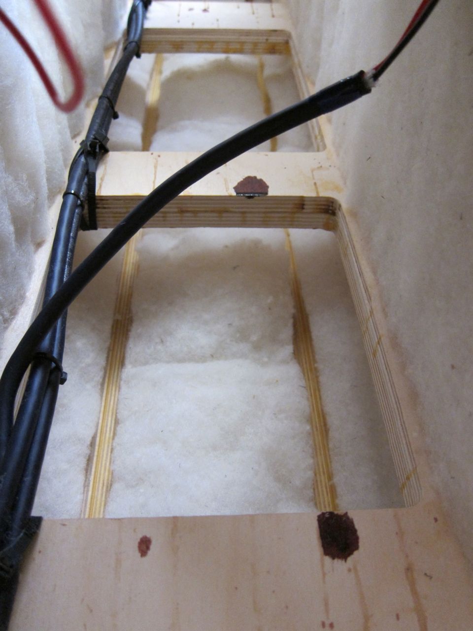

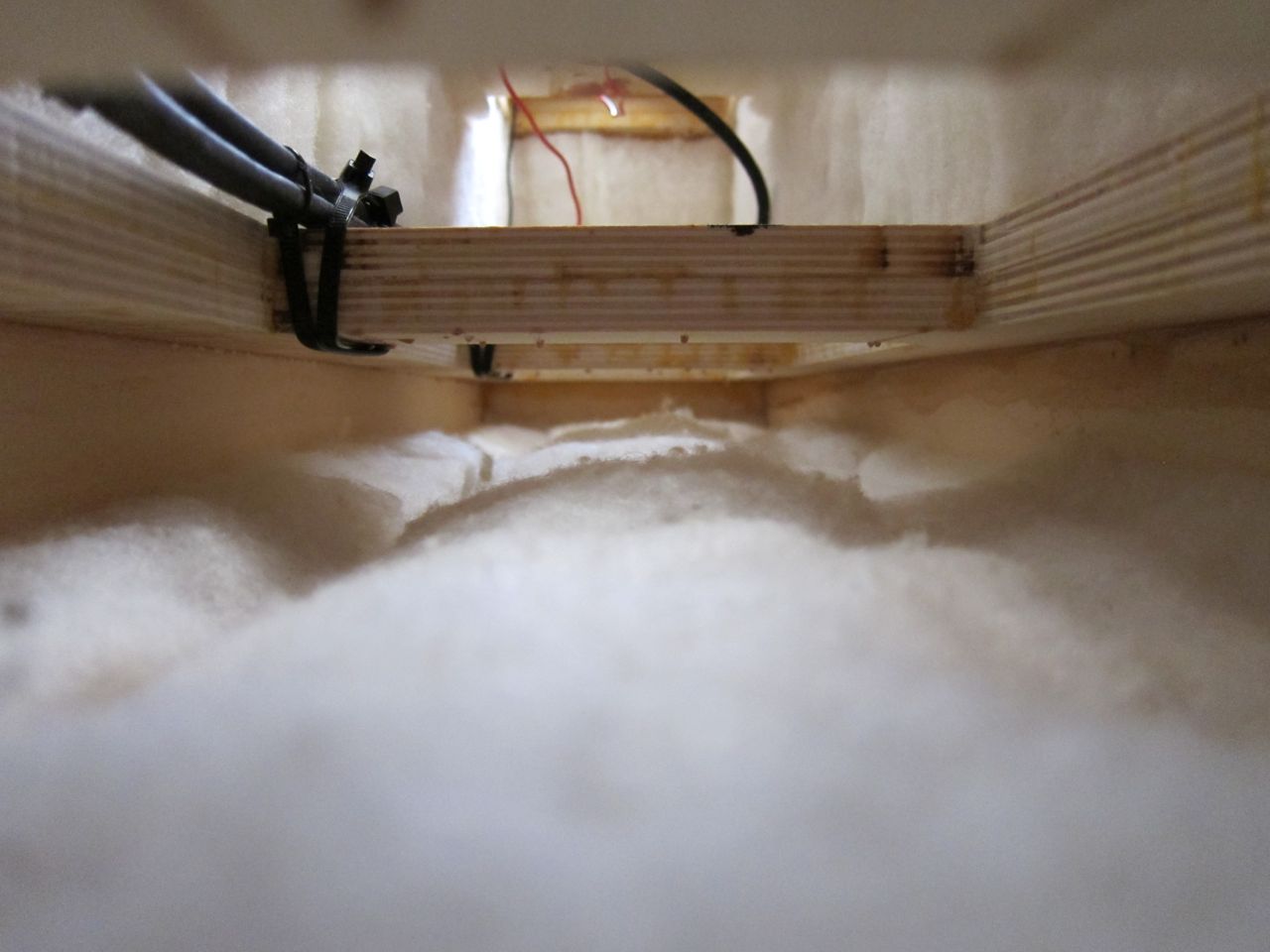

I found that the material I used was also too dense. Replacing it with some experimental, much less dense material, made a huge difference to the LF output. I have since procured some material which I believe much more closely approximates the density of the wool/polyester material Joe Ras specified in his design. It is a 100% polyester product which is 75mm thick but can be peeled apart for the required thickness. It is made by "Rams Insulation" in Tullamarine Victoria for those who live in Aus. I haven't had a chance yet to pull them apart again to install it. I'll keep you posted on the results when I do. By the way I used the 90mm diameter port (storm water pipe) as specified by Joe. It's available at pretty much any hardware store in Australia. Not quite as pretty as a flared port though.
Happy listening.

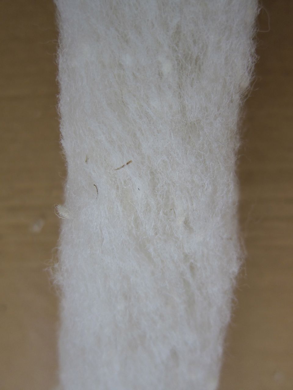

The material I am using is Monacor MDM-3. The material is a 75% wool, 25% polyester blend. When first unrolled, the material is condensed to a depth of ~20mm. A little manipulation is necessary to reach the full 35mm depth the material is designed to be used. At 35mm, the material is very light and airy.
So, I pulled my back panel bats and "fluffed" them up to the 70mm depth possible by a double application of the material. As you can see, the rear panel is now significantly engulfed by the material. I also lightly fluffed the side material just a bit.
As expected, this had the effect of increasing the virtual volume of the enclosure, which, drove down the tuning point. So, while the material is being used correctly, I am still heading in the wrong direction.

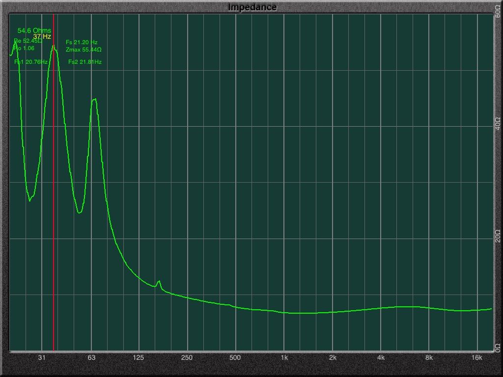

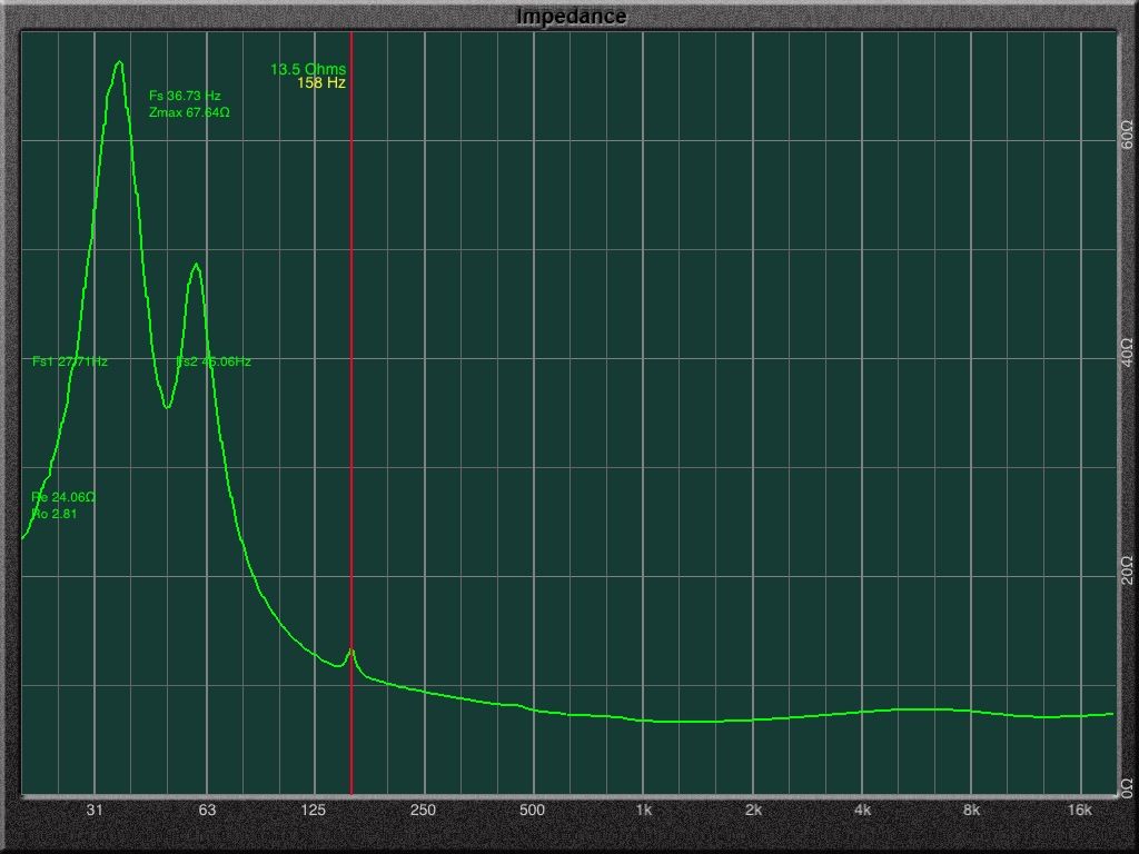

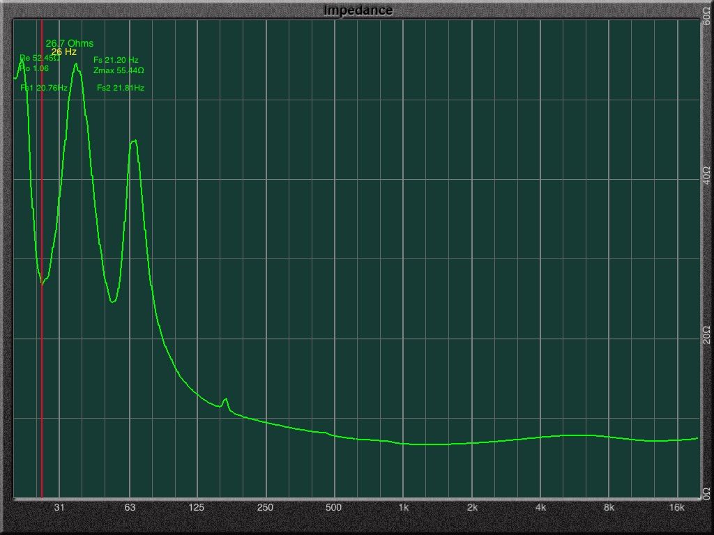

I decided I needed to understand the effect of damping material on the cabinet tuning. So, I broke down and removed ALL of the damping material from the cabinet. I left the port at the original length (~82mm). I then measured the impedance.
The results are pretty much the same as when I started this effort. The first two are the measurement with the port open. The third, with the port sealed. I cannot seem to get any significant tuning change (more than 2Hz or so) regardless of port length or cabinet damping.
As it stands now, it appears the overall volume of the cabinet is too large. That said, there are many things about this measurement I do not understand.
1) Can this measurement technique actually be used for this task? Joe implies this is the case in this post (http://www.diyaudio.com/forums/multi-way/97043-elsinore-project-thread-92.html#post2620798).
2) Why is the third peak present? I have checked and rechecked for leaks, most specifically forcibly sealing the tweeter opening and speakON jack opening to ensure they were not leaking any air. No change. Is this an artifact of the crossover itself? A non-issue? BTW, I am NOT referring to the blip at 158Hz, that is caused by standing waves in the undamped cabinet. I am referring to the peak at ~65Hz.
3) How can the cabinet volume be this far off? If anything, I am slightly short on the height (~5mm), but, the rest of the dimensions should be at least close if not dead-on to the design standard.
So, I am totally stymied at this point on how best to proceed. I can certainly fill and/or line the cabinet to reduce volume, but, is that the best way forward?
Has anyone else taken an impedance measurement of their Mark IV build? I would be curious to see if anyone else is having these types of results.
Comments are welcome and encouraged.

@jdkjake,
Looks like you are measuring impedance with the crossover hooked up.
Can't recall exactly, but I believe the three peak behavior is related to the woofer impedance compensation network.
To see box tuning trends you need to hook straight up to the woofers, no crossover parts.

Thanks for the response bolserst. I did remove L4, R2 and C3 like Joe recommended, but, let the other crossover parts in the circuit. It appears the L4, R2 and C3 combo functions as the main impedance compensation for the lower woofers. That said, it is certainly easy to bypass the crossover altogether. I will give that a shot.
I am also reviewing all of my wiring just to be sure it was not something obvious. So far, everything looks correct. We shall see what things look like with the crossover out of the circuit.
Mystery Solved!!!
I found a wiring error in one of my speakON harnesses. Turns out it was the one I was using to make all the measurements (DOH!!). Turns out that harness did not return negative from the lower drivers. 😱 As such, the lower drivers on the device under test were essentially out of the circuit. Not sure how that happened as I thought I had verified the wiring harness properly both in and out of the cabinet. Nevertheless, a mistake was found and corrected. I also TRIPLE rechecked everything. I am satisfied all is wired as it should be.
Lo and behold, with L2, R4 and C3 out of the circuit, the impedance measurement completes as expected. YEA!! 😀

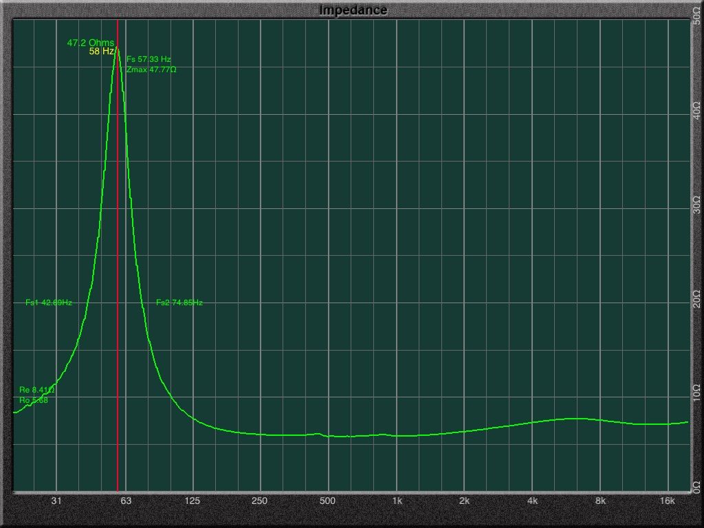

So, using the original port length as well as the cabinet that I did not mess with in terms of damping material, the port tuning is coming in right around 36Hz. Now I need to restore/fluff the damping material properly, measure again and then adjust the port lengths properly.

Aaah, OK. The lower drivers would be acting like passive radiators, loading the upper woofers.
That explains the dip in the impedance curve shown in the 3rd pic from your posting #1251.
