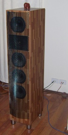

Quick pic of the speaker grilles i am using, I have a two year old son..... I cannot count how many times the speakers have been saved now.......

That is a nice use of that material. Looks very modern.
What did you use to attach the mesh to the speaker?

Yes they look a little like electro statics i think they sound nicer !
I fix the grilles on with small screws through holes in the mesh, i have been meaning to replace them with black screws to match

I cheated with the screws on the waveguide on mine. I removed them and screwed them into a scrap of cardboard. Then I sprayed them with the same mat black paint that I finished the waveguides in. They are almost invisible now and it cost me nothing. I like your veneer. Very interesting and different.
