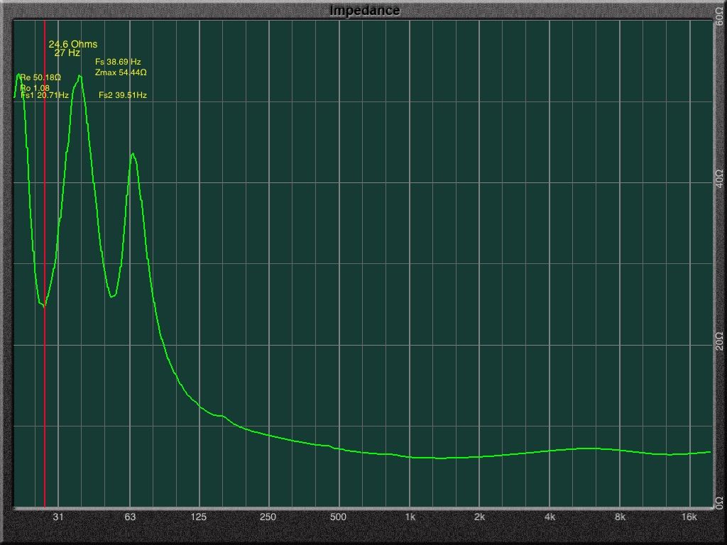

So, I have been listening to the Elsinores for a few weeks now. I have them pretty much aligned properly and the mids and treble, while slightly forward with the amp currently employed, are very, very sweet. Amazing imaging. The bass, well, something is slightly amiss, but, hard to place exactly what. Certainly not as extended as I was expecting.
So, time to break out the measurement tools and see what exactly is going on as I suspect I missed with the port tuning. Sure enough, the measurements tell the story.
The first picture is the impedance using Joe's crossover as designed.
The second picture, is with L4/R2/C3 taken out of the circuit to allow the port tuning to be derived from the impedance measure. The picture shows the port to be around ~27Hz. A bit low from the 33Hz target.

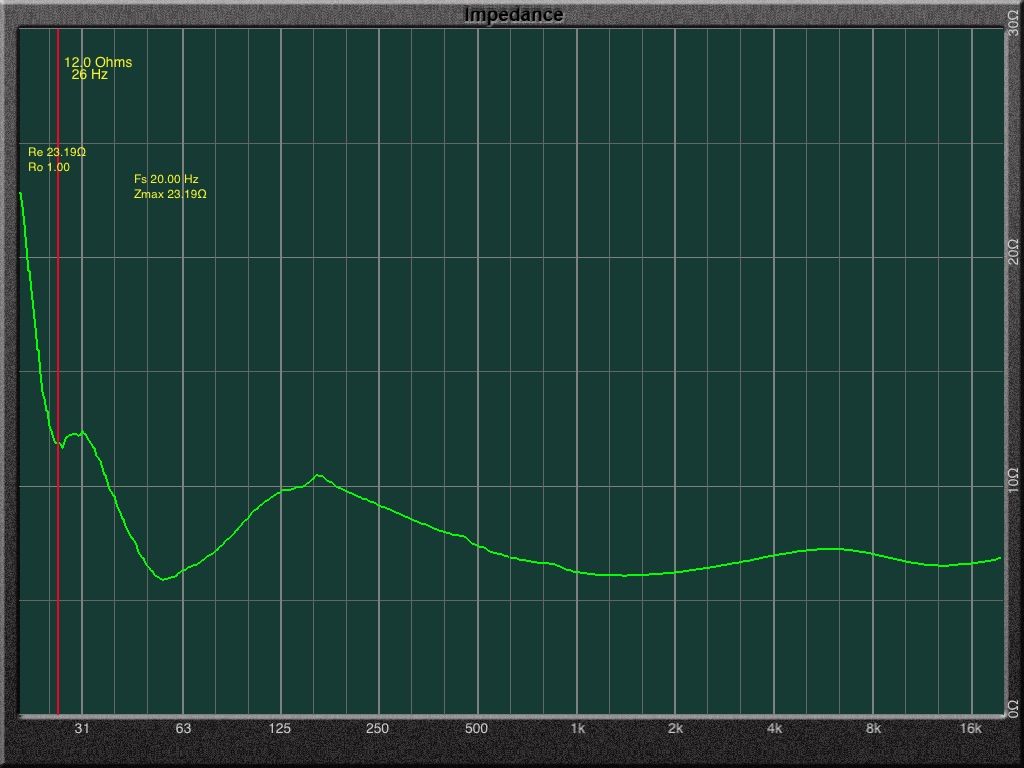

The third picture is with the port sealed. This allowed using a calculation to get a better estimate of the tuning (Fb = SQRT(Fh**2 + Fl**2 - Fc**2). This puts the port to be around ~25hz.
So, looks like I am a bit too long on the port or a bit too much on the dampening material. Either way, I am somewhere around 6 to 8Hz off of the target tuning. I suppose I could try a single layer of dampening material on the back panel vice the double layer currently employed, but, I would be surprised if that moved the tuning quite that much. That said, I am not sure. I lack the experience to say one way or the other.
First, I should probably calculate how much material would need to come off the port given the current amount of dampening material.
Let the finessing begin!

Yeah, I am hesitant to remove any of the dampening material at this time. If I try anything, I would remove one of the layers from the back panel (I have a single layer of material on the sides and a double layer on the back). Although, this is probably the most important panel to dampen properly. As it stand now, my double layer is still slightly thinner than Joe recommends and the side panels slightly thicker. Probably best to leave well enough alone in that area.
While I have the drivers out, I will pop on those 33R resistors.

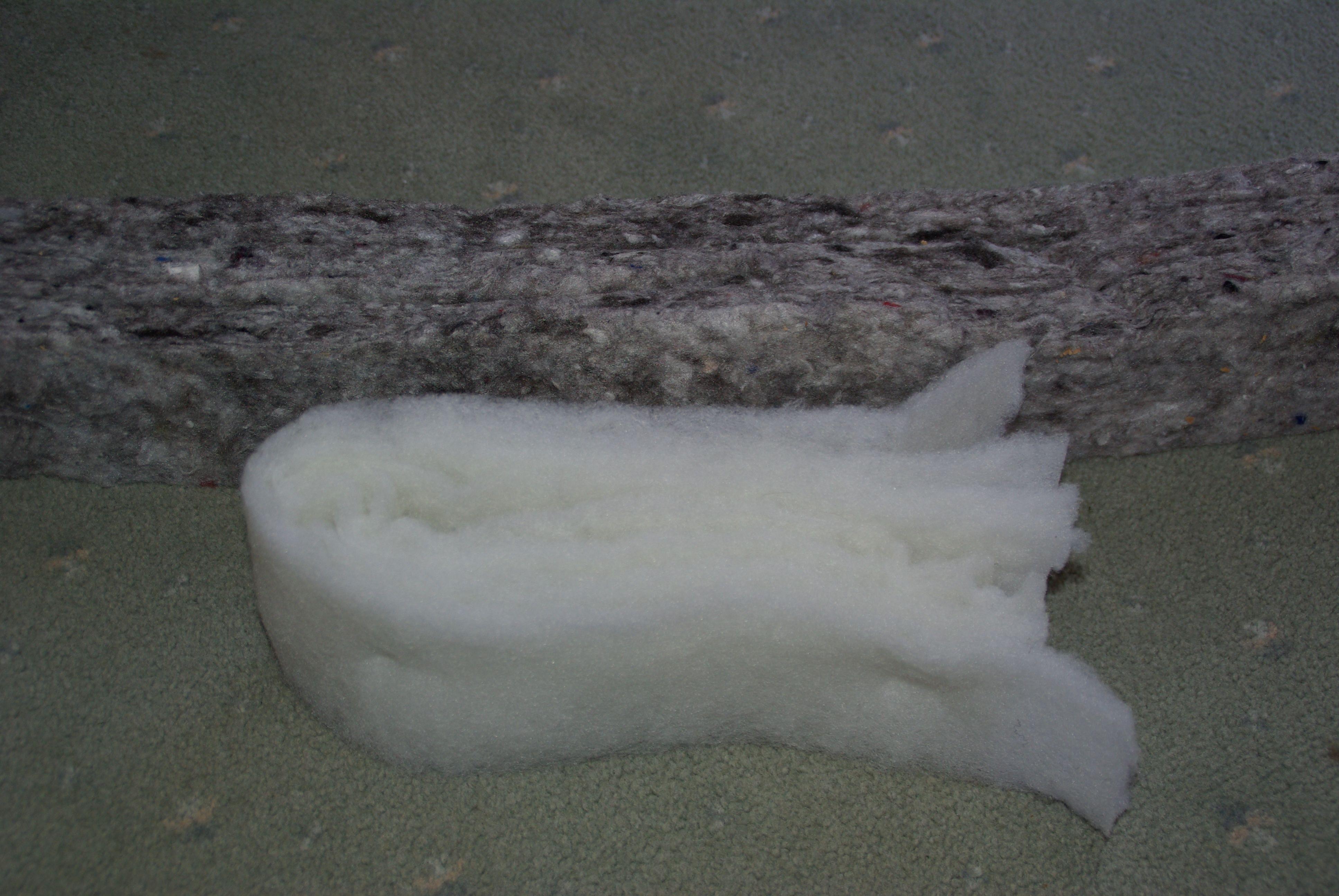

BTW, Joe went with a couple different dampening material recommendations. First, he started with a wool/poly blend and then went to a pure poly solution. I think the density rating for the pure poly is captured on a picture somewhere in this thread. As for the wool/poly blend, the Monacor MDM-3 is probably the most widely available material that matches the original recommendation in everything but thickness. I got mine from MCM, but, I am sure there are plenty of sources if you are unhappy with the poly you are currently using.

Well today I spent the whole day replacing the damping material in the rear chamber. The original material was acoustic absorbent material (the grey stuff) and I filled the chamber to the thickness specified by Joe Ras. The replacement material is made specifically for Speaker cabinet damping but is only about 10mm thick. I had to layer it to get the required thickness. (see attached photo). The difference is very noticeable. There appears to be much more energy in the LF region and it appears more extended. I am so glad you prompted me into action JK . I will now arrange to make the necessary measurements to ensure the box is correctly tuned but there is a definite improvement so far. Obviously my original material was just simply too dense and was actually reducing the box volume.
Interesting.
What is the composition of the material your are now using? Is there an R value associated with it?
The details of the damping material were given as 350GSM Acrylic sound damping material. I bought four rolls of 1.5m x 1m at about 10mm thick ($5.00 per roll + delivery). I had to layer it to get the required thickness. A few dobs of PVA glue here and there to keep it together. I purchased it from an Ebay supplier in Aus. I'm still going to do some more research into procuring the exact material as used by Joe Ras but for now I'm quite happy with the improvement.
