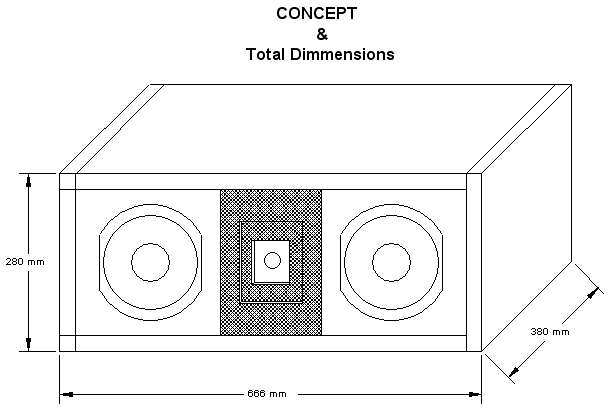

I assuming the centre is still rear ported though so would still need some breathing space between it and the wall.

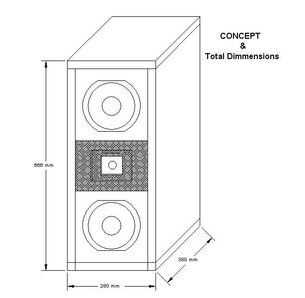

Can be used vertically as well:
Needs Stands - 400-500mm. When used laterally, should be under the LCD/Plasma Screen just under ear height.

The basic dimensions, such as width and depth, are kept the same. The height has been reduced from 1150mm to 666mm. The box, viewed from the front, is now symmetrical laterally and vertically. For example, cut the box in two laterally through the centre of the Tweeter and Top and Bottom will be mirror imgae pairs, do likewise for vertical and Left and Right side of the box will be mirror image pairs. This was something John Dunleavy preached, but for the Centre Channel is a strict requirement, as I see it.

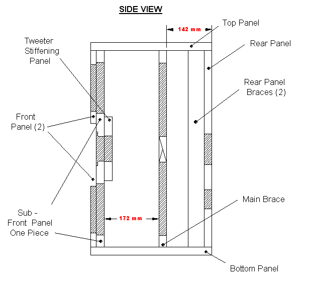

Here is a internal Side View:
The internal Main Brace becomes a classic "Figure 8" brace. Compare with the Elsinore constrcution and you can see that the main features have been retained.
