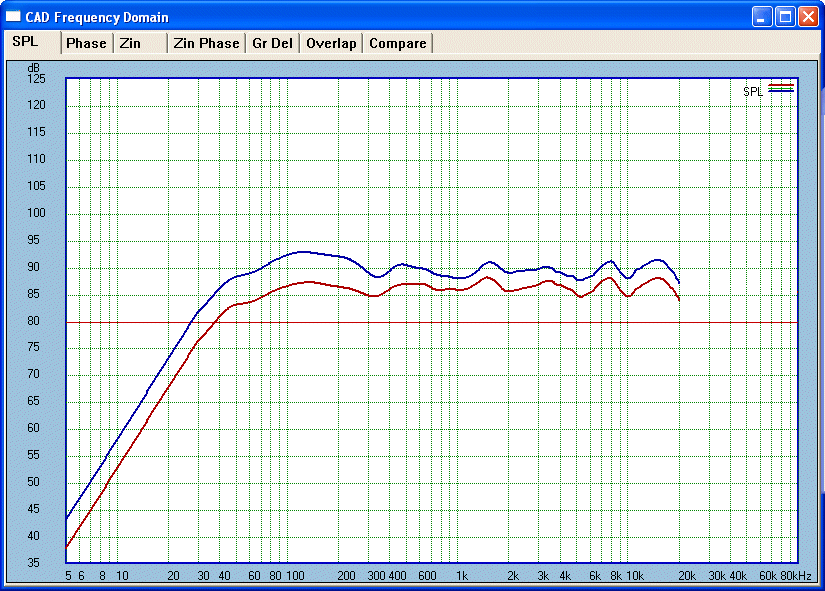

When I build the center channel to match the Elsinores..using the same crossover minus the woofer section, what size of port should I use?
PoorSound said:When I build the center channel to match the Elsinores..using the same crossover minus the woofer section, what size of port should I use?
If I have you right, you are going to use half the volume and just the top three drivers in MTM array. If so, then you will miss out on the diffraction loss that the two bottom drivers fill in below 1KHz.
You will need to do the following:
Change L2 from 1mH to 1.8mH or 2mH (main diffraction correction)
Change R3 from 3R to 6R to 8R (this changes Tweeter attenuation to -6dB)
For C14 use 2.7 to 3uF (the 8R2 larger value changes rollover point - this is the correction)
Leave the optional values in the Conjugate Filter as before.
The one value that needs to be tweaked by ear is R3. Try standard values 6R8 and 8R2 and some value in the middle of that.
The above should give quite good results, but as I have not actually built them (and measured them), I can only say that it ought to work well.
The centre channel will be lower sensitivity than Elsinores and I have not tried to entirely compensate for diffraction so as not to slug sensitivity too much, about 1-2dB short. But for centre channel this is no problem and a reasonable compromise.
If somebody down here would like to build Elsinore Centre Channel, then if they could build the box etc, then bring it to me for doing physical measurements confirming above results, then a Centre Channel could be published on the website. The Centre Channel could also be used as rear speakers in vertical mode. As a centre channel it is a little large, but alas.... use laterally of course.
The attached image shows the difference in the two, Blue is Elsinore and Red the new result - the difference in sensitivity is also revealed.
Re port, use 60mm (internal) and 120mm long. If the 60mm port is slightly less than 60mm, then that will be OK as well. But if it gets close to 55mm, then reduce length to 100mm.
