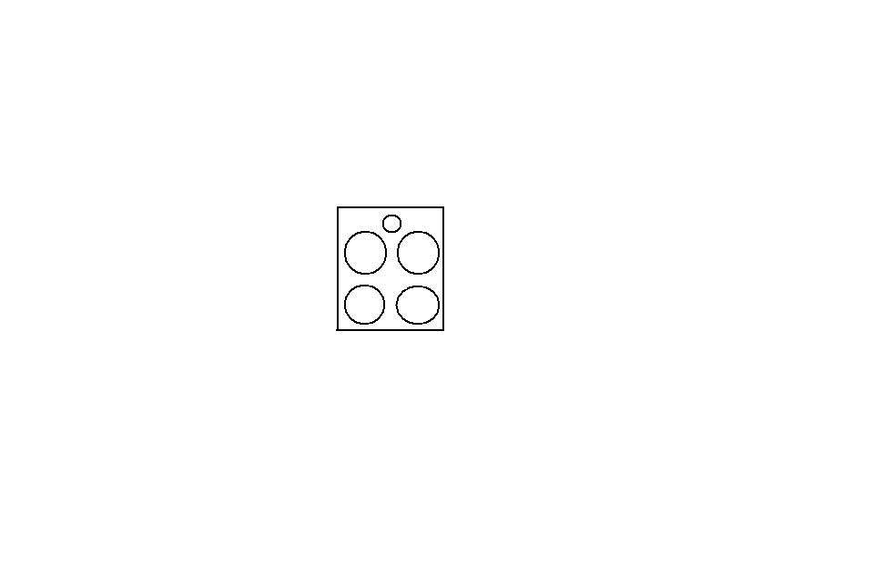

First the box:
How you make the box is up to you. Please note the tweeter is below the 5 1/4" driver. They are designed for stands 600mm high. If used as a centre speaker and mounted above ear height, then use the tweeter on top. The basic thing to remember is the tweeter needs to be as far away from the listener and the 5 1/4" PPB HDS driver closer.
The rear cut-out - needs to match the dimensions of whatever terminals you use.
The Tweeter must be flush mounted and 5 1/4" PPB driver not.
Stuffing: I used wool/dacron (polyester) bats. Cut a piece that covers half of the volume behind main driver towards the rear only - keep some space behind the driver itself. Lower half of volume, line only with 20mm thick - keep space as much as possible near the internal port exit - breathing space.
