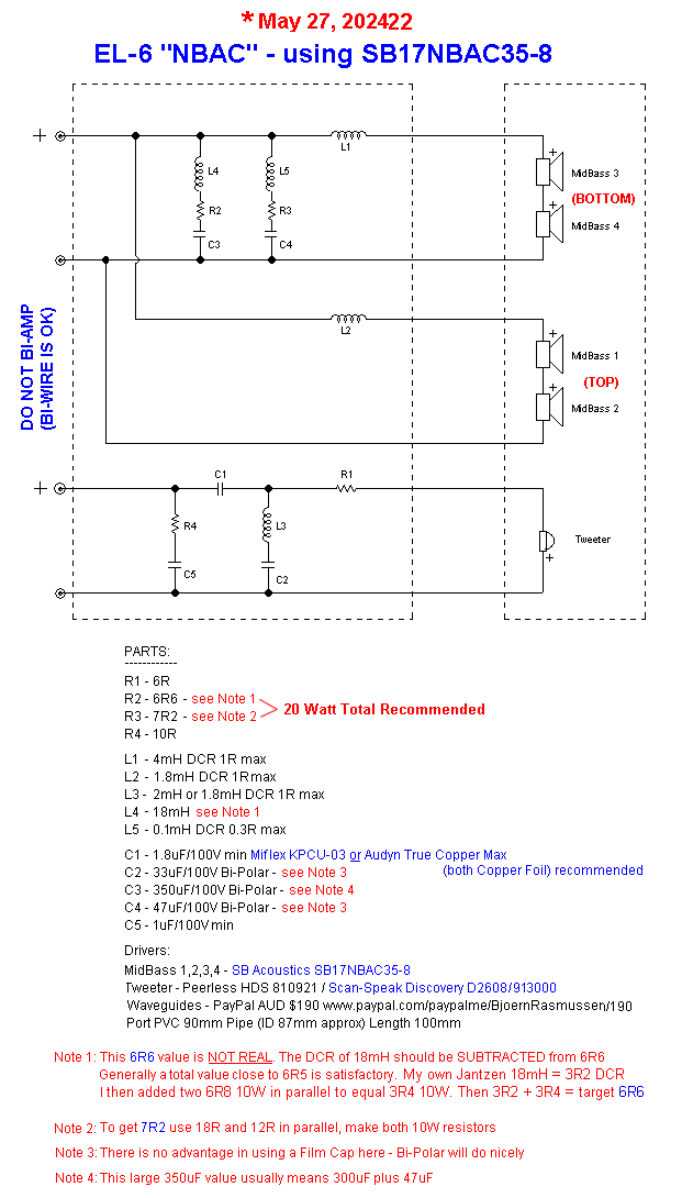

As I mentioned earlier, I have a preference for real copper capacitors, when it comes to the Tweeter, so both Audyn True Copper Max and Miflex KPCU-03 are in that bracket. Have I formed a preference between the two? No, not yet and if I do I will pass that on.
Then there is price and dimensions and fitting onto the Black PCB, so that it can fit through an aperture 145mm in diameter, the bottom driver hole and fit at the bottom of the box. The True Copper Max is 50mm in diameter and the Miflex is 40mm. But the Miflex is a bit longer. Both are a challenge to fit, but the Miflex is just ahead.

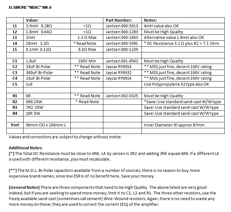

I have one question. As far as I can see, there is no RLC trap on the schematic for the break-up of the aluminum diaphragm of the Sba 17 NBAC loudspeakers. Is this solution a certain compromise of the crossover, or is it simply your opinion that this break-up is not audible?
And that is a good question and occupied a lot of time with me. Based on my theory re external 'linear' inductor suppressing the internal 'non-linear' inductance of the driver, that this is the key to making the driver respond better to the current of the amplifier (this is central to a paper we are writing) and we get the same current-drive benefits that has become such a hot topic in more recent years.
Current-drive is really the ratio of the source of the amplifier versus that of the driver should be 5:1 (or as close to it, or even higher ratio).
The same effect as current-drive can be gotten by using the same ratio of 5:1 or higher, but use inductance as the ratio.
Is this just theory? I don't think so. Call it inductor-drive if you like. It suppresses the non-linear inductance of the driver in the same way that normal current-drive does. That is simply how it works.
So I almost doubled the external inductor, played around with the so-called 'BBC dip' in the response (promoted by the likes of Lynn Olson). Besides, what I already do also lends towards that BBC dip. So increasing it from 1mH to 1.8mH and adjusting things around that, the need for that LCR (or RCL) trap receded, which interferes with what we want the series inductor to do.

So the end result is a BBC dip that seems to work very well. The much larger external inductor is now 1.8mH and the combined inductor 2 x NBAC in series is 0.3mH. I class anything that gets to 5:1 as the same as current-drive and here we have 7:1 in total. And that larger inductor also nicely means I can get by not using the LCR.

Joe, there seems to be a typo on your crossover. With R2, L4 won't be able to handle 20W.
The R2 is 2 x 10W. If extreme high power, then use up to 60W (triple) and an inductor with 1R DCR (1/3rd) to cater for that. But maybe go for an external crossover in that case, it may be a bit more of a challenge to do internal.
