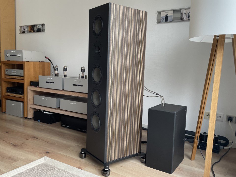

For what little it's worth, my Elsinores (MFC) replaced my Egglestonworks Andras in my main system. There is no doubt the Andras are terrific loudspeakers; my pair is now installed in my second stereo system. They just weren't nearly as good as the Elsinores.

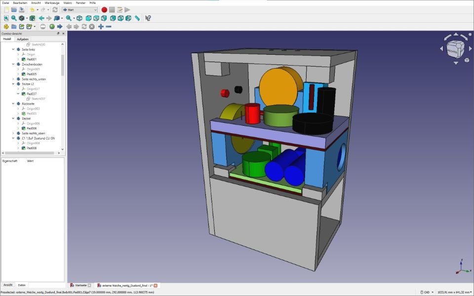

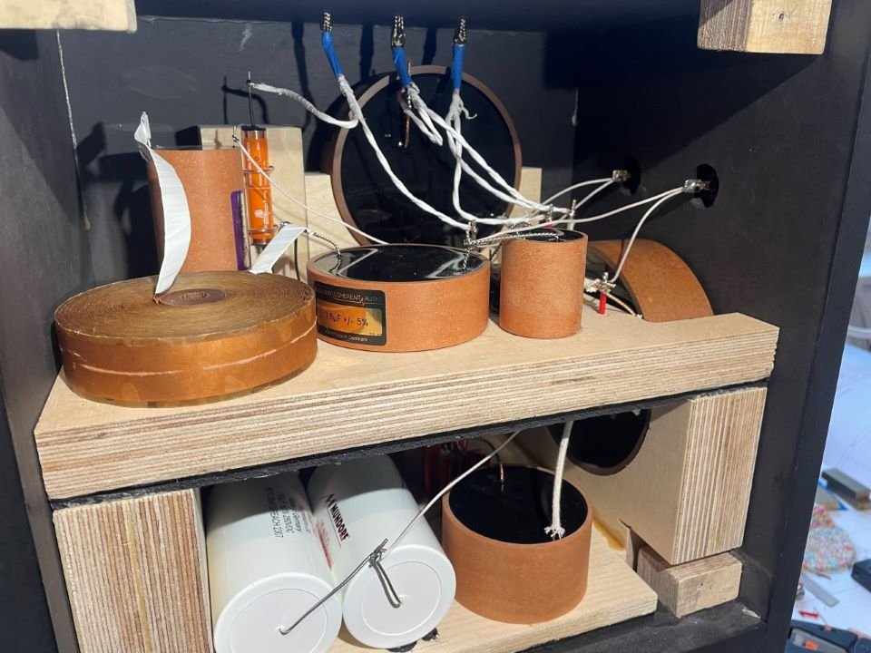

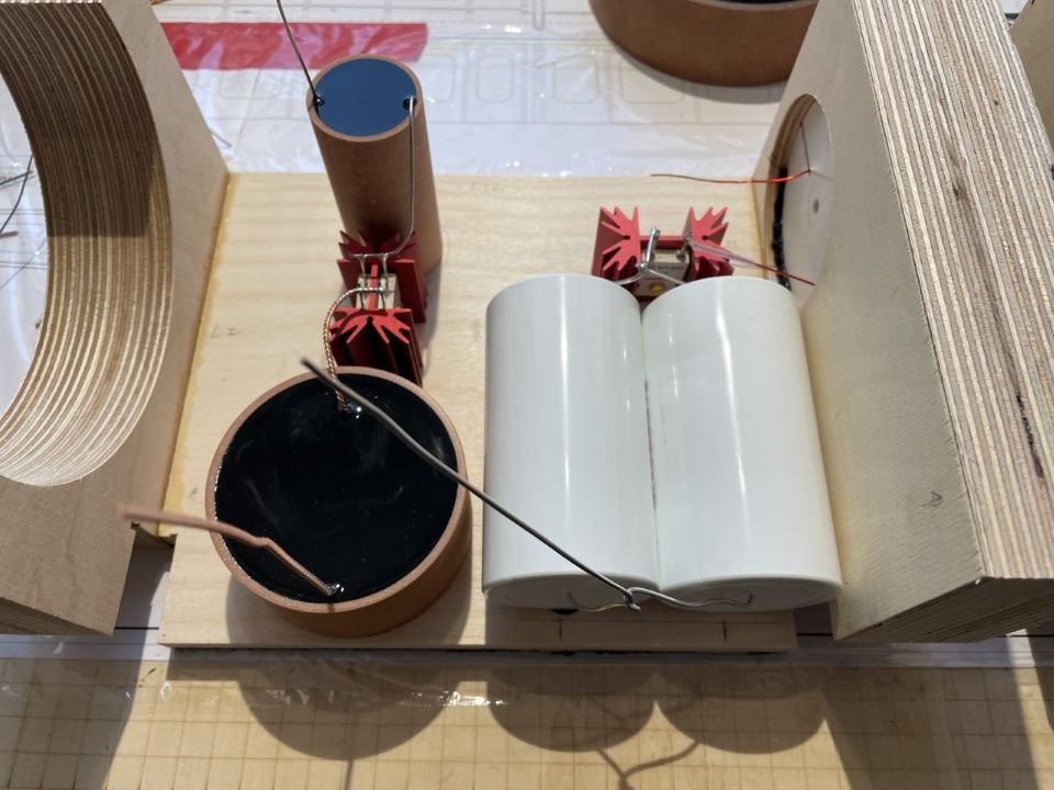

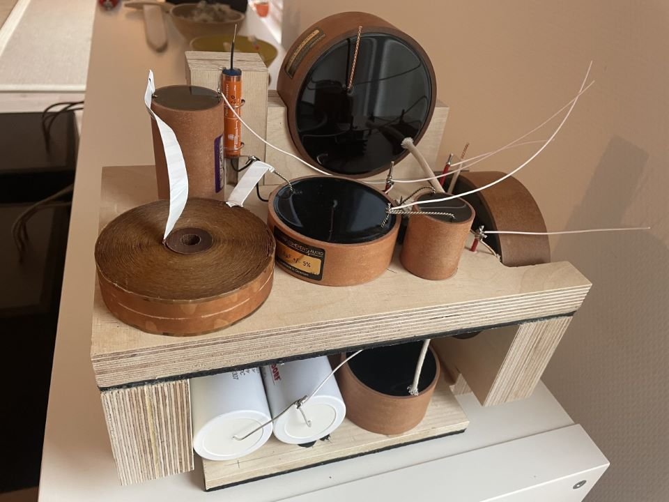

I have to admit, I'm a huge fan of Duelund. My Elsinore ULDs are about to celebrate their first anniversary and at the beginning of the year I treated them and myself to an upgrade of the crossovers. Originially I used the recommended components including the Audyn True Copper Max and your very high-quality PCBs.
For the (few) components in the direct signal path in particular, I decided to use the fine, handmade pieces from Duelund in Denmark again due to my always very positive experiences (CAST CU-SN 1.8uF capacitor & CAST 12AWG CU inductors). But I have also now resorted to components from Mundorf and partly also Duelund in the parallel-connected impedance correction elements and have completely dispensed with the use of electrolytic capacitors. Even though I know that the benefit is certainly doubtful, it just felt logical.

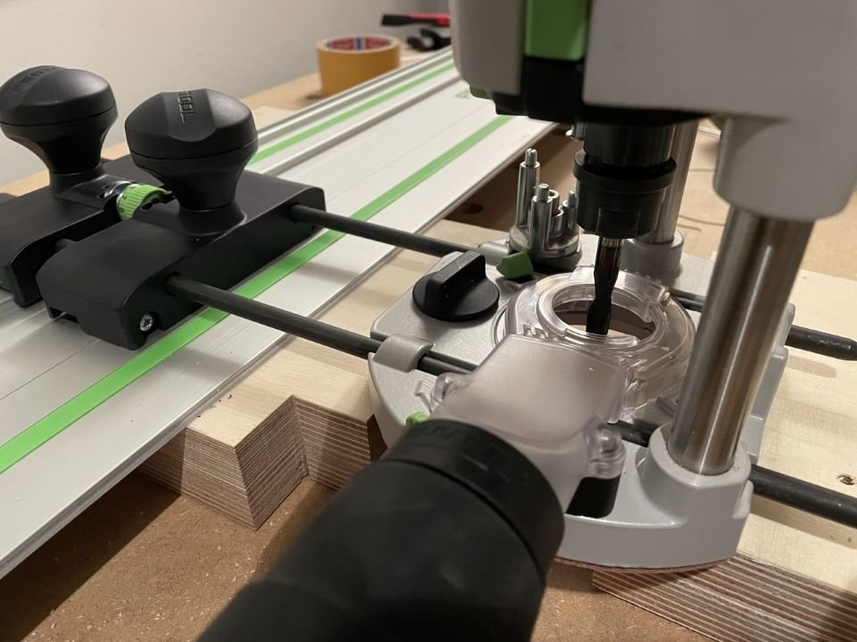

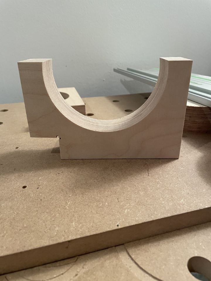

First of all I had to sit down and think about how the sometimes very large components would fit into the already finished housings. After a few days of pushing back and forth, I found an attractive placement that allows the cable runs to be as short as possible and yet avoids mutual influence of the coils as much as possible. As a result, the components for the two impedance correction elements are on the lower floor and the three main branches have found their place on the upper deck.
Then I went to my newly set up mini workshop in our narrow basement compartment to build the necessary construction parts out of wood.
Everything slowly took shape:
And finally:
The new crossovers have now completed their first almost 200 hours of break-in time and a sound classification is possible. It is not that easy to go into individual aspects, as the Elsinore have audibly improved in many areas. They now play even more maturely, more subtle and even more naturally. The fine and coarse dynamics have also increased again, the bass is even more graduated and contoured. All in all, a step that more than justified the investment in the high-quality crossover components in my opinion. Even though it was a fairly large investment, the sound gain paid off.
It is fascinating how well the Elsinore ULDs have grown with the crossover. Fortunately, everything still works seamlessly and there are no negative aspects of the new components.
