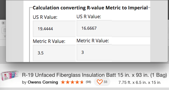

After finding out that 1" fiberglass (hard to find anywhere now) has an R value of about 3.5, learned that there is a huge difference between U.S.A and metric R values - common R-19 insulation, about 6.5" thick is ~equal to metric R3.5 (about 175mm).

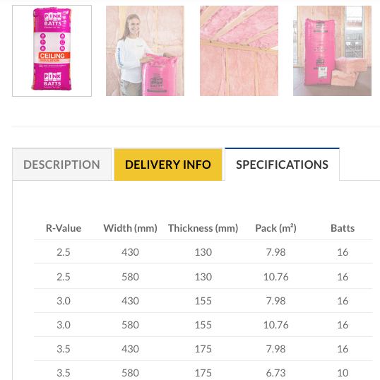

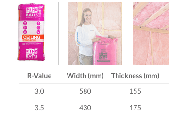

Priceline, Australia's Biggest Online Insulation Store:

I didn't suggest using 1" fiberglass, I wrote R-19 insulation (common in the USA), about 6.5" thick is ~equal to metric R3.5 (about 175mm).
