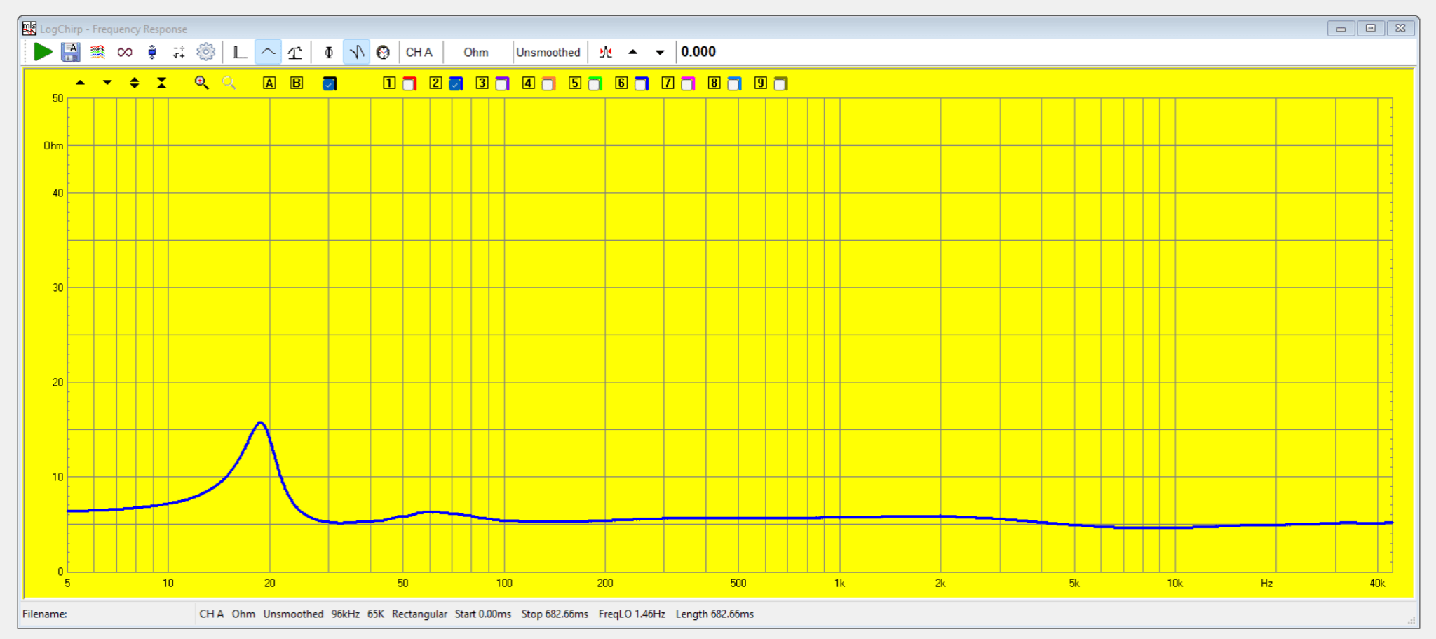

NBAC teaser: Barring the very slightest adjustment (unlikely) this is the final impedance, not simulated but actual hardware Clio measurement.
The lowest impedance where it drops down to 4.5 Ohm is around 8-9KHz.

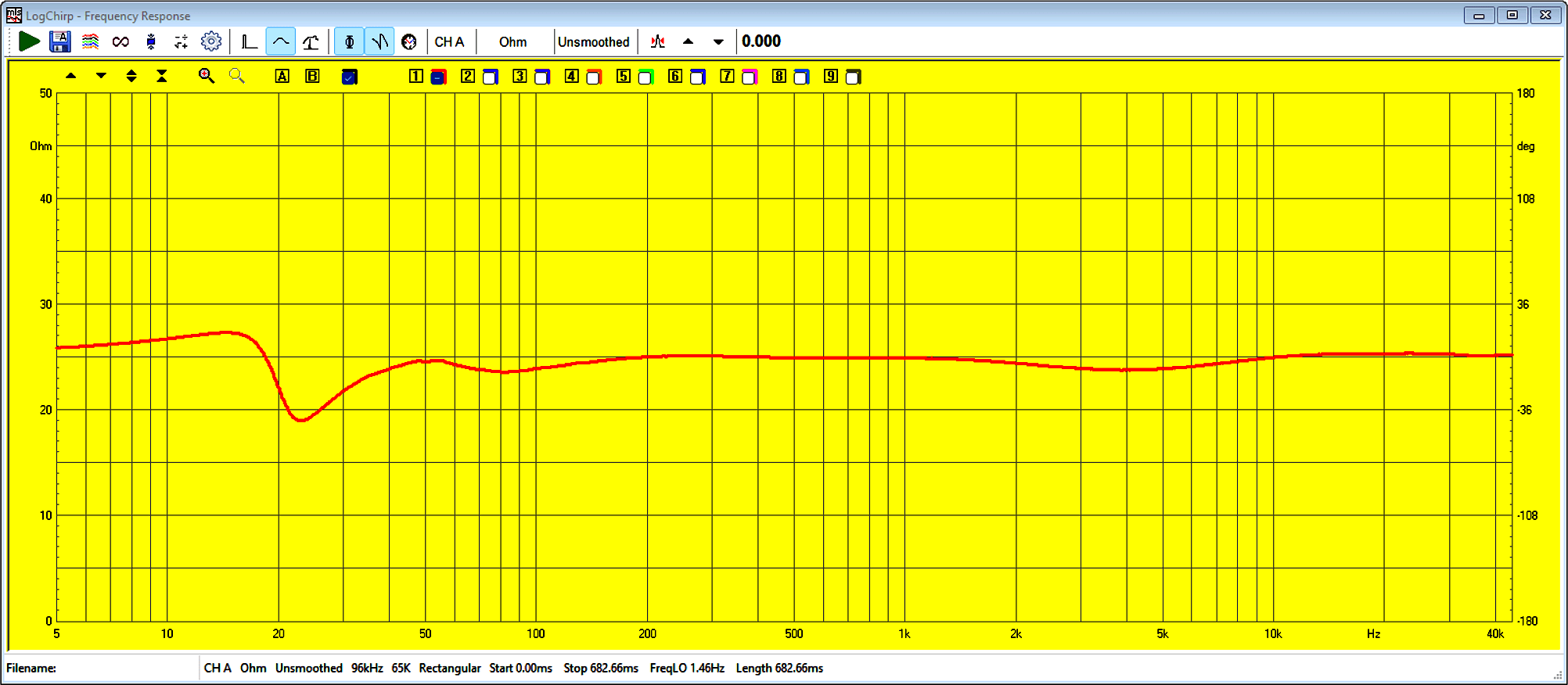

Next the measured electrical current phase:

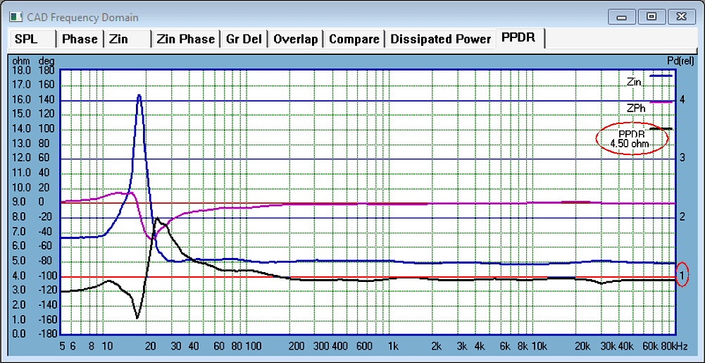

The next on is interest, but please note this is simulated in SoundEasy, but there is reasonable correlation between below and the actual hardware measurements above:
"PPDR = 4.5 Ohm"
(Peak Power Dissipation Ratio)
The key here is the Red line and (1) on the right. This line represents the minimum 4.5 Ohm = 1. Think of this as comparing with an actual 4.5 Ohm resistor and the current it draws versus frequency.
If the Black line stays below the Red (1) line, then the current drawn by the loudspeaker is less that the current that would be drawn by a 4.5 Ohm resistor. We can see that is the case from about 170Hz and upwards.
Some may have seen "EPDR" or Equivalent Peak Dissipation Ratio and PPDR is similar. The Black line is the same except it is rated to be specific resistor value. Clearly a 4.5 Ohm resistor draws a known current and the same current would be drawn if we saw 4.5 Ohm in an EPDR graph. At the moment PPDR is available in SoundEasy and basically provides the same info as EPDR, but in a less obvious way. I hope that SoundEasy will provide an EPDR option as that is much more intuitive.

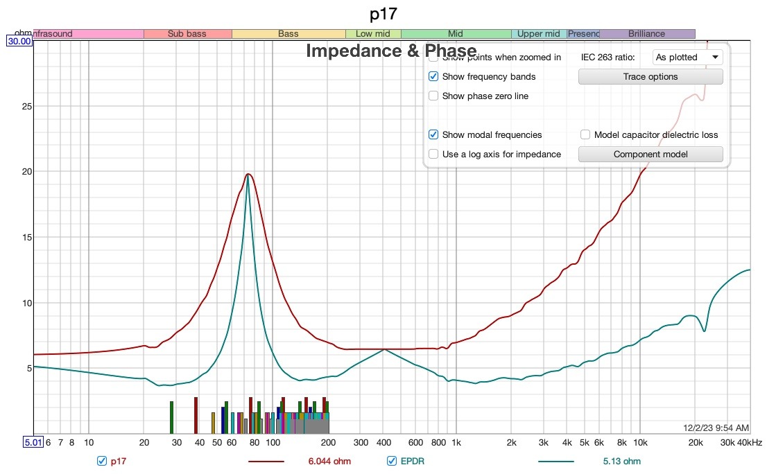

I believe that REW does EPDR measurement and maybe need to look there and get hardware to do it.
It would be nice to find that there is a piece of (stand-alone?) software where you could import the actual measured impedance plot (usually converted to a text format) and that is will give you an EPDR graph. Does anybody know if there is such a thing?
See the functionally described in Vituixcad 2 help (Search EPDR in the page)
https://kimmosaunisto.net/Software/VituixCAD/VituixCAD_help_20.html
Very simple to do, on impedance graph, crossover panel:
1. Right click : Open overlay
2. Right click : Show EPDR
Have fun !

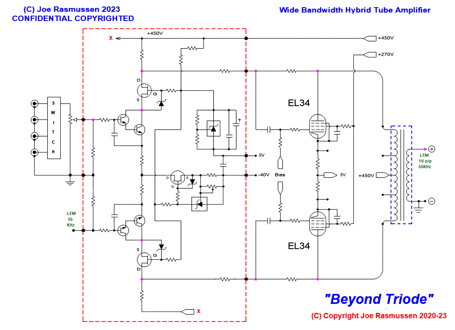

I consider the design as belonging to Vacuum State and I will not replicate it. But since late 2016, along with another friend of Allen's, Brian Gurr in Auckland New Zealand. In late 2016 I was visiting Brian and he wanted me to make an updated version of the DPA-300B because he knew I could be open to that, having been part of its development. I declined and said that the DPA-150 showed the way, where the idea of the tube being forced closer to unity gain was a way of "going beyond triode." I realised I had stumbled across the right words, Allen was the first one to go "Beyond Triode" with the DPA-150 and that I had to figure out a way to do the same without copying his design. I also wanted to use the EL34 instead (for a number of reasons, what I had in mind the EL34 is easily the most suitable.
It took six years!
Below is the schematic, but without the values etc that are critical. You can by all means make it work if you are clever enough, but there is values and info missing that means you will not hear anything like the potential values. Some of the resistor values are unlike anything you would expect and has a huge influence on the result. Also, no power supply schematic which is critical too.
I admit I am biased, but this amp was designed when 99% of the time it was connected to a pair of Elsinores. If any amp was ever designed to go with the Elsinores, this is it. :)
