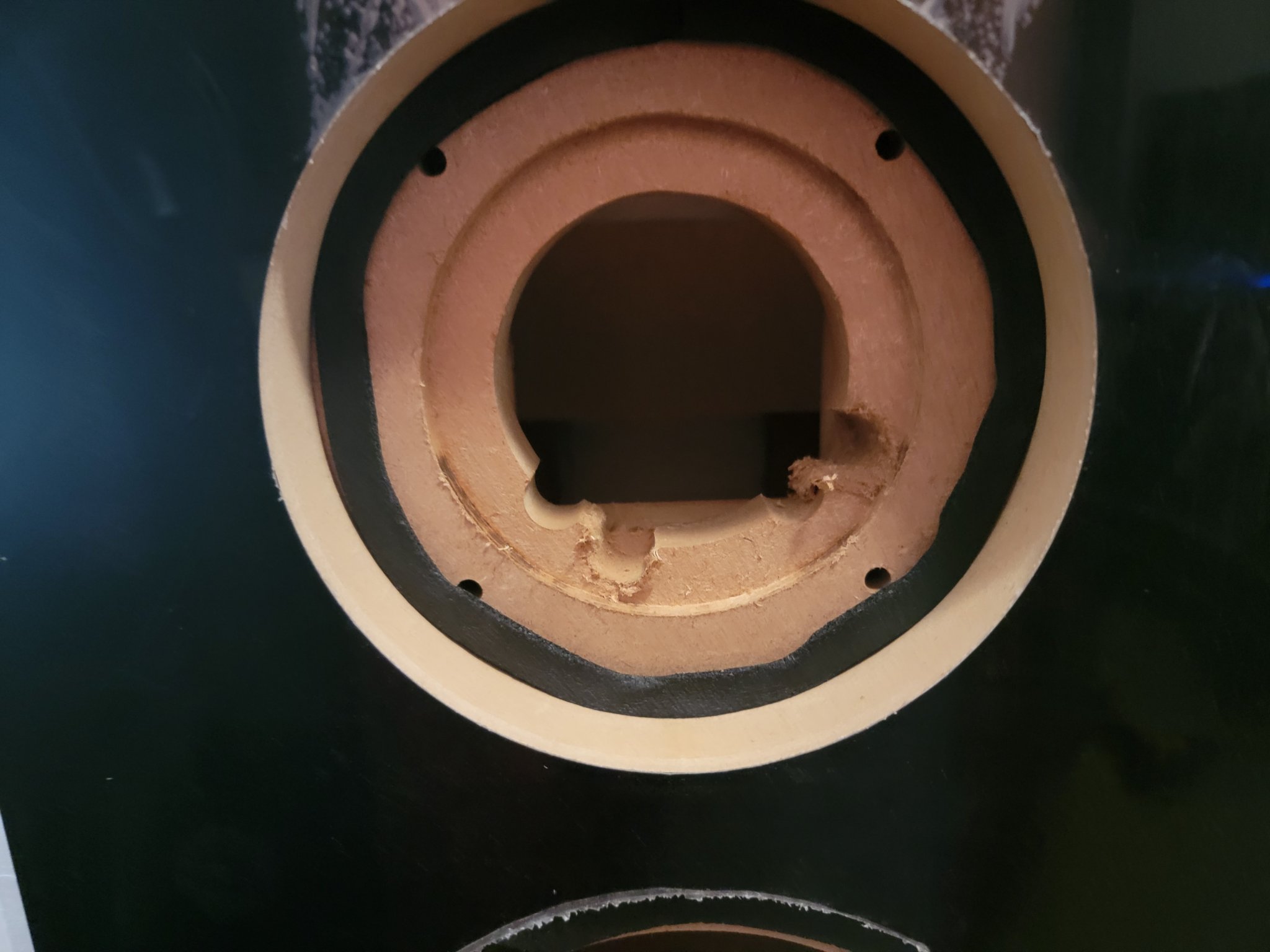

@Joe Rasmussen why does your design not incorporate any hard damping material against the inner MDF? Like rubber sheets or maybe even closed cell foam. Something to completely isolate the sound waves from the sides? Usually it can be very thin and not encroach on the volume, but this design doesn't call for it?
Well, weBuild4Life, this is an stuffing eloborated over several years, but, it is DIY, you are free to test what ever you like. The walls of the speakers are quite well damped with the braching, no need for additional measures. But this is my personal sight on this.

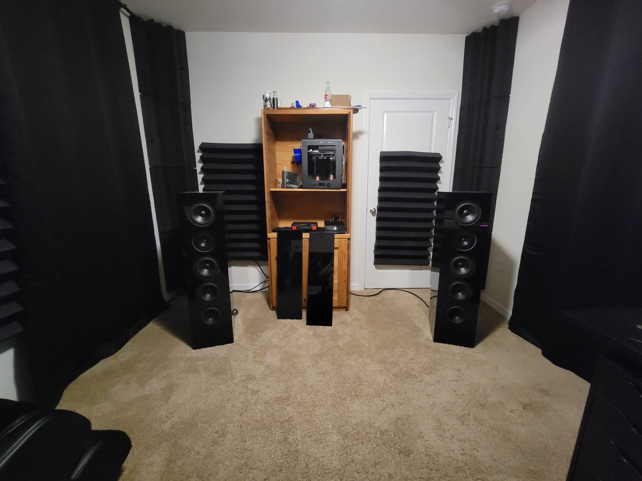

BUILD. COMPLETE. I have been at it for a few hours so I am going to do the write up tomorrow, but I only have one concern.

Morning All,
In record time I have been told, the Elsinore’s are completed. This would not have been possible without the help of several people. Thank you @mtg90 and @Pilk for the crossovers, @SRMcGee for the prebuild cabinets and design (sold to me from a friend of his) and last but not least @Joe Rasmussen for the wave guides, quick answers and support, and the nearly two decades of development refining the design. Also thank you to people in this thread answering my occasional design questions. Below will be my miniature build log and attached will be all the photos, including a cat tax.

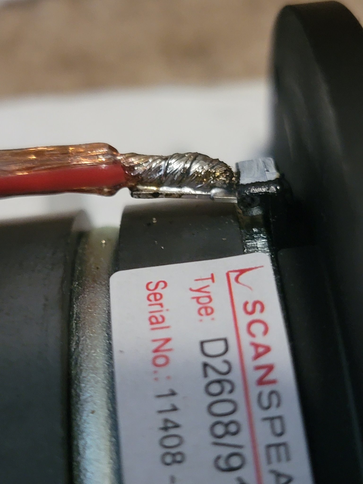

Soldering note: I had very little experience soldering, so I am going to add some notes here.

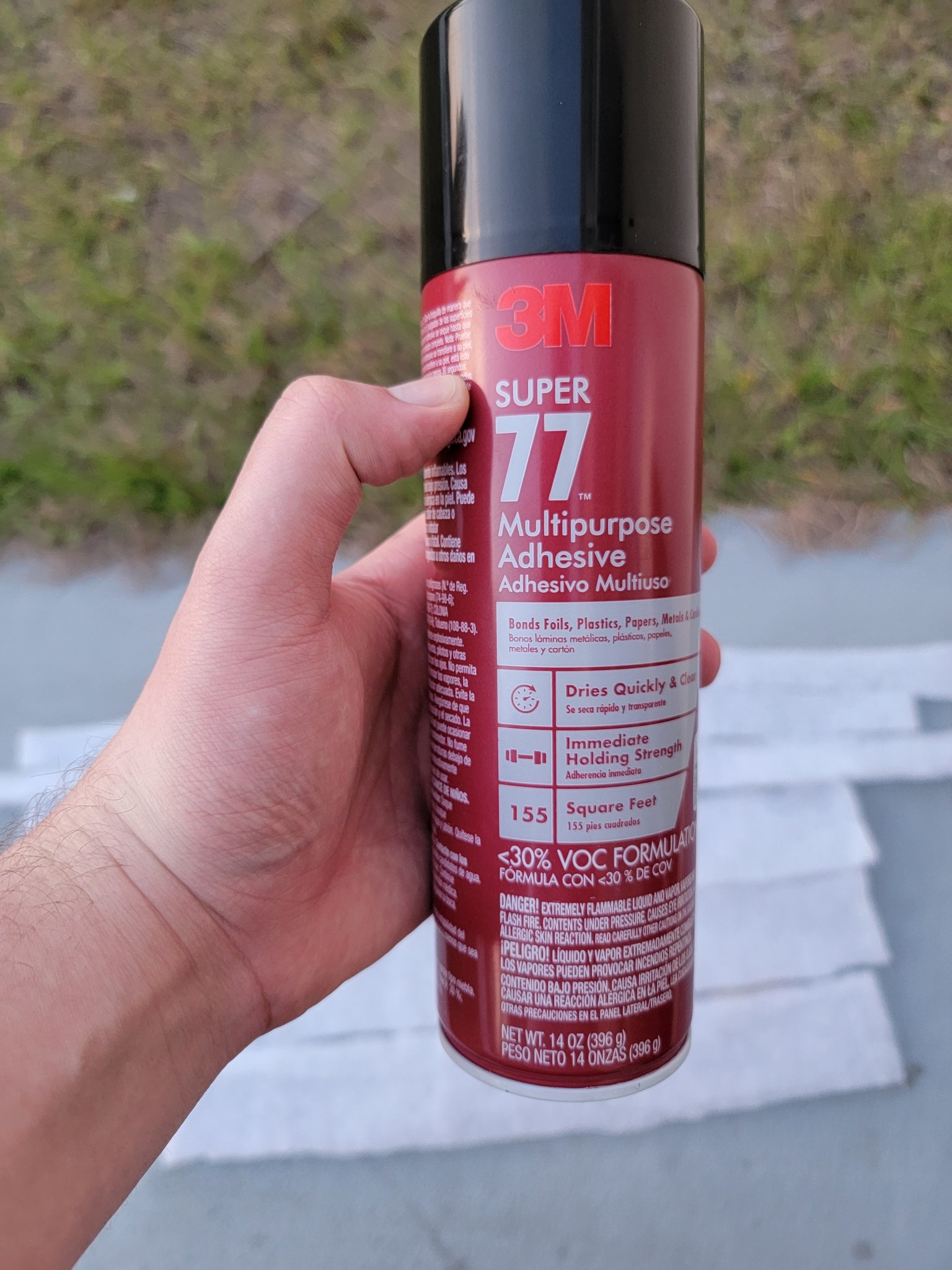

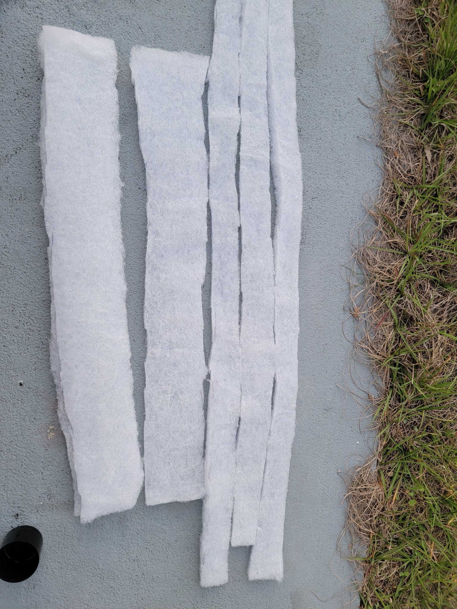

Ok, next topic a bit shorter. I bought dacron bats for the infill, and I think I should have gone with something denser. I think this works fine though and if I wanted to just do things more by the book, I’d have added closed cell foam, or a rubber sheet on all the walls to further dampen. I think isolation spikes will do more to improve sound quality than that though. The floor shakes from how much bass these can put out. I used spray adhesive throughout this whole project. It was amazingly easy to use. It fused all the sheets, and easily stuck the filling to the wood. White glue was not treating me well. I also used the spray adhesive in one spot to attach some foam to a door. Very fool proof.

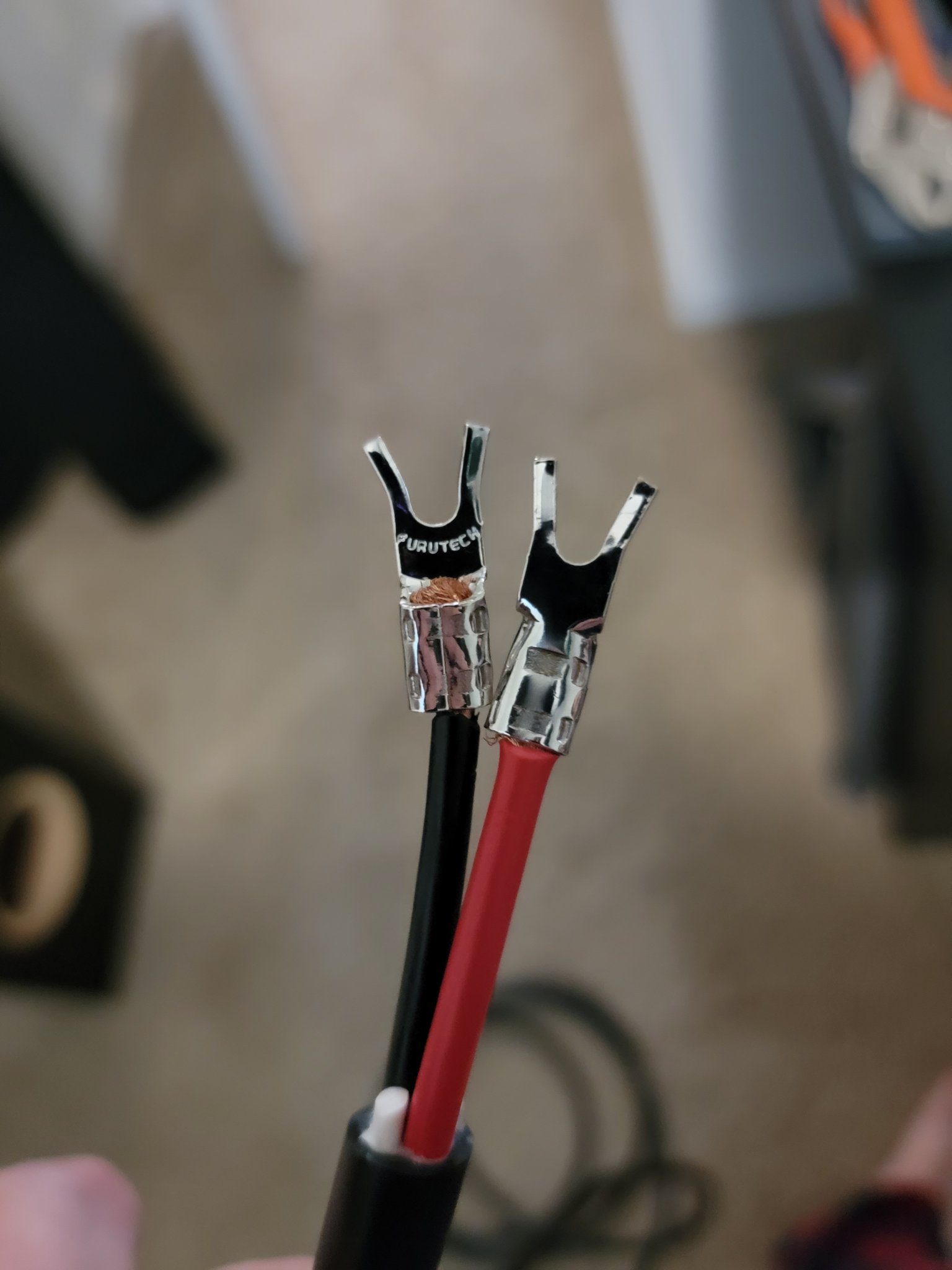

For connections other than soldered. I used rhodium crimp spades. Make sure to get a ratcheting spade connector if this is your first time, or you will not make a good connection, it requires an insane amount of force to properly crimp. ALSO – Do get LARGE spades. I am not sure what that means, but my small spades did not fit the terminals anywhere, I made them work but I needed bigger ones. The standoff post was a Cardas economy binding post. I would not choose this again, I’d go with a more traditional cup style, but this was part of the cabinet design so I am not complaining. I did use 12 gauge Mogami speaker wire ($$$) and Belden signal cable for the XLR connections.
- I bought a cheap solder kit from Parts-Express. It worked, but the tip is already dead and was a little difficult to heat up the binding posts.
- Make sure to buy that jelly stuff to tin the tip, it’s like yellow paste. I didn’t have it, I think it would have helped.
- Some say you need a higher end solder gun. Probably, but if this is your one and only project a $20 kit will be fine.
- DO TIN EVERYTHING. My last project I did not, tinning makes it so much easier and almost fool proof.

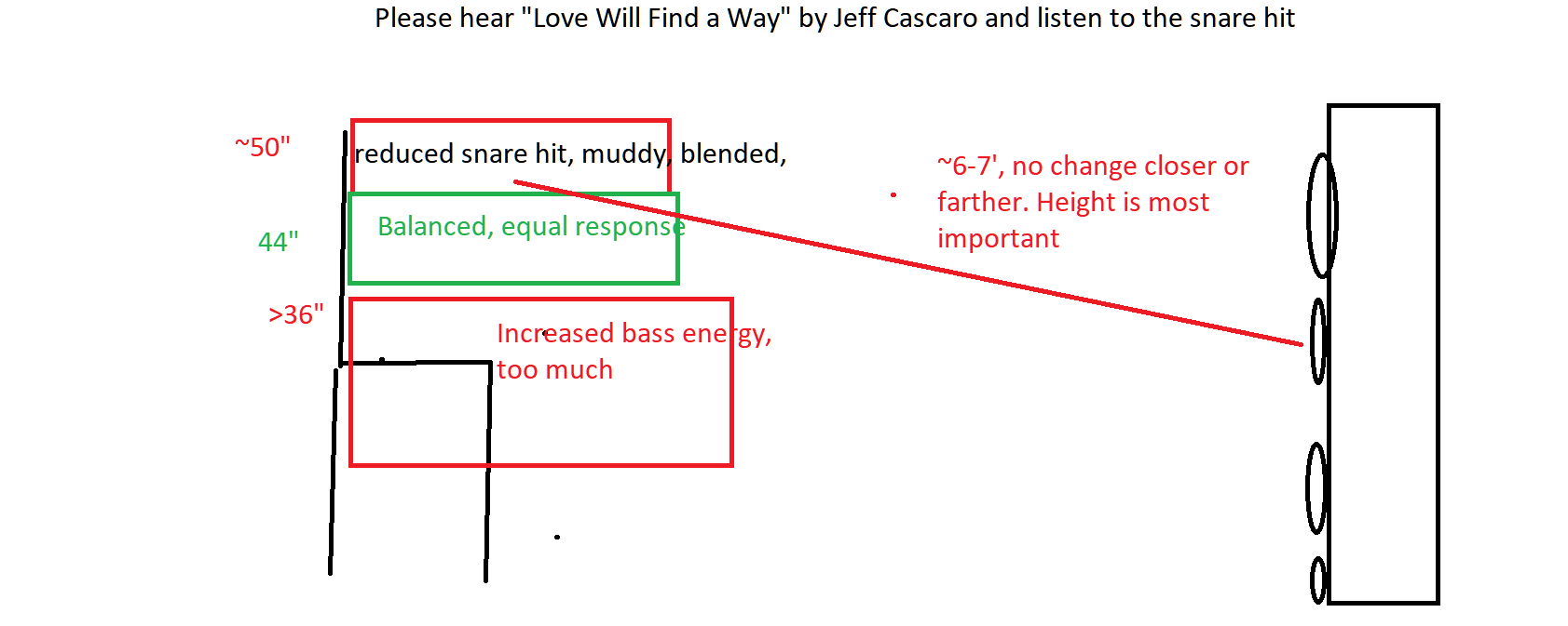

- Slightly finicky room set up, 2degrees made a big difference in sound stage. This is not unique to the Elsinore though.

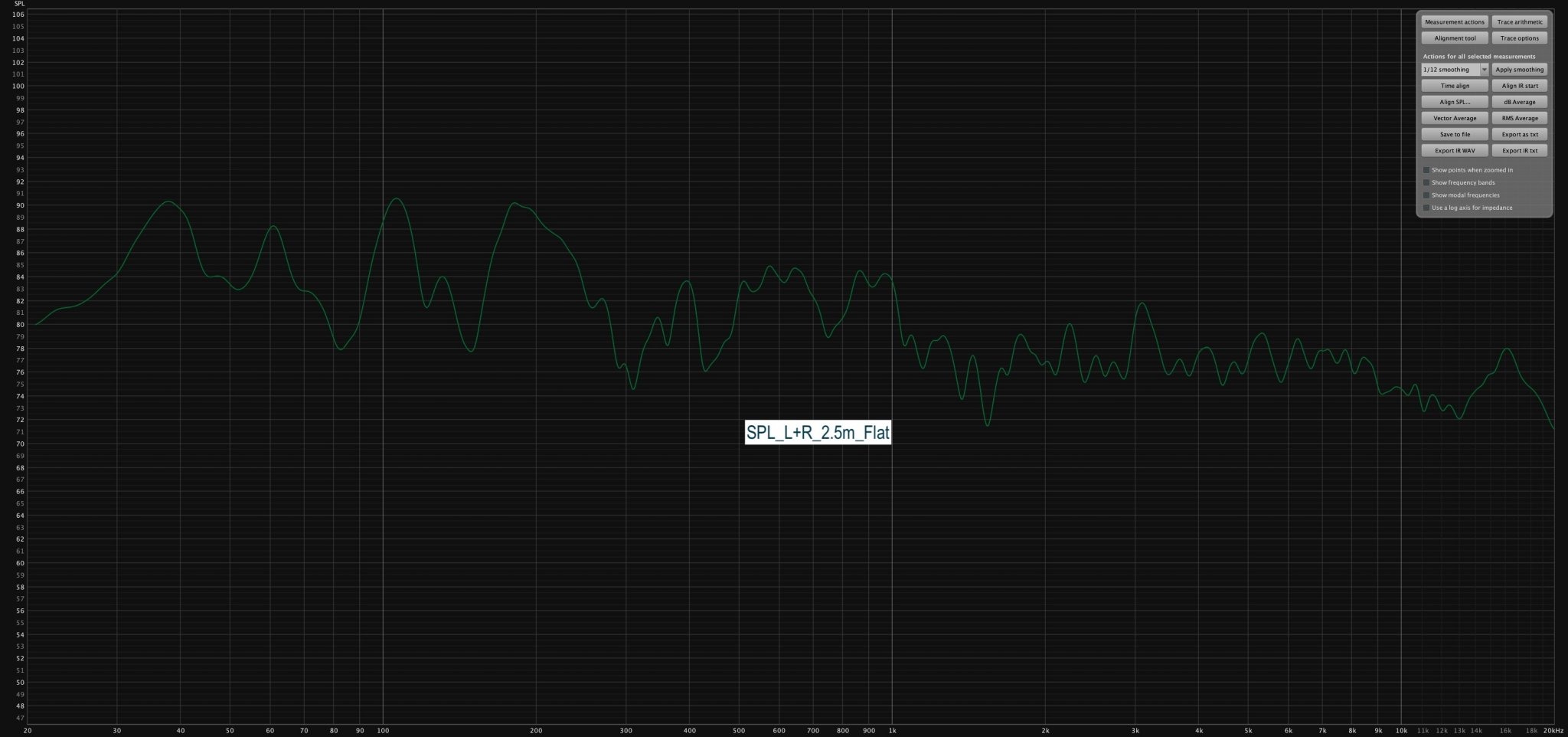

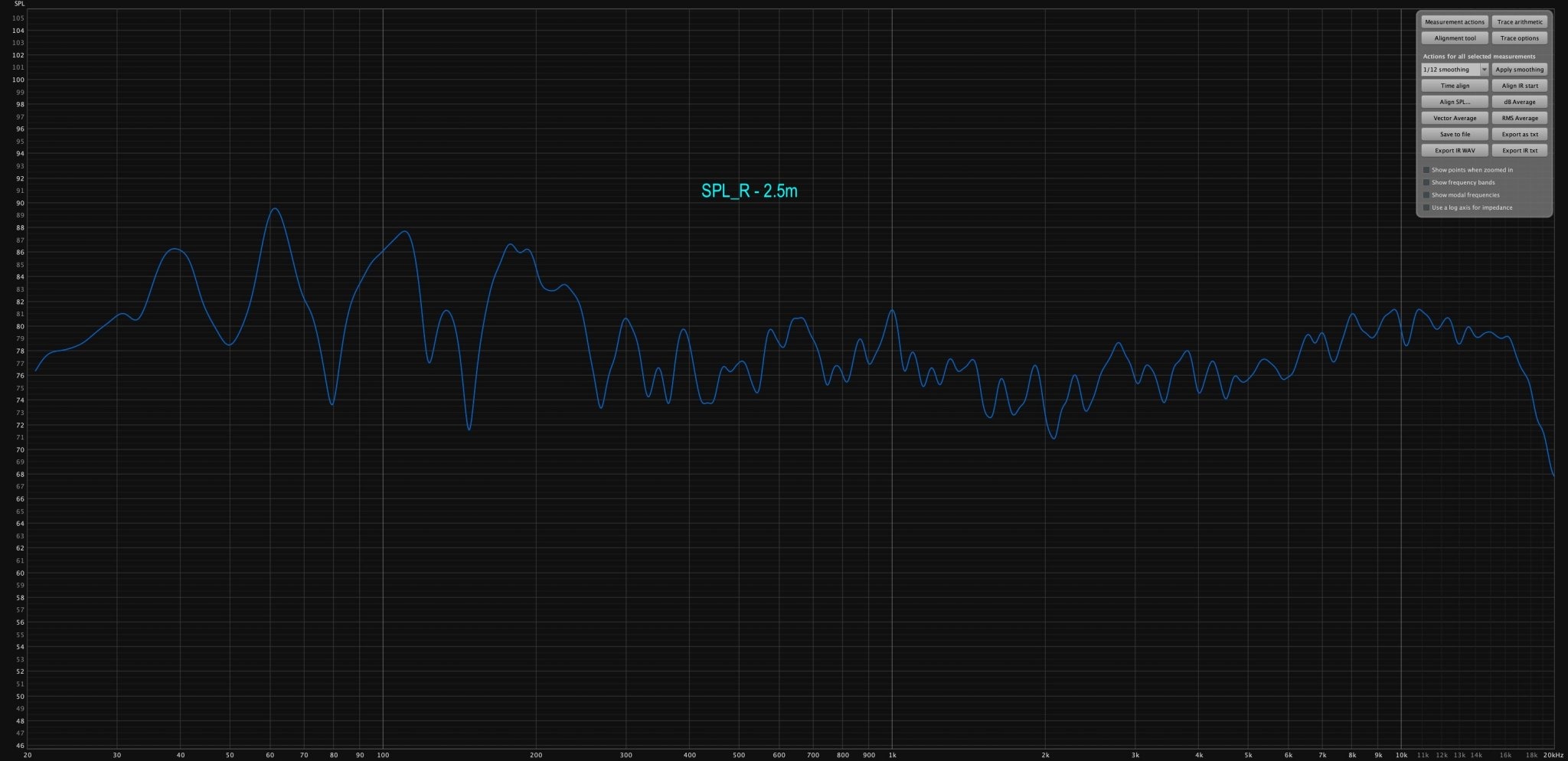

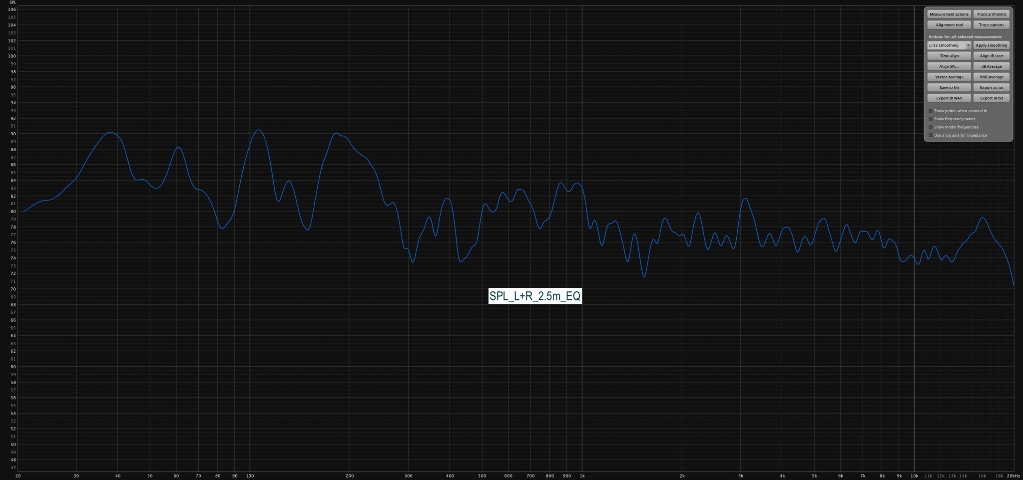

- ROOM ISSUE: MASSIVE 8db spike at 29hz. The (foam) bass traps I bought take care of the 60hz nodes of the room and higher, but the 29hz node is unreal. And yes, these speakers can play that low!!! May need to build a proper bass trap, but there isn't that much musical energy down there in MOST songs. and hell, if it does go that low, some extra crazy boom (movies / electro) probably is welcomed.
Thank you all!
To do:
- Listen
- Fix room response (see attached measurement at listening position)

Good stuff WeBuild4Life.
You have spikes on the bottom of the speaker or they are resting on the carpet?
Carpet for now. They do need spikes for sure. Or at least an isolation platform.You have spikes on the bottom of the speaker or they are resting on the carpe

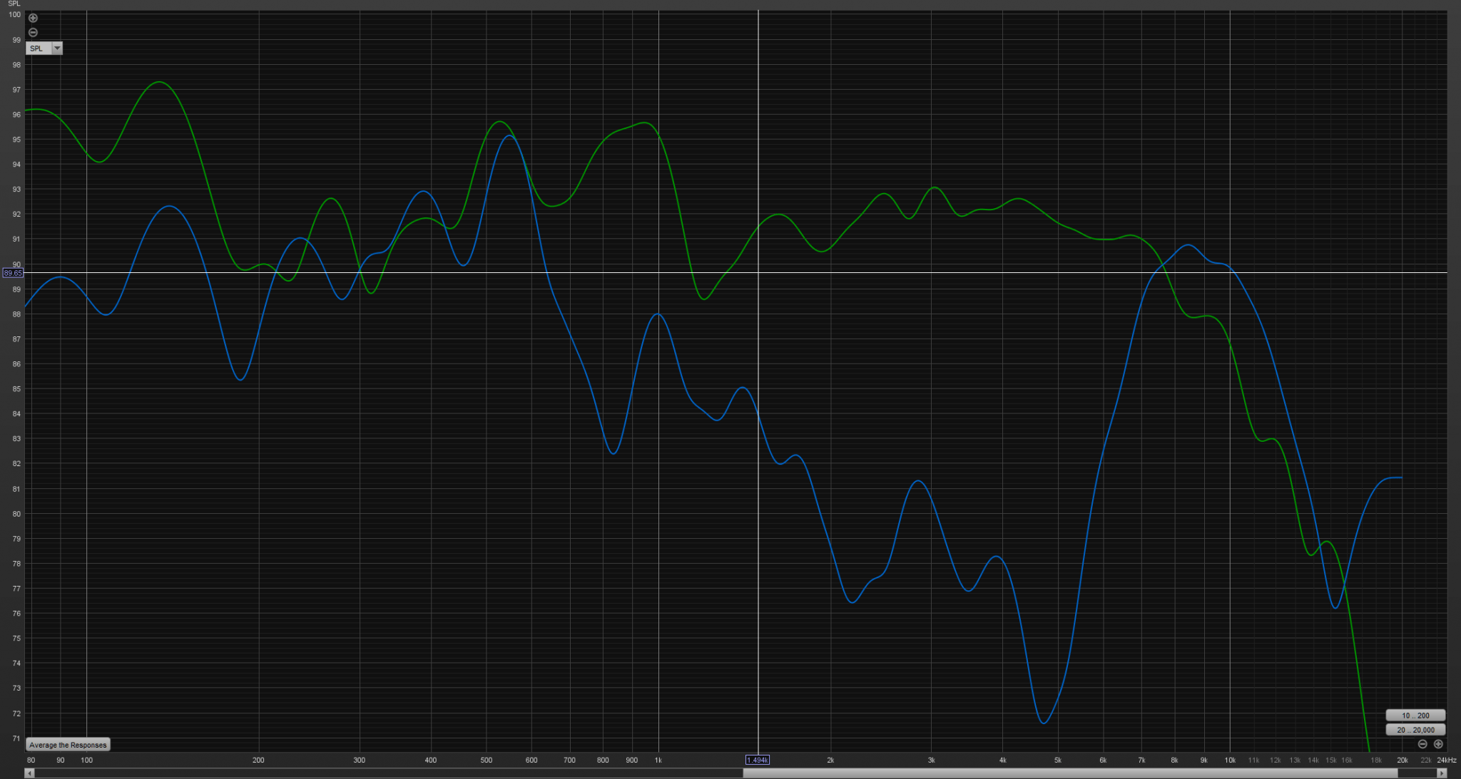

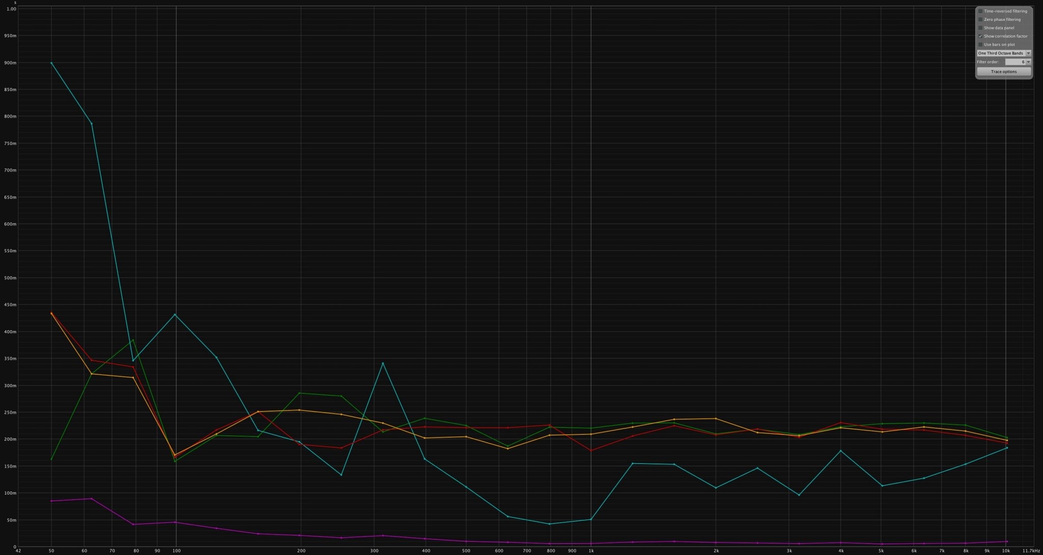

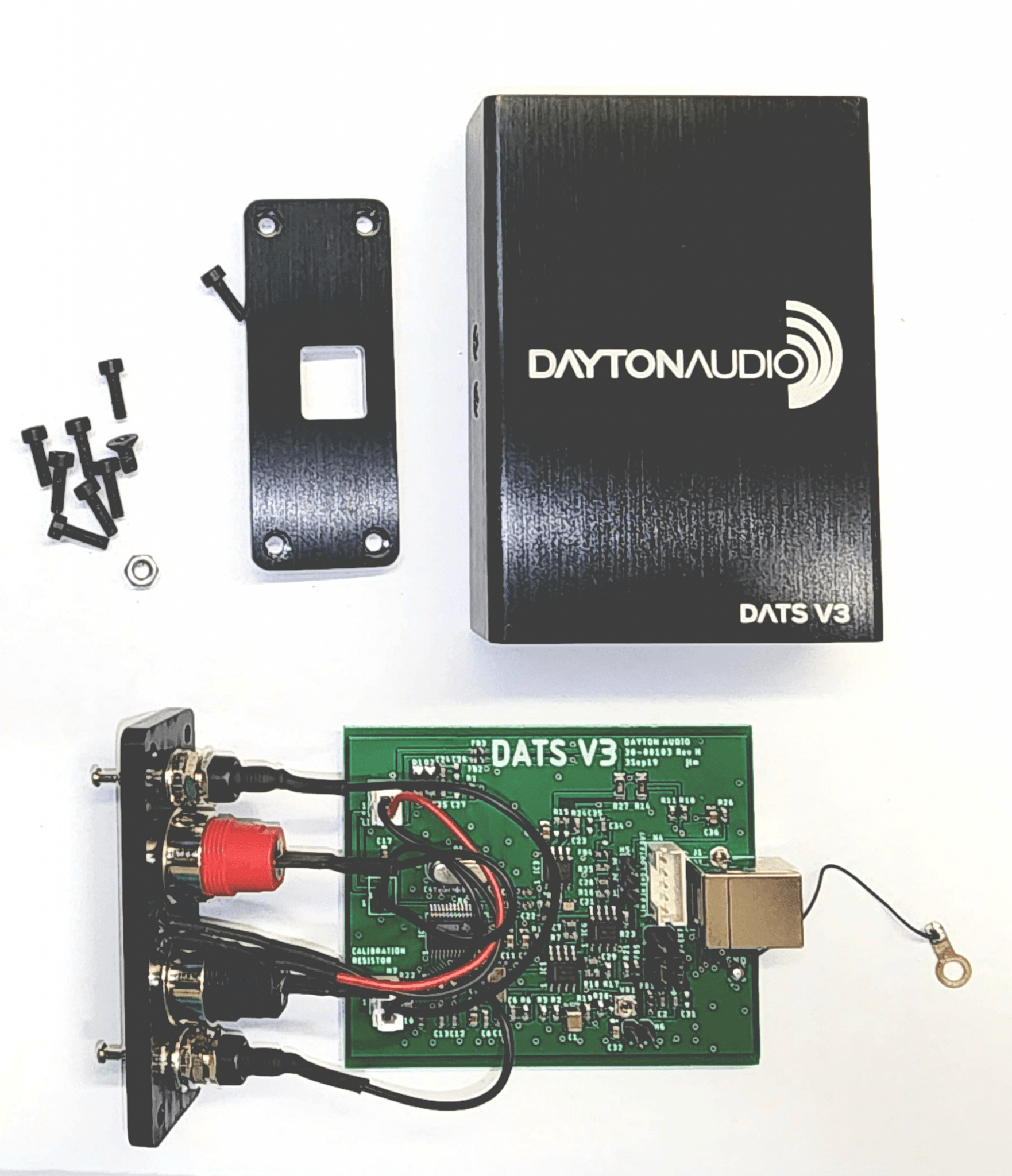

Couldn't help myself, the DATS V3 with its innards exposed;
This is what it looks like in my Elsinore ULD. Left and right speaker.it would be great for some of you serious guides to get and post your Impedance graphs and compare with others

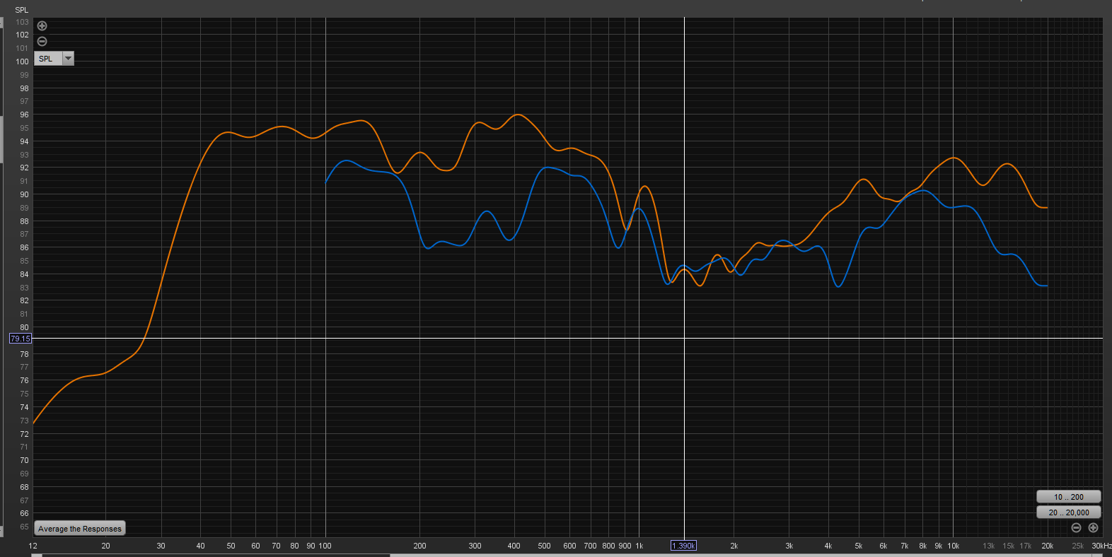

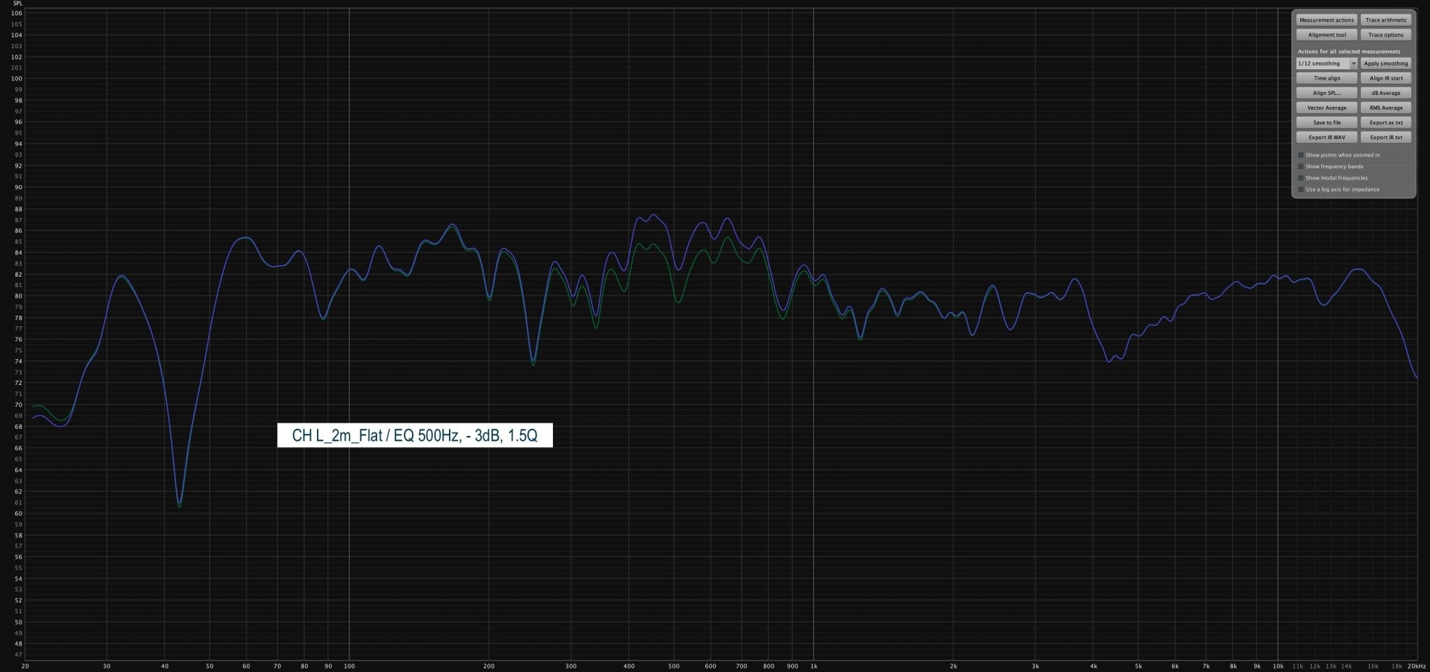

In addition, the measurement in the listening room. 2m, 2.5m. The listening position is 2.5m.
It puzzles me that from 2m and closer to the speakers (1m) I register a significant increase in energy in the 400-800Hz band. Maybe it's a reflection from the floor. In the listening position, it ceases to matter and even looks like the correct tonal balance.
Wondering if something is not wired correctly, but I can't imagine that is the case?

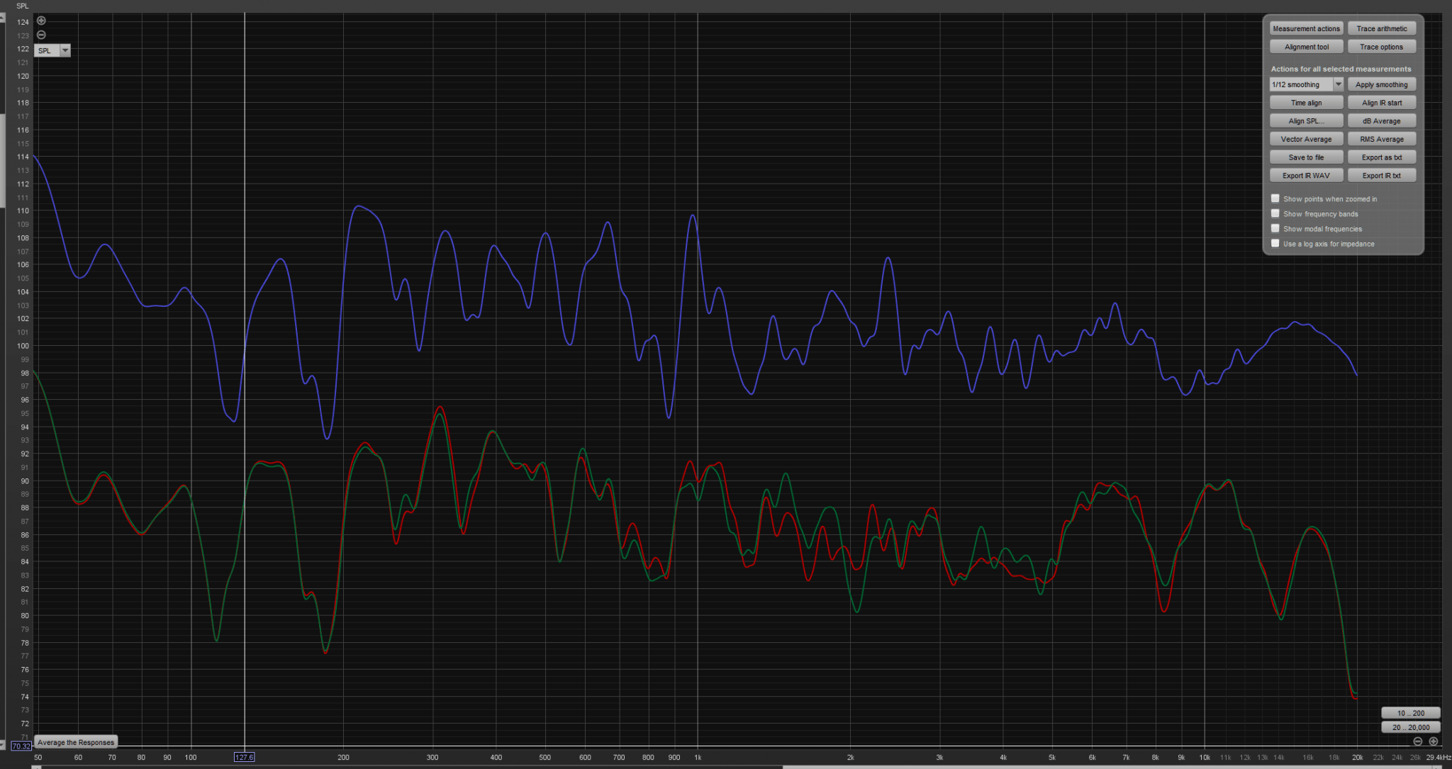

Both speakers when measured about 3' from mic show a tremendous dip in energy in the mid bass. To confirm if this is audible, applying some EQ to the 1000-3000 range greatly changes how the system sounds. Brings out brass and organs much more as an example.
Now, if we have two speakers playing the same level from 1000 and under, and then the mids only play with half the number of drivers, this kinda makes sense. But I am not sure if we'd see that kind of energy drop. I am fairly certain this is not a room issue, as I see the same thing in all points of the room, and for both channels.
Would appreciate any insight on this, or if it is an issue at all, maybe reduced mids are intended.
Thanks!

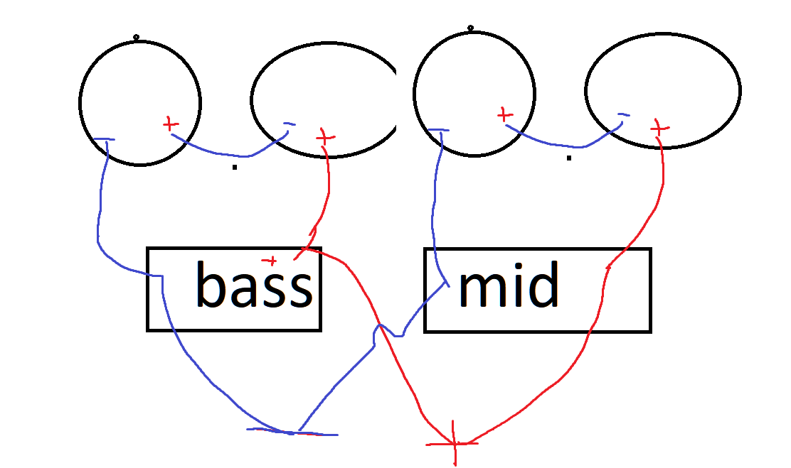

They should be, unless the crossover was made wrong? Each woofer is wired in series, and then connect to the crossover as a whole. The bass/mid isn't really accurate since it connects to the xover board differently but yeah.Are the positive and negative of each speaker wired correctly, as per schematic?
Series, and then essentially in parallel?
I pulled the crossover, and it is set up correctly, Mid passes through L2 and then leaves, bass woofers go through the whole network and out. the two groups are wired in parallel.
Edit: I also did make sure that the tweeter has electrically negative into the positive terminal on the tweeter, so that is right.
Yeah I am at a loss for now.
I double checked the soldering on the woofers. For the top two, it is wired positive in, negative out to 2nd woofer's positive, negative out to negative ground. Same goes for bottom two. The top two are both wired to the mid portion of the crossover (just the inductor) and the bass the same way (to bass portion of xover)
Both speakers exhibit this behavior, and room effect isn't in play as either near field, mid field, far field, both or each all exhibit the dramatic dip.
Not sure what other troubleshooting steps I can go through for now. I can take any type of measurement needed.
The 1MH inductor crosses over at ~1300mhz which is where this dip is most dramatic, but I am not sure what is supposed to be picking up that energy? It isn't the tweeter, is it? Bass as far as I am aware drops off before that too.

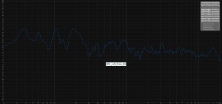

So I wish I could delete my posts above, since it seems like I am talking to myself. But I think I found the issue? Not sure how to correct though. Maybe this serves as a nice write up of trouble shooting though 😉.
The only difference between the two below are about 2' of vertical distance. One where my head would be, one where my butt is. The green shows 0 loss of energy, where my butt would be. Blue shows complete loss of a lot.

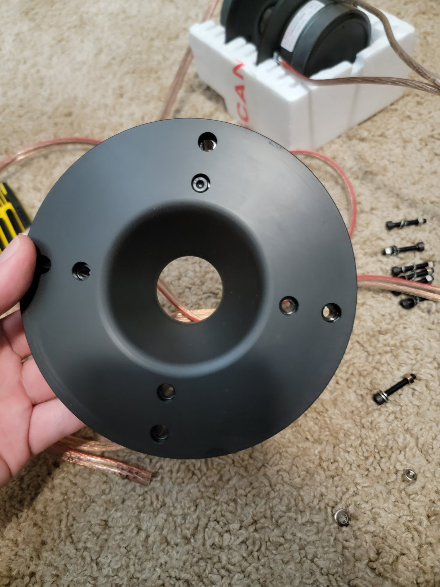

Could my wave guide being 2mm recessed too far cause this @Joe Rasmussen ?
I think i'd like to ask about the great roll off after 10k, but could maybe just add some EQ if I want more there.
It really could be some weird room node canceling every bit of energy. Crazy to me it is so consistent no matter the mic position though.
