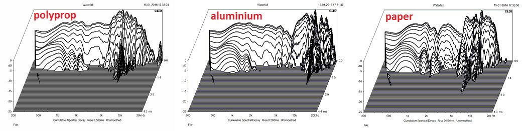

And here Troels wrote something on his website that changed my mind. He listened to the playing MLS signal through a raw driver and hear its character and the character he expected with the aluminium driver was not there. The hard cone harshness banished in an aluminium driver. I will let Troels do the speaking:
"Frankly, I never thought I'd do a speaker from all aluminium (cone) drivers... the midbass was harsh on my ears. Later the manufacturer modified the drivers (cone curvature) for better performance... When I first set up this SBA driver and turned on the MLS signal from the CLIO I thought I'd done something wrong - or was suffering temporary loss of high-frequency hearing . Well, I hadn't. Usually you can hear from the very MLS signal if a driver is trouble or if it's smooth on the ear. This SBA driver was smooth on the ear. Apparently the cone design with the ribbed imprints does its thing in reducing cone break-up. I even found a manufacturer using the 8" version as midrange driver i a 3-way system up to 1800 Hz! Quite a bold choice I'd say."
[My underlining.]
http://www.troelsgravesen.dk/SBAcoustics-61-NAC.htm
The he also did CSD (Waterfall) plots on the three drivers:
He rates the poly (MFC) best for 1st order, then aluminium is 2nd and the paper/fibre (NRX) is last. The surprise is that the aluminium is not last.
The NRX has a slight issue around 5-6KHz which was small enough for me to leave uncorrected (no LCR). The same goes for the polycone. Look at the aluminium and there are no issues up until around 10KHz, which is high enough for me to leave uncorrected. But clearly I will be guided by my own CLIO measurements, which is also the system that Troels use.

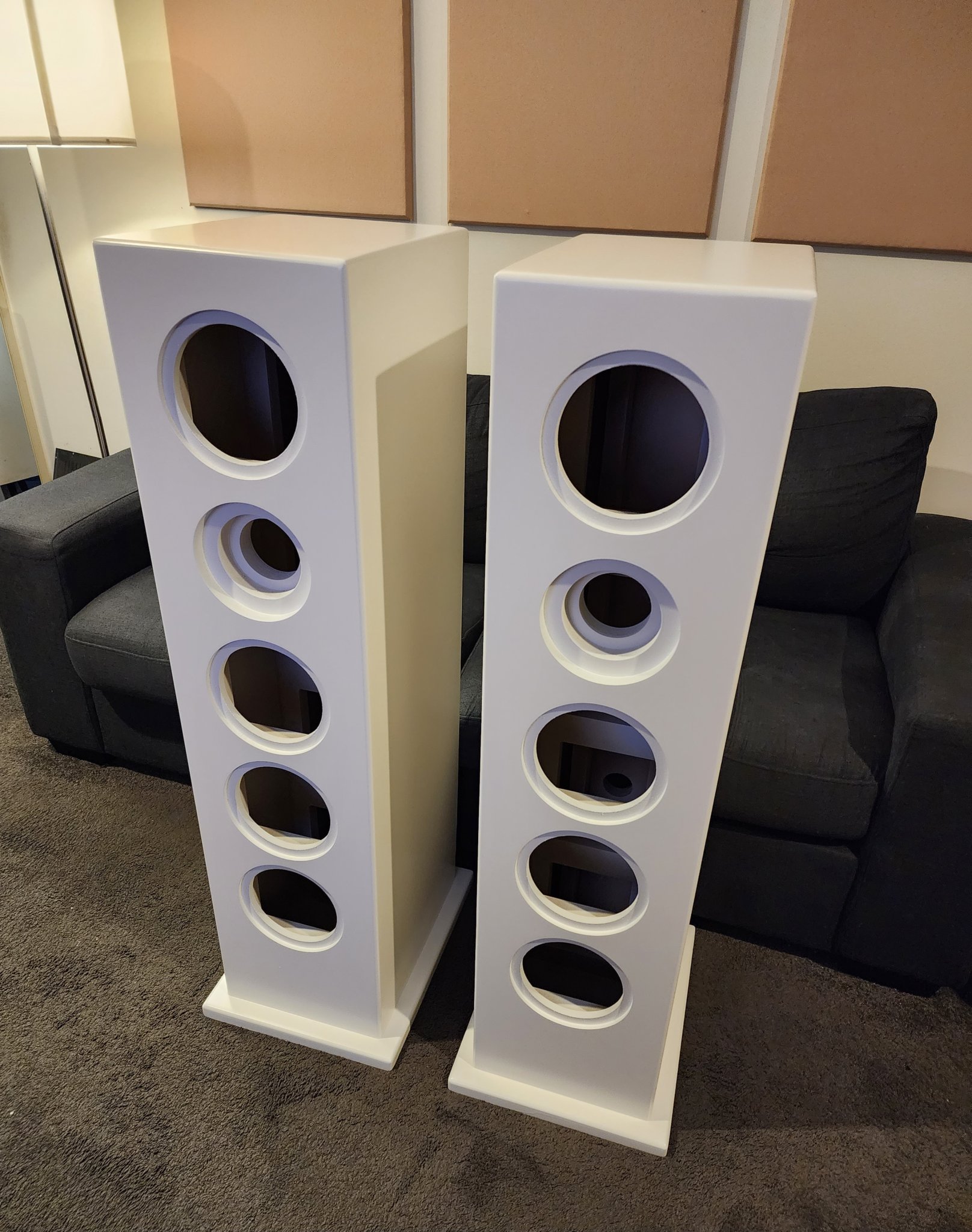

Here are the boxes back from the painter, they are satin finish Dulux Natural White:
Nice cabinets Joe, they look good in whiite - MDF or Ply for these?
Straightforward MDF, exactly as per the website, all 25mm plus the one piece of 18mm that makes the front panel 43mm thick:

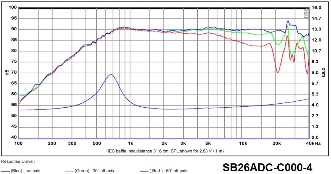

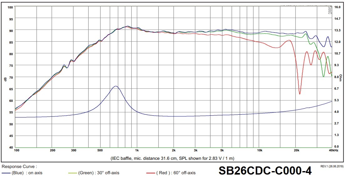

Any particular reason for choosing the SB26CDC and not the SB26ADC which is 1 dB more sensitive?
Is it because the SB26CDC is smoother in the higher frequencies (mainly beyond 20 KHz)?
Are you going to try the same waveguide? The ceramic tweeters' faceplates are different, is it going to work? (let me answer: we'll see!!! 🙂)
Yes, this was something that needed to be sorted out and we have a solution, details to come later. A ring is needed and I can include some with Waveguides.
The choice was not done by me, it's a long story and involves the sponsorship involved.

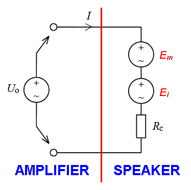

What is the mechanism that triggers current distortion?
The answer is under the Ei symbol and a singular important characteristic of a non-perfect driver. And that Ei is a voltage source that occurs inside the gap of the driver itself and about 30% of the VC length.

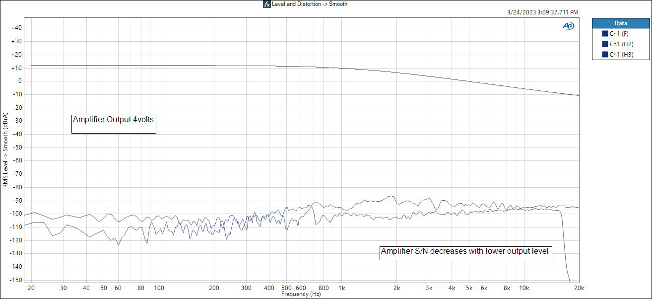

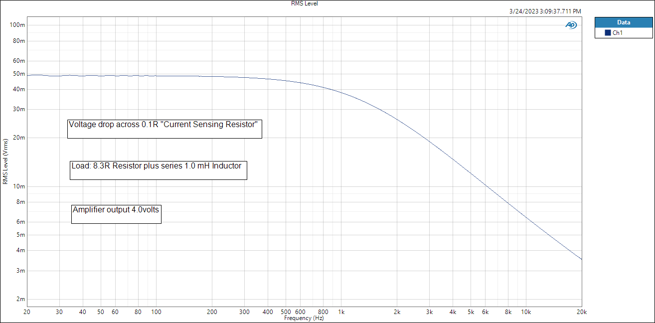

Hello All,
I have been reading this stuff about how Inductance and Back EMF causes current distortion.
So I thought a bit about how to isolate the restive and inductive nature of a driver and measure it. You read the AES papers; in a lab setting the voice coil is blocked to isolate its movement. If you recall the motion of a voice coil is minimal in the Back EMF frequency range of a driver. A blocked voice coil is a good approximation.
On my bench are two Dale NH 250 4R (250 watt) load resistors in series with a Jantzen 1.0mH inductor. The test amplifier with current sensing resistor is an Audio Precision APx1701. Using the APx500 Acoustic response software the test plots show current decreasing with increasing frequency and very low levels of “current distortion”, if any.
There is no distortion to blame on Back EMF or “circulating” voltage feedback.
In this case at least, the amplifier is innocent, very low levels of distortion.
Thanks DT

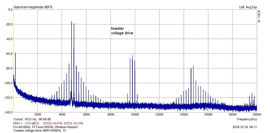

Now apply voltage-drive (low Z):
This is a tweeter, but it could be done with other drivers using multi-tone stimuli.
Now apply current-drive (high Z):
WHOA!
YIKES!
THESE ARE ACOUSTIC MEASUREMENTS WITH A MICROPHONE!
(The above are measurements that you can inspect further and their context, done by Pavel, known as PMA on forums.)
(Three pages, make sure you see all three starting here: http://pmacura.cz/speaker_dist1.htm )

What is the cause?
Back-EMF!
How do you think the back-EMF does to the current of the amplifier?
Can you see the culprit?
Ok, so it follows from what you're saying that this can happen when phase angle is zero.Be absolutely sure, this is about distortion,
