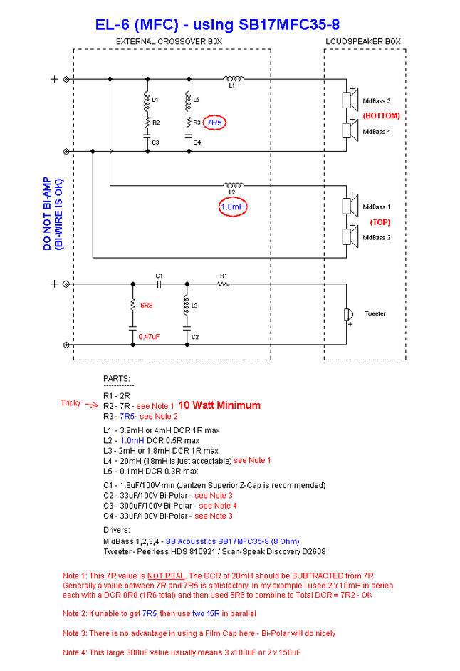

May I ask which is the latest/correct crossover for the MFC-version?
I became uncertain when comparing forum posts to webpage:

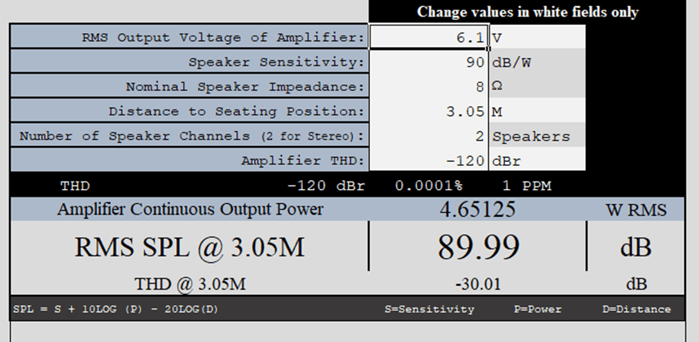

Hi WeBuild4Life,
You have asked an interesting question in post 5282 which is hard to answer.

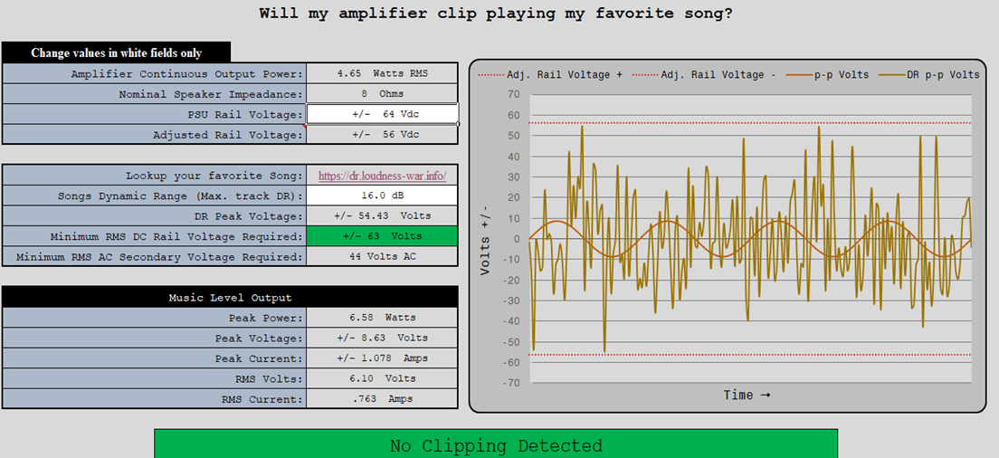

I was curious, so I used one of our “Wolverine Amp Spreadsheets” to check for amplifier clipping into this speaker. I assumed the following, 90dB/1W/1m, approximately 8 ohms for the speaker and the listening position is 3.05m. The dynamic range for music that I entered is an arbitrary figure of 16dB. (For more info see https://dr.loudness-war.info/). Some of the recordings that I have are 18 - 20dB.
With the two speakers at the listening position of 3.05m, you will get 85dB at 1.5 Watts RMS. However your amp needs to have at least 38 Volts dc per rail. Anything lower (for a dynamic range of 16dB) and it will clip.
Let’s try for 90dB at the listening position without clipping. You will need 4.65 Watts RMS and the rail voltage needs to be at least 63 Volts dc, for a dynamic range of 16dB. This is roughly a 200 Watt amp into 8 ohms! Food for thought.
Off topic - the above are approximates and do not take into account the SOA area of the output transistors etc. We use a separate spreadsheet for that (also developed by Jeremy).
NB. I use a 25Watt Class A amp in my bedroom with 88dB speakers without any "perceivable" problems but I listen to it at low volume. In my main system I use much larger amps. Hope the above info helps.

Harry, your math would indicate that we are clipping our amps fairly often. I'm not saying that I disagree with your math. However, I'm kind of wondering how significant this potential clipping is. There are tons of 10 through 50 watt amplifiers powering lots of very expensive speakers out in the field with reports of audible clipping not being a common thing. Same with speaker damage. I don't really hear of tweeters going out very often. At least not in the Elsinore's.
The only amp that I can really remember that I got to clip would be a old marantz that was 15 watts. That one also had a problem. Other than that, nothing audible and I've had the same speakers for about 5-6 years now listening consistently just about everyday. Right now I have a 5, 6, 50, 80, 130 and a 200 watt amp. Most class A. The 6 watt is a tube amplifier which I can get to audibly distort a little. However, I have not gotten that five watt amplifier, (ACA Mini) to clip audibly.
I am gradually getting the website up to scratch and it has been a long time, so apologies for that.
LINK: The 'Elsinore' Loudspeaker Project - © Joe Rasmussen 2006-23
All three different Crossovers are now posted on the front page of Elsinore on the website:
I will post the "MFC" here again.
