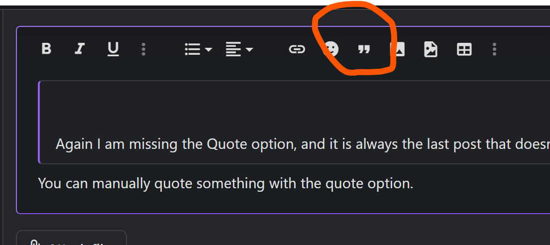

Again I am missing the Quote option, and it is always the last post that doesn't have it. I am hoping a Moderator can help me out with it, so annoying.
You can manually quote something with the quote option.
You can even do multiples in one message. you just have to copy paist what you want.

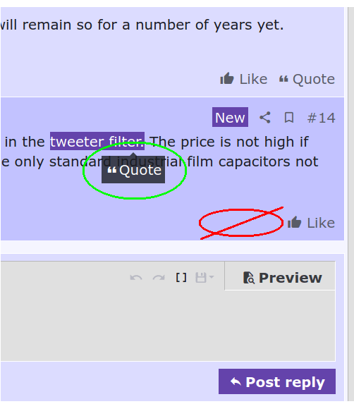

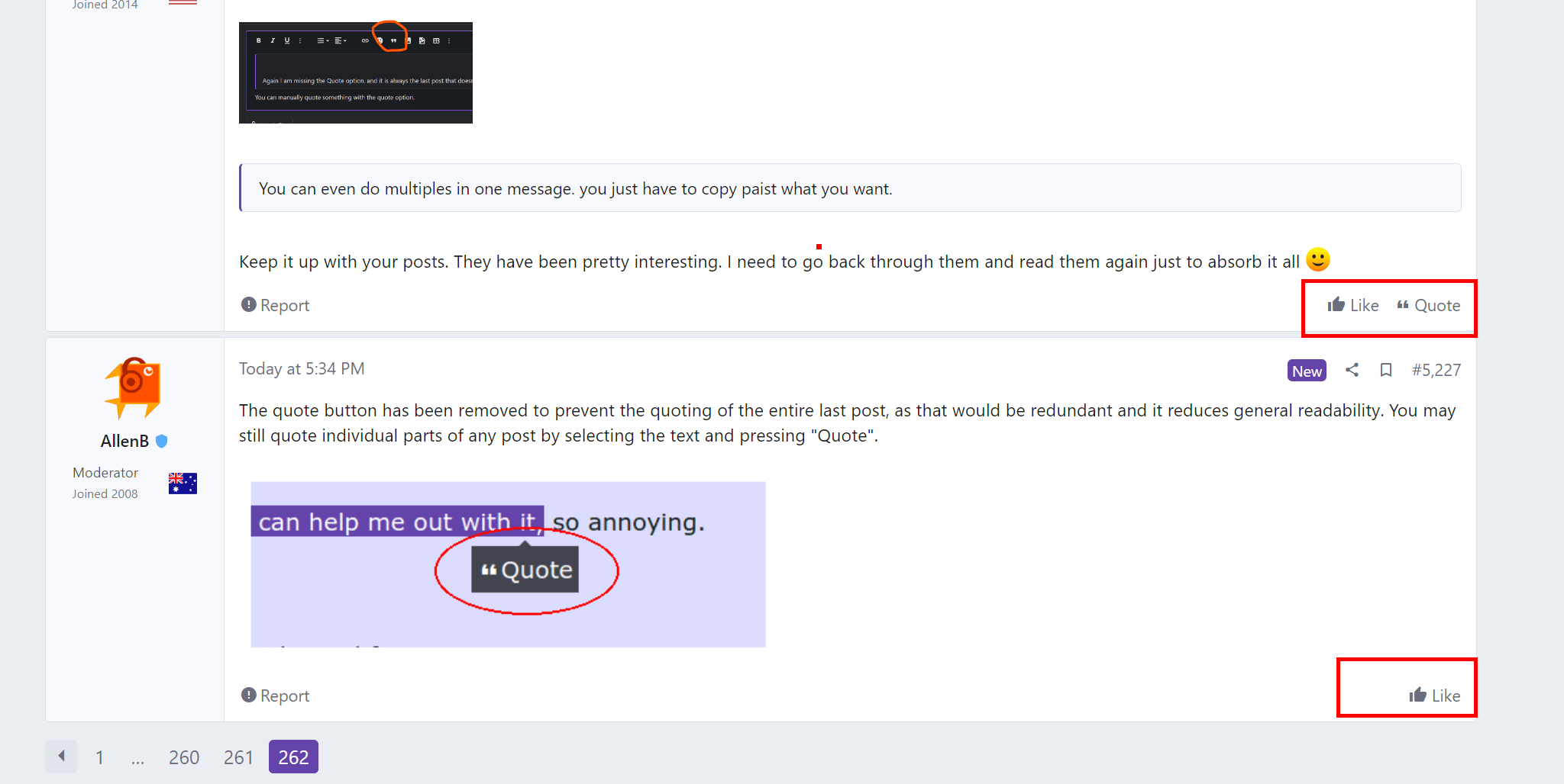

Hi Allan, look close below as a screen capture shows the problem.
OK, look closely below, how the second last post has the Quote option and that works.
But the last post, it is simply missing.
So Alan, since yours is the last post, I only get the
and not
If somebody then posts next, yours will magically become OK because you are not the last post. But the one after, which now becomes the last post, that post is now the one with the Quote missing. Really weird.

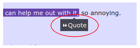

That is the way it is meant it to be. There is a discussion of the feature in the Forum Problems subforum.
Does this image demonstrate the control which you still have over quoting.. selecting text by dragging while holding your mouse button?

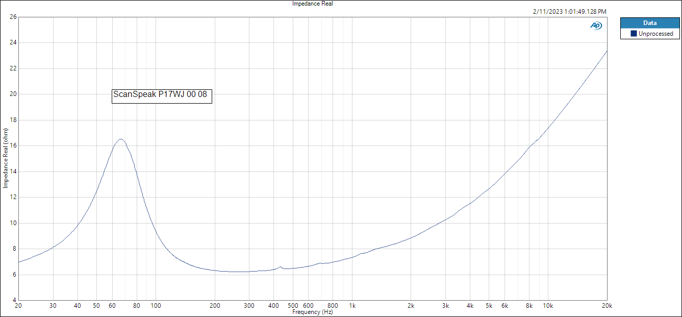

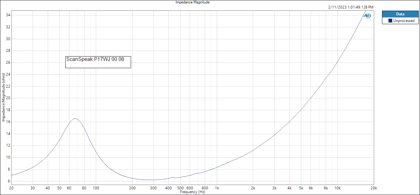

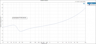

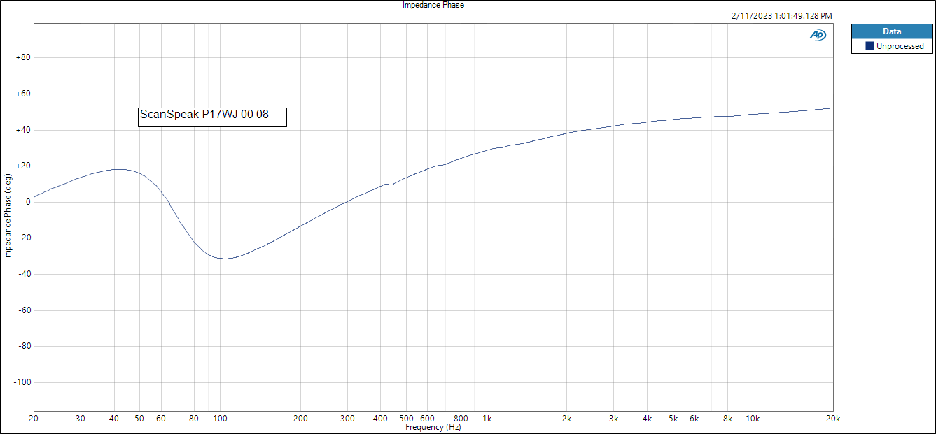

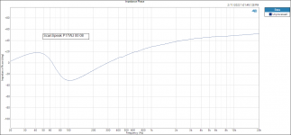

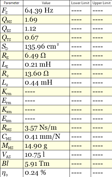

Hello All,

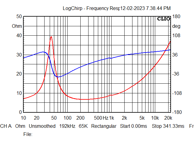

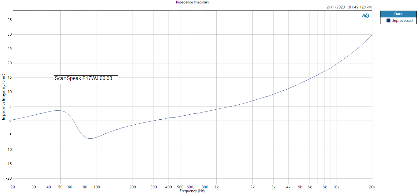

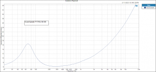

There is a Parts Express 0.55 cubic foot sealed enclosure sitting here Today I removed a Purifi 6.5 inch driver and in its’ place I bolted on a SCANSPEAK P17WJ 00 08 driver, an older Vifa design without some of the new technology, still a good driver. The enclosure is sealed tight and has a couple of fistfuls of polyester stuffing.
See the attached Impedance and parameter measurement plots that were measured with the driver attached to the enclosure, note the speaker parameters are calculated with L2R2 model not the standard TS/P.
I like to measure with 2 volts amplifier output. 2 volts is much closer to listening level.
Thanks DT
ScanSpeak P17WJ 00 08 Impedance Imaginary.PNGScanSpeak P17WJ 00 08 Impedance Magnitude.pngScanSpeak P17WJ 00 08 Impedance Phase.PNGScanSpeak P17WJ 00 08 Impedance Real.PNGScanSpeak P17WJ 00 08 Thiele-Small.PNG
Put my own sample Vifa P17WJ00-08 to the test. Below are free air measurements:
MANUFACTURER Vifa
MODEL P17WJ008
DATE 12-02-2023
Fs 42.9345
Diameter 131.5900
ZMax 39.4298
Re 6.0000
Rms 1.2990
Qms 3.1967
Qes 0.5738
Qts 0.4864
Cms 0.8927
Mms 15.3928
BL 6.5897
VAS 23.0559
dBSPL 87.0475
L1kHz 0.5412mH
L10kHz 0.2863mH
SD 1.36E-02
LCES 38.7652
CMES 354.4750
RES 33.4298
MMD 14.4951
RMT 8.5363
ZMin 6.5992
ZAVG 21.4538
