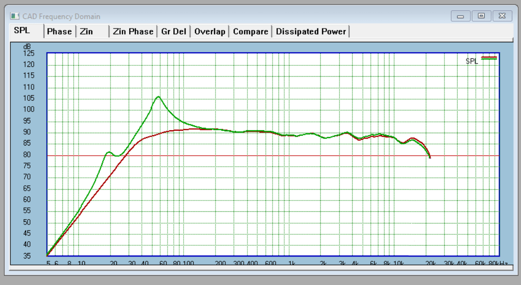

There are reasons for avoiding those steeper slopes and use the right drivers that don't need it.
Also, EQ the current and you can drive resonances without any loss of stamping and it does not matter if you are using current or voltage 'drive' as it works with any source impedance. Look at the Elsinores as that is what they are doing. You can drive them with a current source and not lose any damping.
Make the amplifier produce the same current at ALL frequencies and both LF alignment as well as crossovers get locked IN. No, I am not kidding!

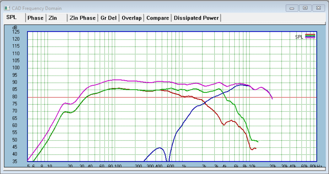

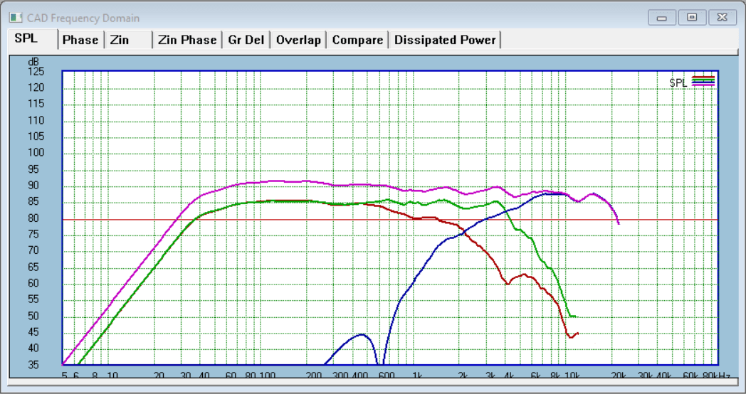

Red is voltage. Green is current. The slight deviation at 20 Hertz is because this is a vented box. If this was a sealed box design, even that would not be there. As it is, above at low frequencies, the power handling will only be slightly less.
Even the crossover does not change:
Voltage first:
Now current:
Try this with conventional design. The above is the Elsinore ULD.

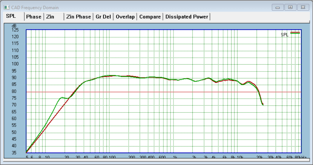

EQ the current flat: The speaker FR is locked in, the bass alignment is almost perfectly locked in, and finally, even the crossovers are locked in.
Here it is below, can you spot which is voltage source or current source?
That is pretty impressive, don't you think? What is the key to making this happen, it is simple:
Make/force the amplifier to produce the same current at ALL frequencies, from zero Hertz and up.

This is 3 Ohm output impedance compared to 0 Ohm:
Can you tell which is which? Note that there is no reduction in damping or otherwise the response would be up in the 80-100 Hertz and it is not.
IMPORTANT: YOU CAN GET GOOD BASS DAMPING WITH A CURRENT SOURCE!
They say you can't, but the above is proof that you can.
Let us compare when we take away the Current EQ below 100 Hertz approx:
Once again, there is a widespread belief that you cannot get good damping by using a current source. But the above proves otherwise. EQ the current and you can use it with any amplifier without loss of damping. BTW, the alignment in the Elsinores is similar to a Bessel and not Butterworth, which means a more damped alignment than Butterworth, and this damping is kept even when using a current source.

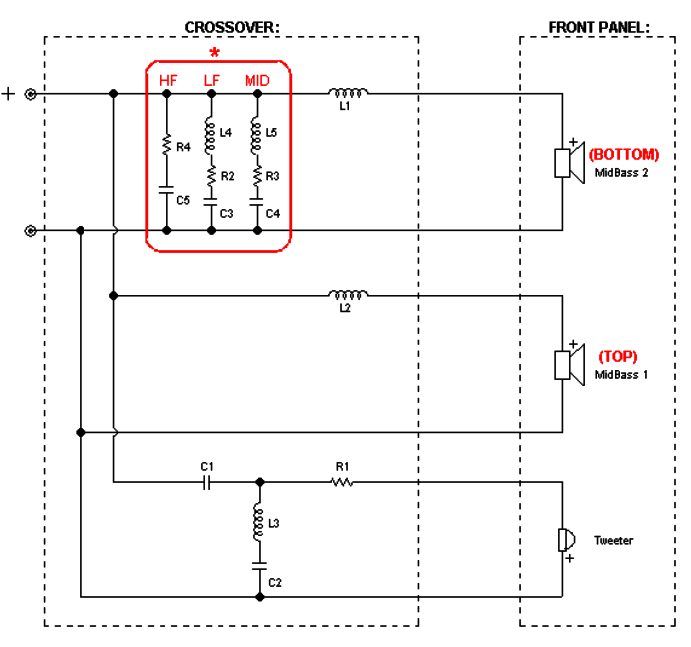

For example, how does current EQ make it possible to use current drive even in the bass? That is if you want to. But I use an amplifier that does not have a low enough output impedance to be a voltage source and is nowhere near high enough to be a current source. But my trans-amp has an output impedance of 270 Ohm. But I don't use it. It is a tool to me.
Crossovers too. Once again, the convention is that they need a voltage source to work and any added series impedance will cause the Crossover to function incorrectly. Yet if you EQ the current of the amplifier, this does not happen.

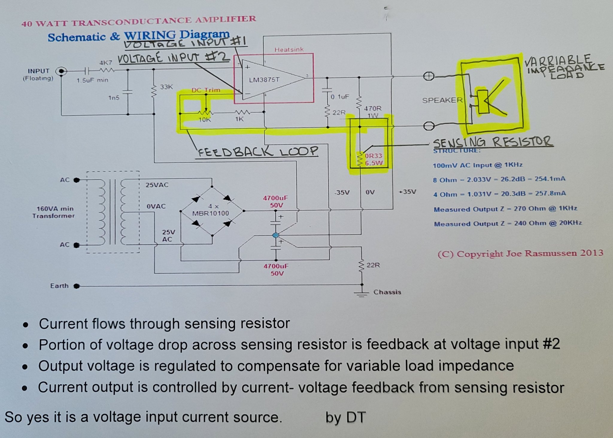

You were the one to bring up the topic and post the amplifier schematic.
What you say about transconductance (current output) amplifiers does not agree with the computer models. https://www.mathworks.com/help/physmod/sps/ref/operationaltransconductanceamplifier.html

Current-Voltage feedback amplifiers (current amplifiers) precisely control output current into a variable impedance load by actively controlling output voltage. This is textbook stuff.
So yes, current amplifiers actively control both output voltage and output current. A voltage controlled current source.

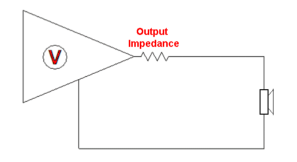

But let us look at it differently, all amplifiers can be modeled as a voltage source and an output impedance, even current sources can be modeled this way:
If the impedance is zero, then the voltage source V has total control. The voltage is fixed by the output and not the input.
If the impedance is infinite, then the voltage source V has no control. over the volage seen by the load. In fact, it is no longer a voltage source at the load terminals, it has become a current source.

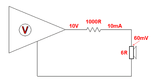

I will give a practical example: Neville Thiele, who started off the whole Thiele-Small parameters here in Sydney, Australia, used a current source to measure the impedance of [bass] drivers, in order to calculate the Fs, Qe, Qm and VAS of drivers.
Study the above carefully. This is the setup that I was told that Thiele used to measure driver parameters. The above uses a fixed 10V output and the 1000R resistor used here, if shortened to ground, would produce a fixed 10mA of current. Hence we have set up a 10mA current source.
We can now measure the impedance of the driver by putting it in series with our 10mA current source and we can now determine the impedance by reading the voltage. We read 60mV and we know it will be 6 Ohm.
The current source is stable, provided that the source impedance to load impedance is very high. Ideally it should be an infinite ratio, but in reality, in the real world, the source impedance will have be high but not infinite. In our case the ratio in the above scenario is 1000R/6R = 166:1 and that was good enough for Thiele.
But the above scenario can help us to measure the motional back-EMF impedance as well. We vary the frequency and finding the highest point and around 30 Ohm is not unsual. The accuracy does dcrease a bit since the ratio is now 33:1 abut still acceptable. We have now found the Fs of the driver. We can also measure the actual DC resistenace of the voice coil, and let us say that it is 6 Ohm DC. Now we also know the motional back-EMF impedance and that will be 30R-6R = 24 Ohm. Total impedance, 24R+6R = 30 Ohm.
It all works that way because that 10mA is a near constant and it stays that way provided the impedance you are trying to measure is many times lower than the source impedance.
But is also demonstrates that a current sources fixes the current and has no control over the voltage. The load does.
Hence the converse must also be true:
That voltage sources fixes the voltage and has no control over current. The load does.

Hello Joe,
We are speaking of an chip amplifier, LM3875T as you show in your amplifier. The LM3875T has 2 voltage inputs. The + input connects to the line level voltage input. The - input connects to voltage feedback loop, the voltage drop across the sensing resistor.
So your amplifier, LM3875T, has 2 voltage inputs one from the line level input, the one that you claim is different and the other voltage input is voltage input from the voltage drop across the current sensing resistor resistor.
So we do have voltage input controlling voltage output that compensates for the variable impedance driver load.
This is a voltage controlled current source.
This is textbook current-voltage feedback that controls a current source.
I have marked up the feedback on your amplifier drawing.
I understand just fine.
Thanks DT
